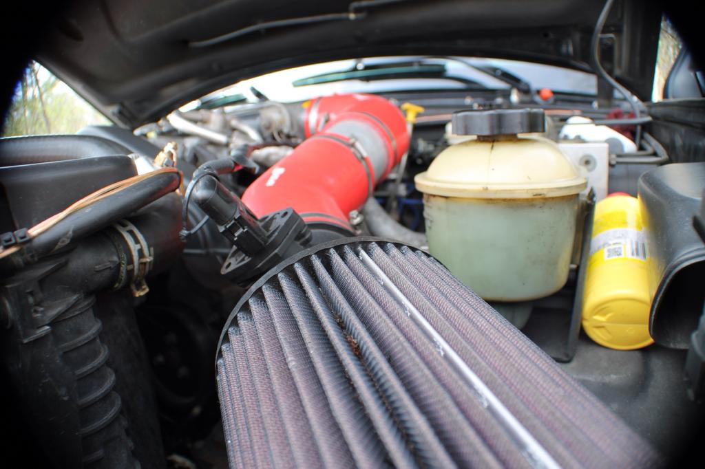

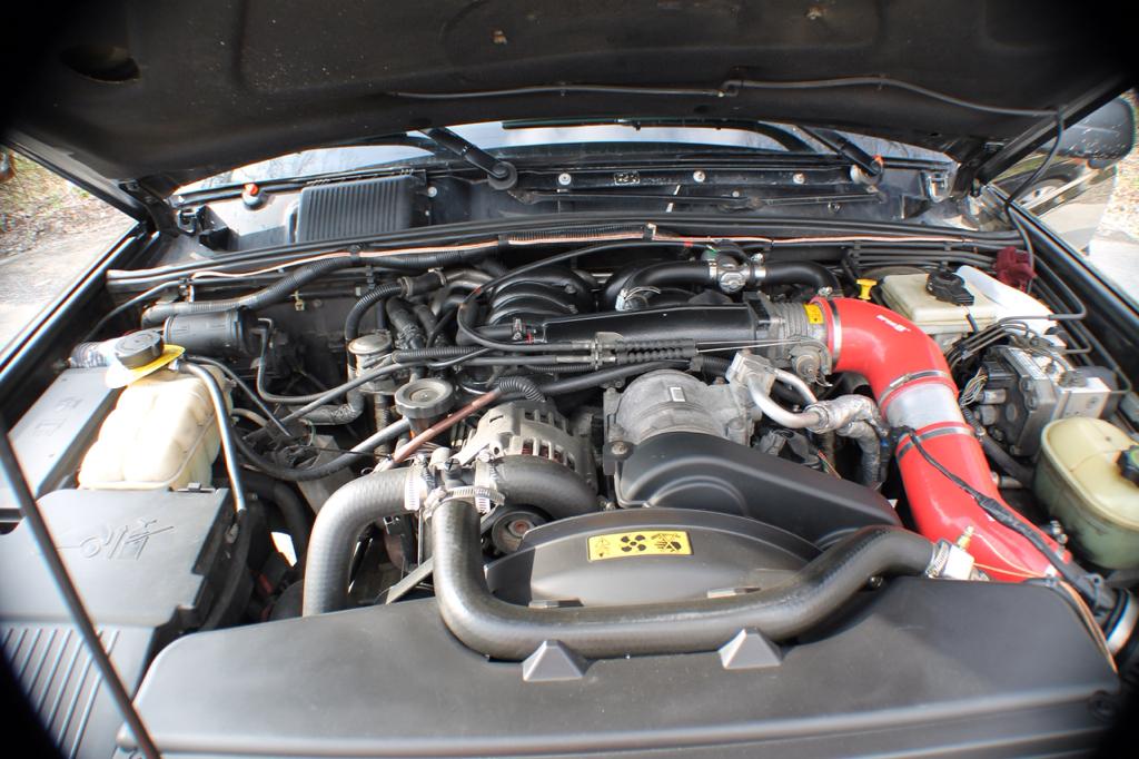

Nice, man! For the spacers, you'll want the long angled ones. I've tried standard straight and they didn't work, I've been meaning to try a set of the angled ones but haven't gotten the chance.
As for the K&N, do the whole intake! I did mine and noticed a definite power improvement immediately. Here's how I did mine.
I just used some aluminum pipe and a couple turbo couplings off of eBay. I tried the pod on stock intake and there was no difference, but the pod plus the intake was definitely noticable.

That intake looks nice.

I would be curious what the new intake temps are. As hot as this engine compartment is, the hot air intake would have an adverse affect.
Also, why not a larger cone air filter?
