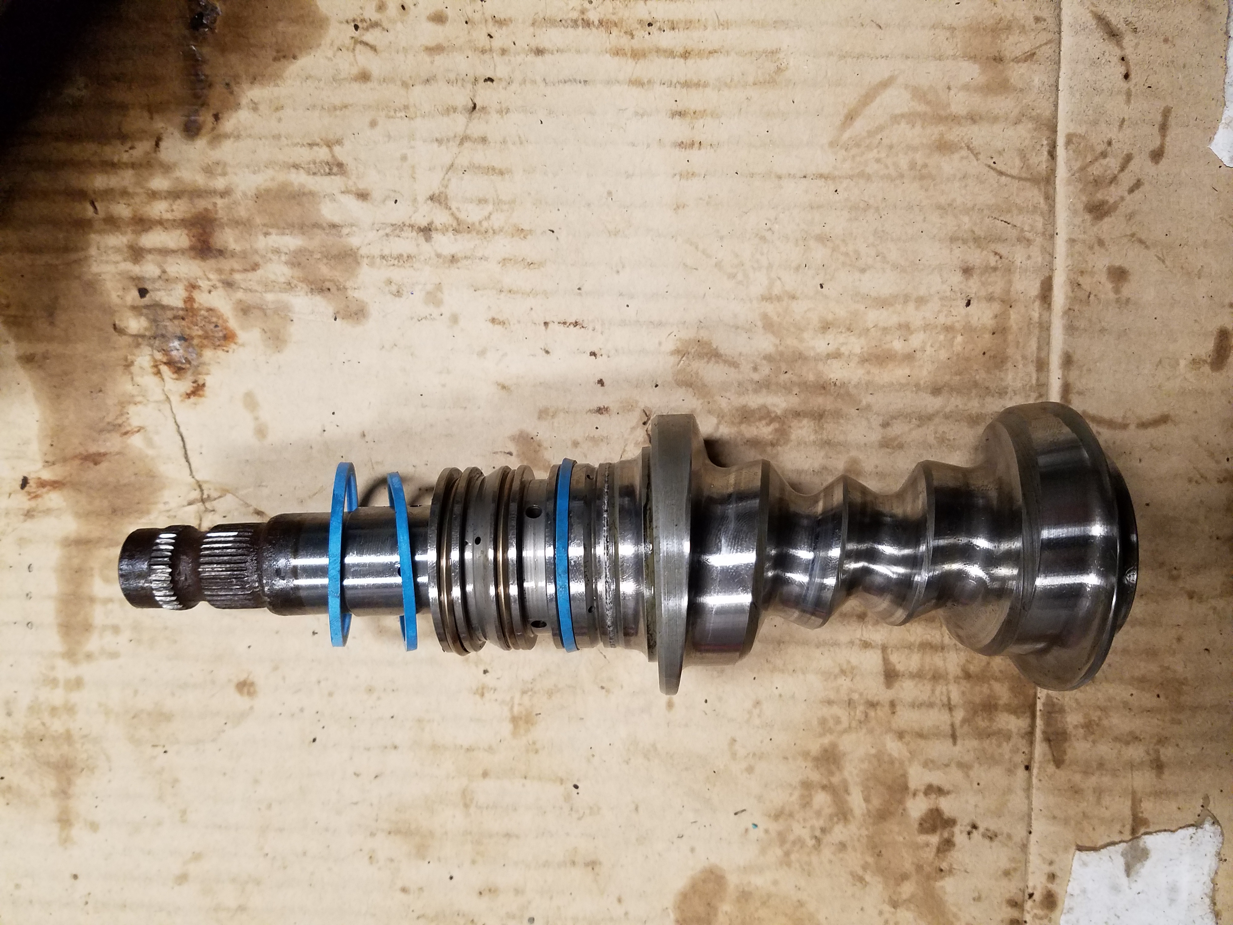

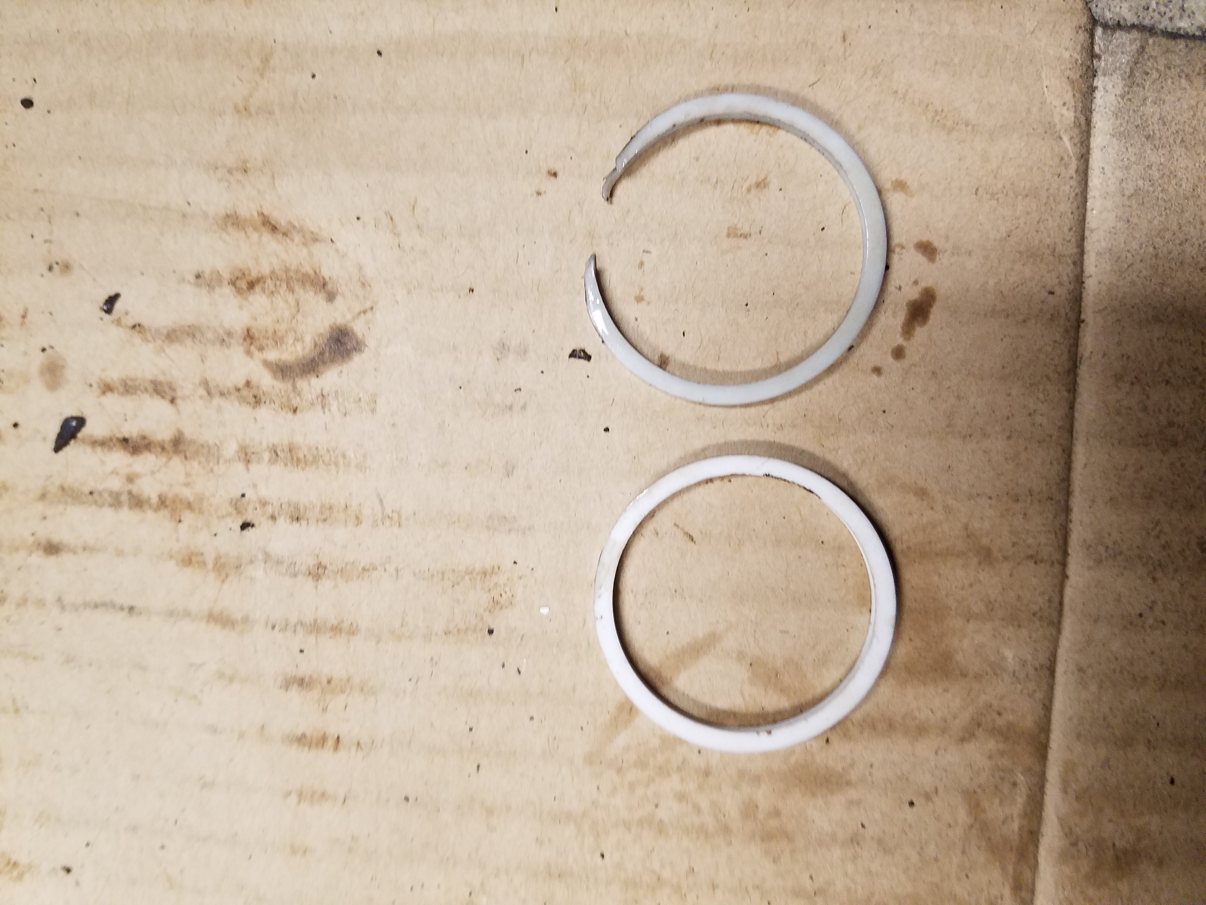

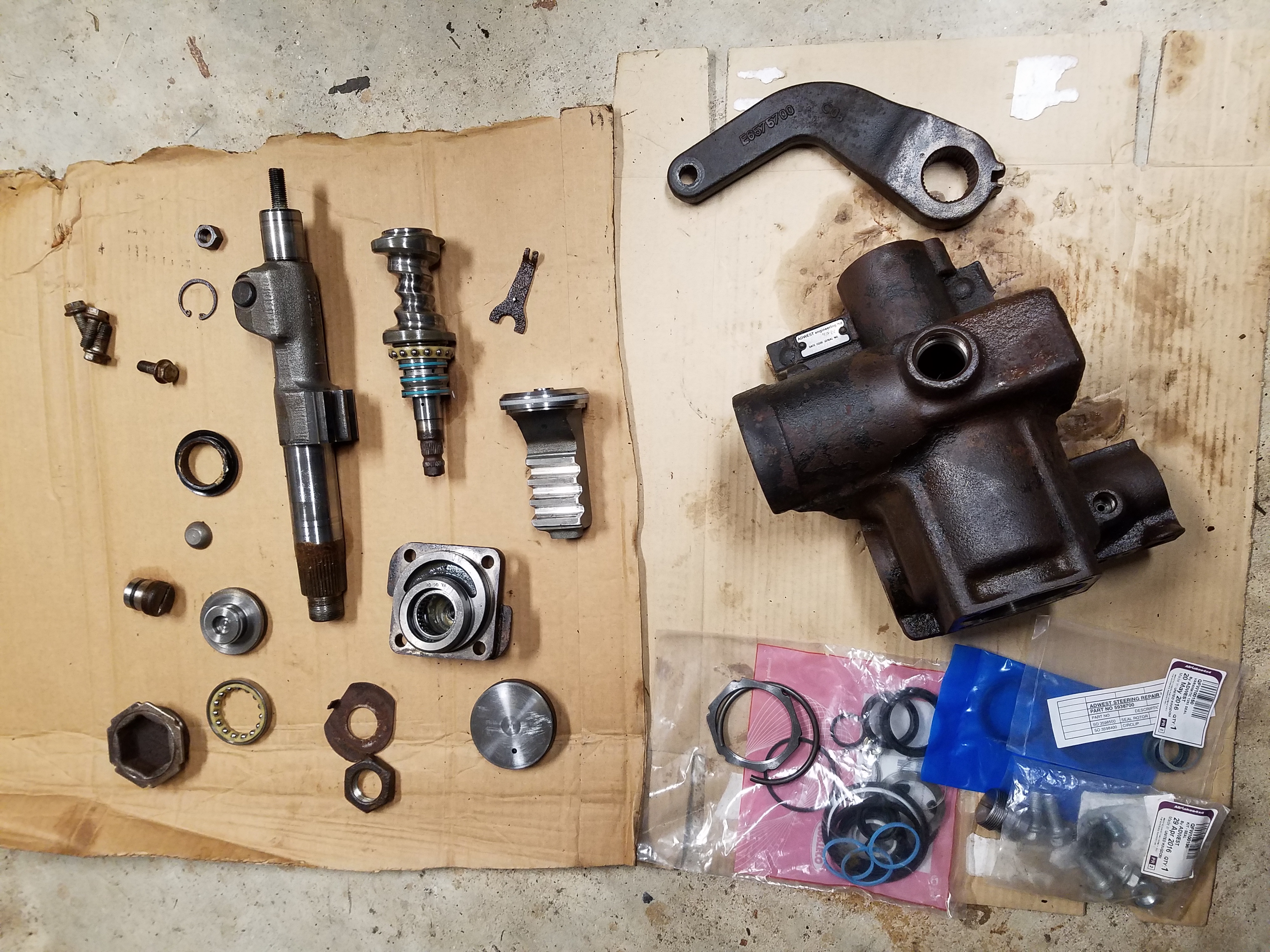

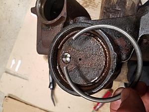

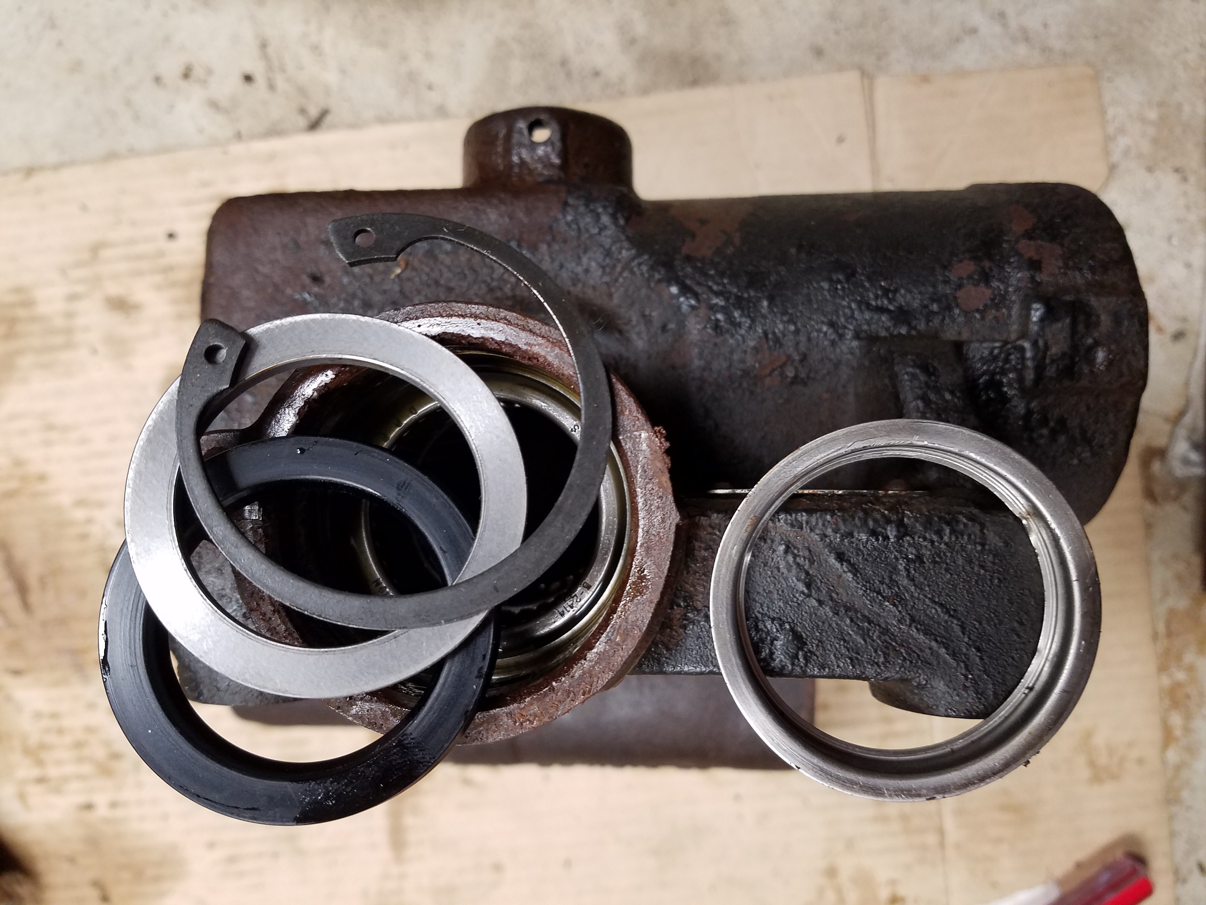

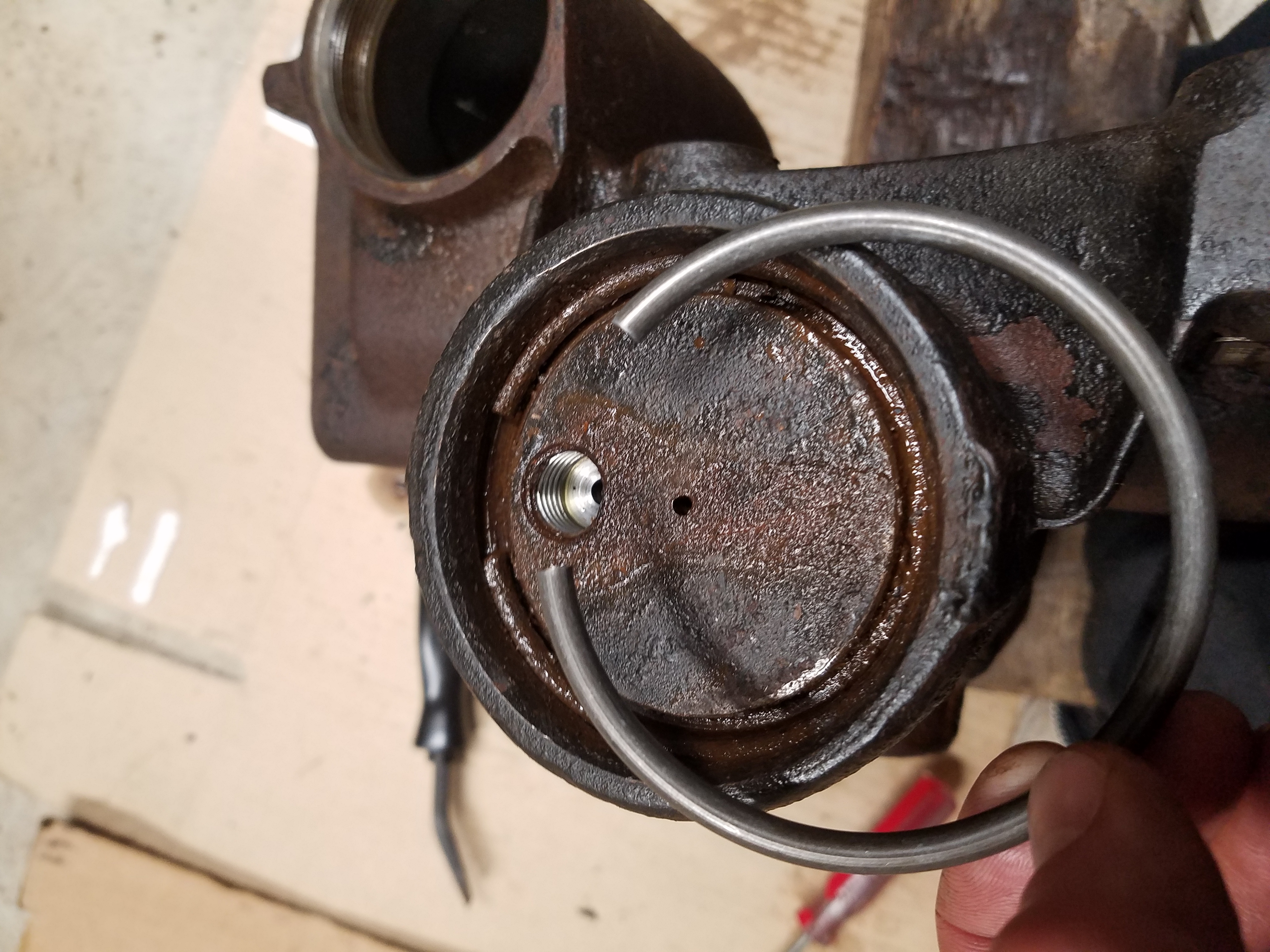

Not as complicated as it looks, but one slip and you're out $$
The 3 blue rings on the worm gear, or the white ring on the rack are most likely the cause of your leak.
