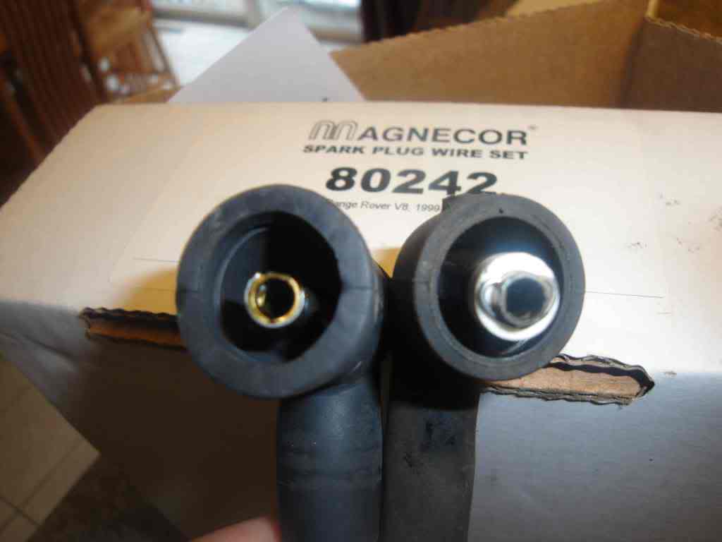

Hello!..Today I am attempting to change the wires/plugs on my '03 Disco today...I have read all the write-ups in the forum....but I was having some trouble getting my first plug wire to stay in the coil pack...so I compared my Magnecor #80242's to the original wires and they seem very different....do I have the wrong wires?....thank you....
Magnecore on the left.....

The factory wire is a little easier to snap on based on its design, I have the Magnacor wires on mine, had then for 7 plus years, and yes, a little harder to snap in but a much better wire.
Take your tine and don't use any Die-Electric gue on the coil end of the wires.
