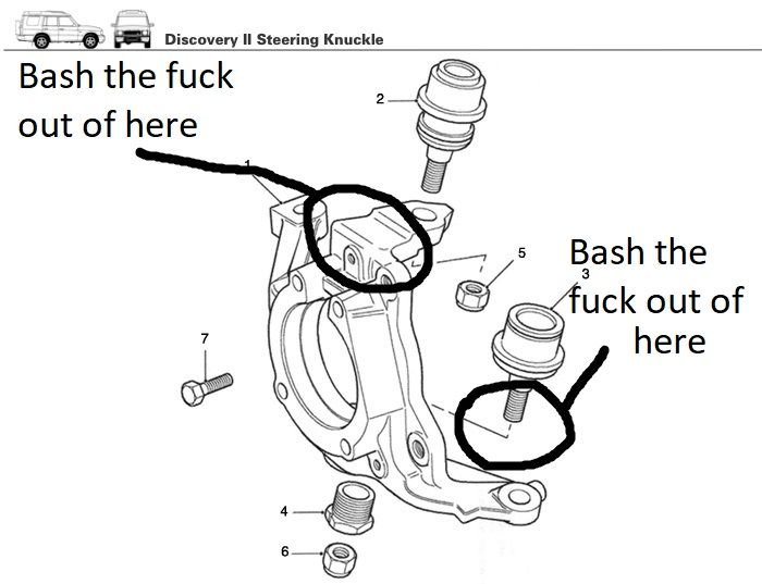

I smash knuckles off with a 5 llb mini sledge. Unless you're 200 lbs + and wailing on it with two hands you're not going to budge it. Also, hit the knuckle where the joint taper goes through it, 3 or 4 on the top and 3 or 4 on the bottom threaded part should do it. You're replacing the ball joints anyway so bash the threaded part up on the bottom one. The knuckles are stupid strong, you wont hurt them.

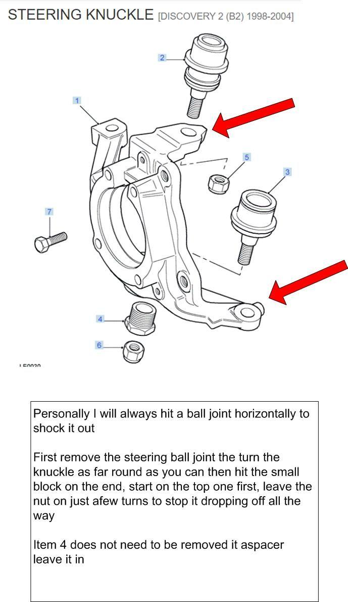

I always do it as shown below, we for the last 50 years or so

Did it!
Thank you all!
just needed the courage to really hit on rovertech’s top spot… and to bring out the 25lbs sledge.
