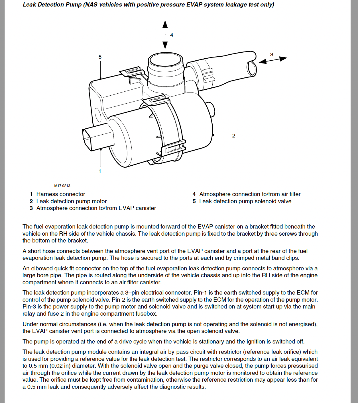

The RAVE manual says P1451 is Lead Detection pump, open circuit. So- electrical issue?
I have good power to the pump when the ignition is on. When it is off, I have just 1.2v, not sure if that is what it should be.
Here is where I am confused. The manual says
"The pump is operated at the end of a drive cycle when the vehicle is stationary and the ignition is switched off."
BUT, it doesn't have much power when the ignition is off. Its powered by fuse 2 in the engine compartment, which is controlled by the main relay.

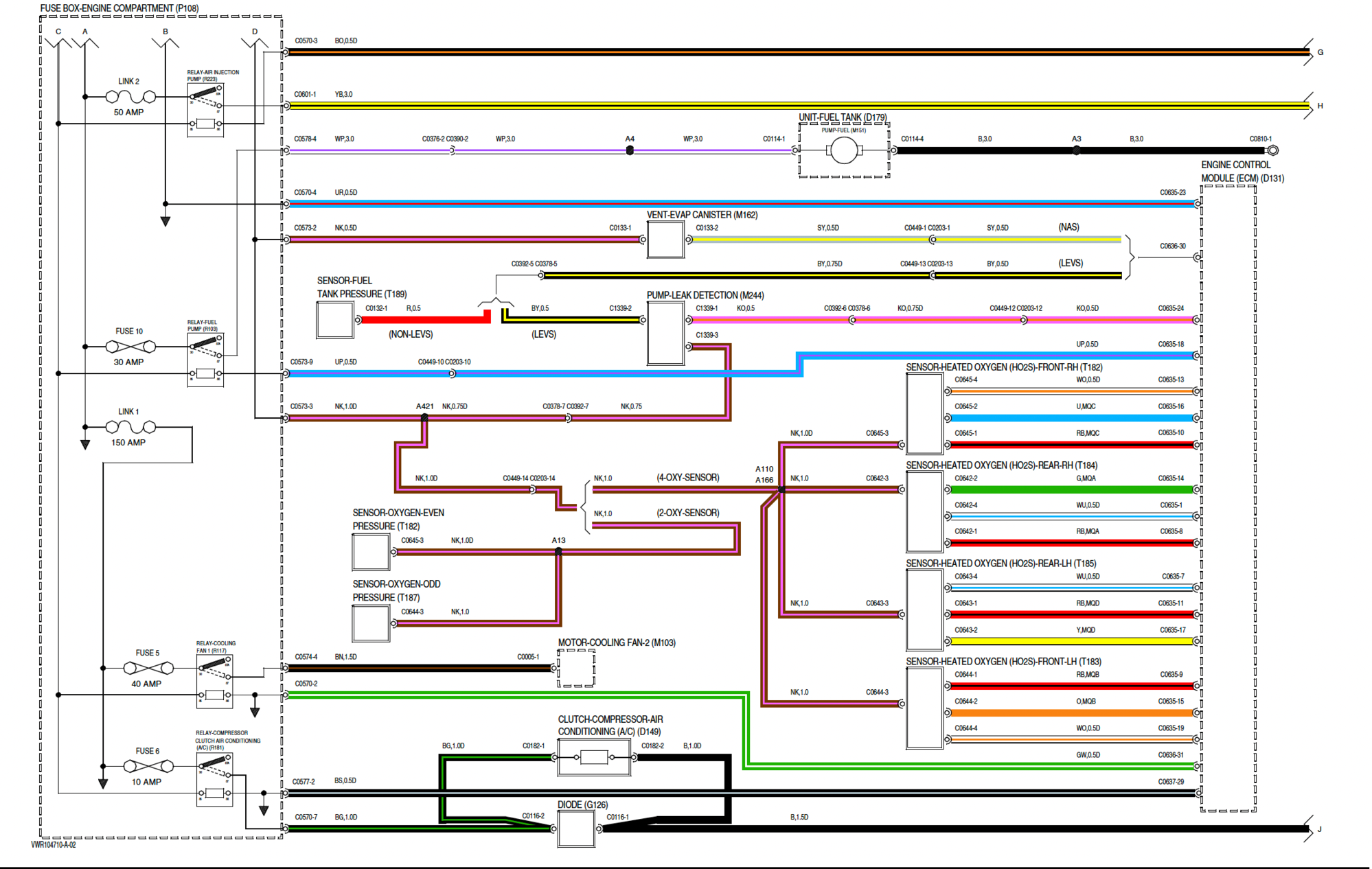

Excellent job on posting the screenshots from the Rave to help us troubleshoot. So first thing to know is that 99-02 is different than 03-04, so lets make sure you are using the right manual for your truck.
Did you try bench testing the solenoid valve and pump? Of course you can ohm out the wiring to the pump and solenoid. Then the other thing to do is to jumper the wires at the ECU to see if you can make it run.

Thanks for the reply. The manual I have says "Discovery Series II WORKSHOP MANUAL - 1999MY ON" The wiring diagram is from 2003, I couldn't find any others, but the colors seem to match up other than the fact my Lead Detection Pump has 4 terminals instead of 3 (12v, pump, solenoid, heater). I did bench test the pump and heard the pump come on. Great idea on connecting right to the ECU. That will be my next test!

After a few more dead ends, I decided to check the wiring from the leak detection pump all the way to the ECU. Previously I’d only checked it for the pump to the wiring connector next to the fuse box.
Low and behold, the two wires I needed were not there. It appears that at some point, the wiring harness that goes through the firewall had been replaced, and they used the version made for use with the vacuum evap system rather than the positive pressure design I have. I finished the run of those two wires, and it works! No codes.
One note: I was getting the code P0447, which as I previously mentioned is listed as the Canister Vent Solenoid (CVS) in the manual. If you have the positive pressure system with the leak detection pump, you don’t have the CVS in the engine bay. I’ve learned that in that case, that code relates to the solenoid in the leak detection pump. It’s logical, but I was sure confused about that bit for a while.
