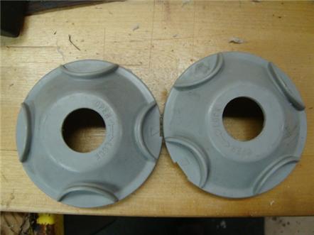

3. Place both headlights on a blanket on a workbench or in a safe place they cannot fall on the floor. Remove the gray circle back for the low beam. (The low beam is the largest circle in the front of the light)

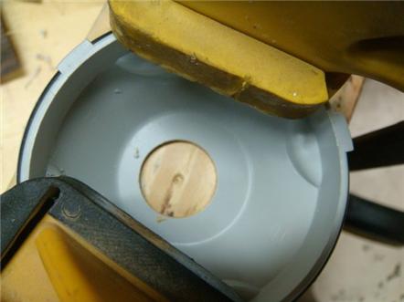

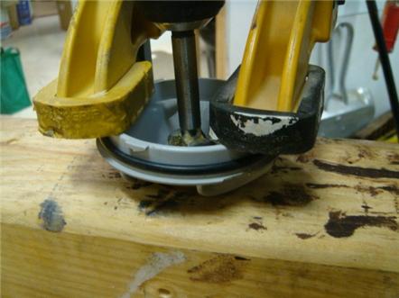

4. Next your need a drill and a Forstner or paddle bit to drill a 7\8" hole in the cap. The wiring harness for the HID bulb goes through this hole. The kit comes with a rubber water resistant grommet this fits nicely in the cap.
5. If you have 2 wood clamps and scrap piece of wood this method works best to drill the hole in the caps. See picture below.
This was the most difficult part of the install. Now to connect plug & play wires.

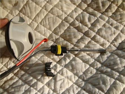

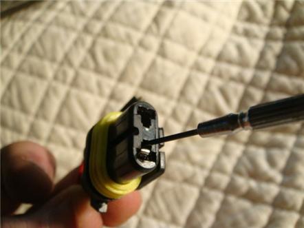

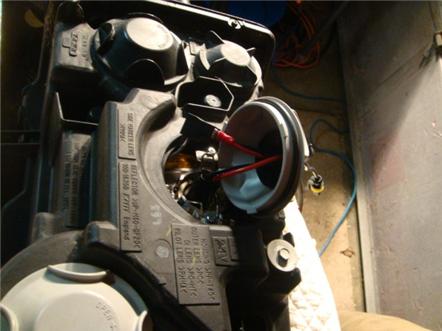

6. Next you will need a set of eyeglass screw drivers. Take the plug that plugs into the inightor ballast, as shown below. The clip must be removed so it can thread threw the 7/8" hole you just drilled in the headlight cap.
7. Press toward the outside of the plug to push in the retaining clip. The wire will pull out from the back. Do the same for both the red & black wire.
8. Now run the wires through the cap with the HID light tip facing opposite of the cap.
9. Now reassemble the plug clip you just took apart, insert the HID bulb in the headlight with its correct orientation. Take care not to touch the HID bulb with your fingers similar to how would avoid touching a halogen bulb. There is only one correct way the bulb can go in. Match up the keyed orientation. Plug the flat connector plugs (black & red) wires into the original H7 bulb socket. You may need to tuck the black connector down into the headlight assembly to get the cap to fit on well. Then let out the slack in the wires through the grommet. Next, position the headlight back in front of the Rover. Feed the wires through back of the headlight opening to connect them to the ballast.

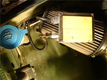

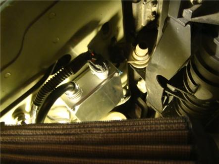

10. Connect up the wires to the ballast. Use your best judgment on where to install the ballast. I chose an open area next to the radiator. The kit includes a bracket & double sided tape. I chose the double sided tape for a quicker install.
11. Since the ballast is essentially a transformer, I know it can get hot. I chose this spot as there was plenty of air flow from the engine fan and my lower plastic engine/rock shield is removed. I will need to add a second ballast near this one for the fog lights. I may end up stacking them with a piece of heat shield in between. After driving around for a day. The ballasts are barely warm to touch, so I think stacking them would be fine.

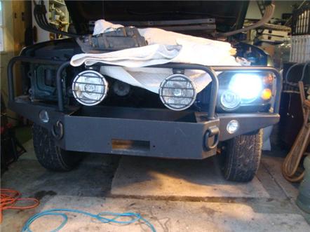

Testing 1...2...3... the the drivers side. Works!

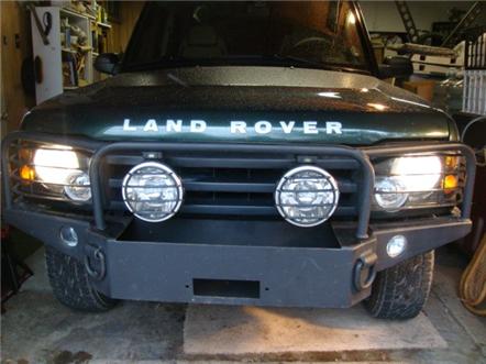

This is the look before HID upgrade These are Sylvania Ultra H7 bulbs

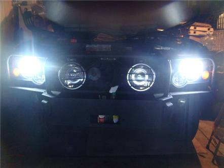

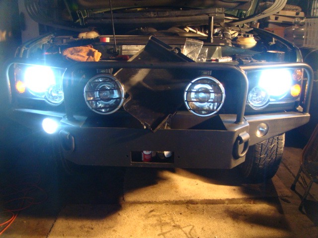

HIDs 5000k temp installed. Now for some night driving any adjustment if needed
Testing the 1st fog light.
