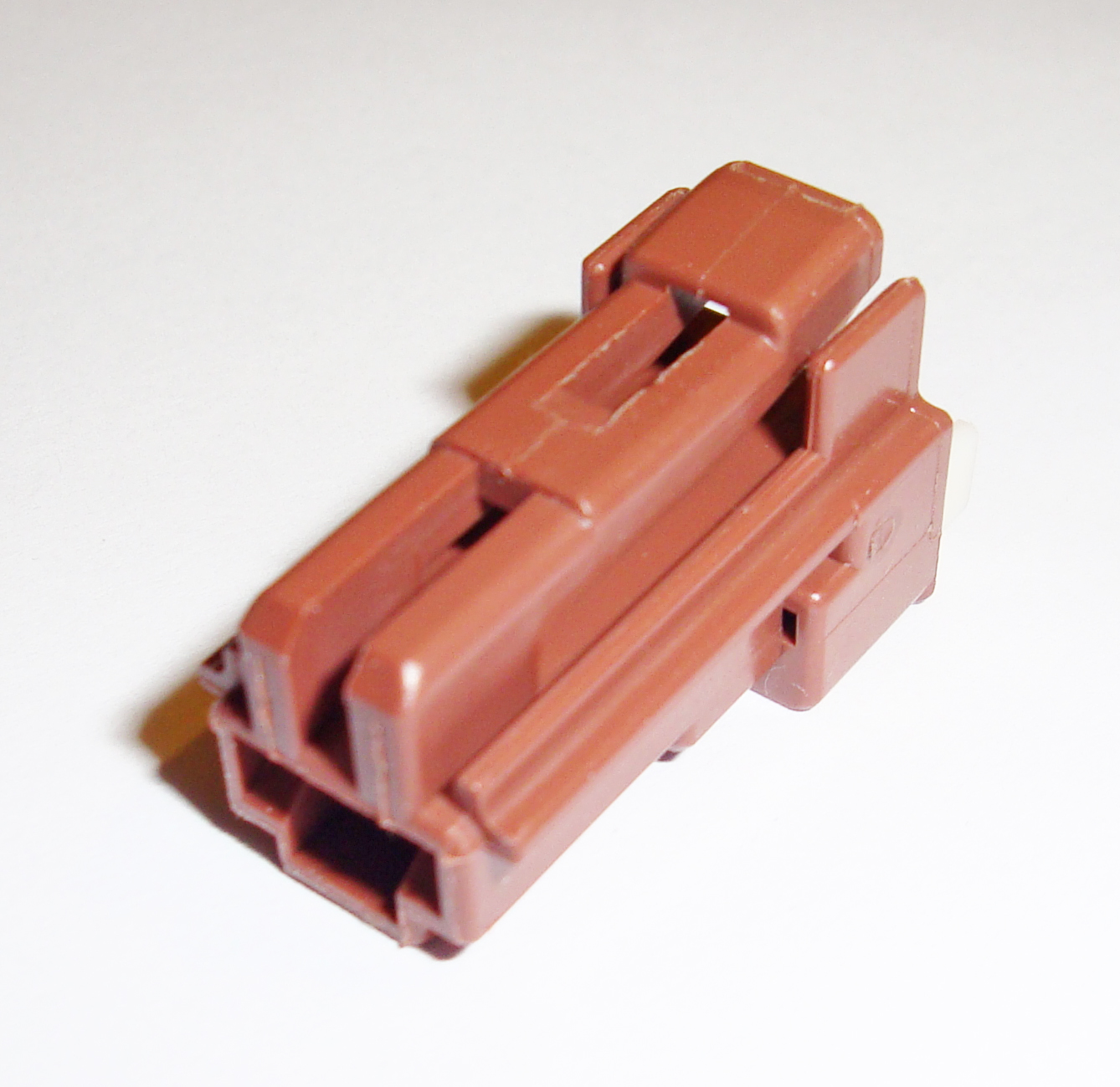

S12 socket -
S12 connector -
S13 socket -
S13 connector -
