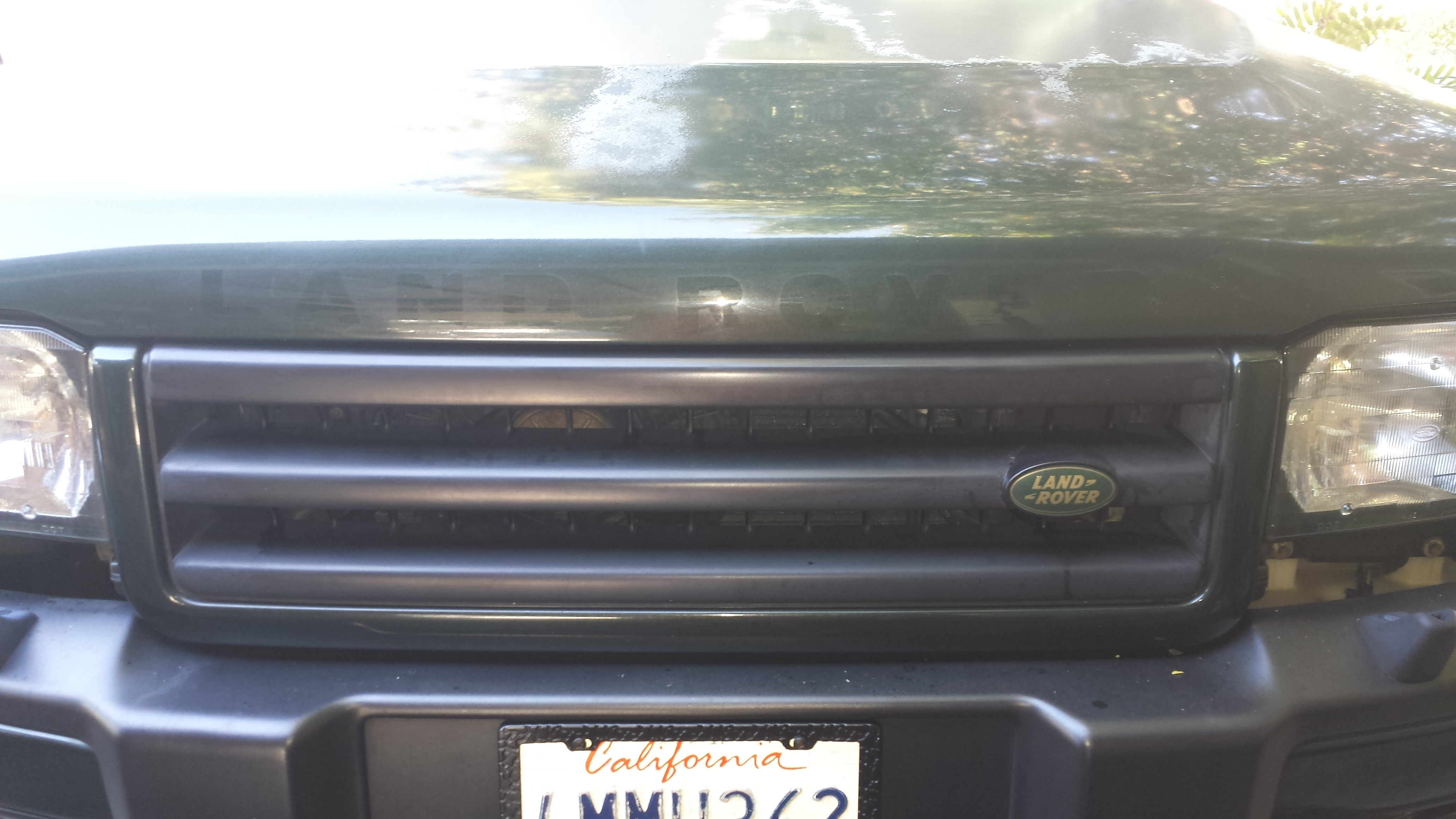

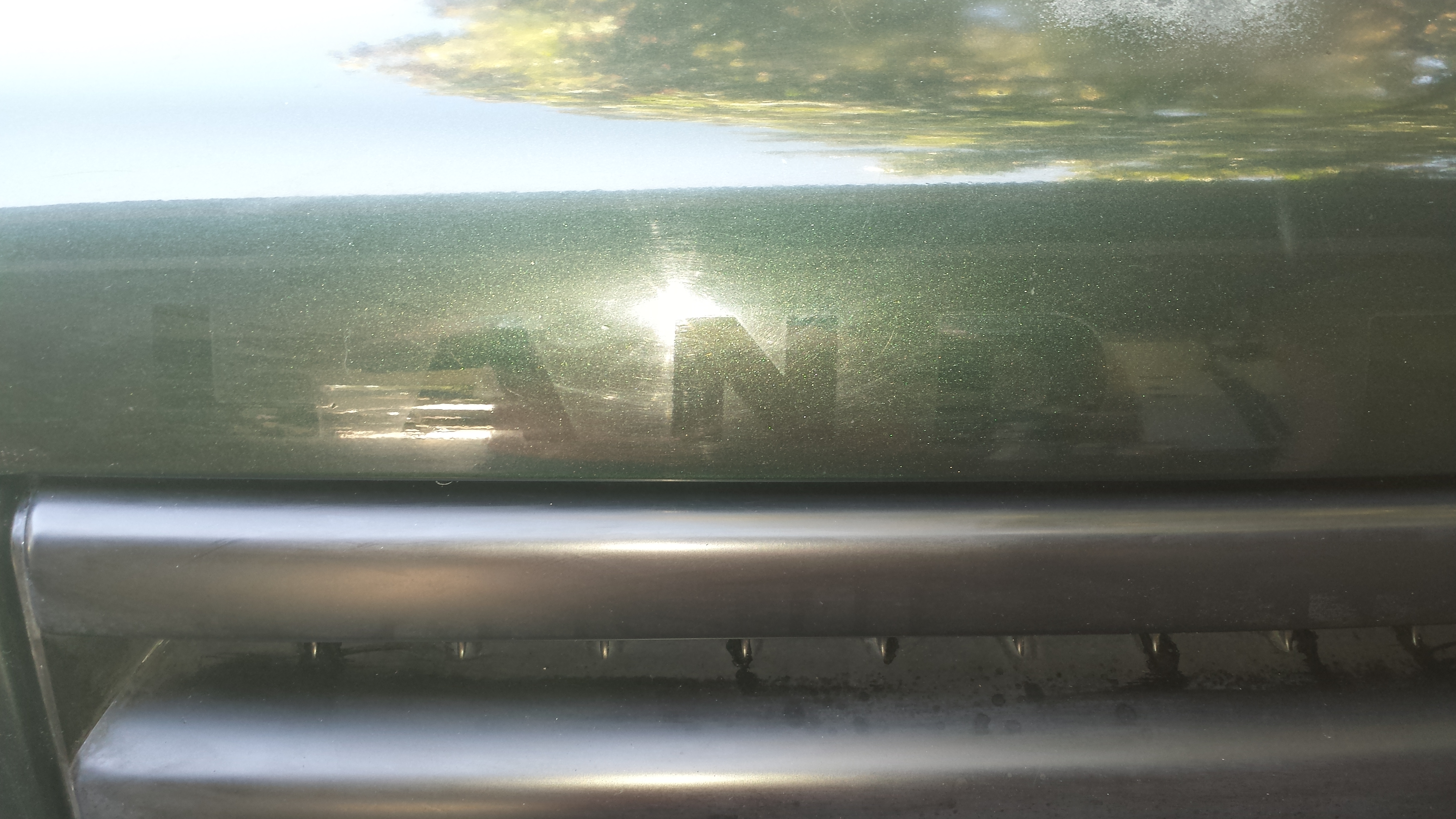

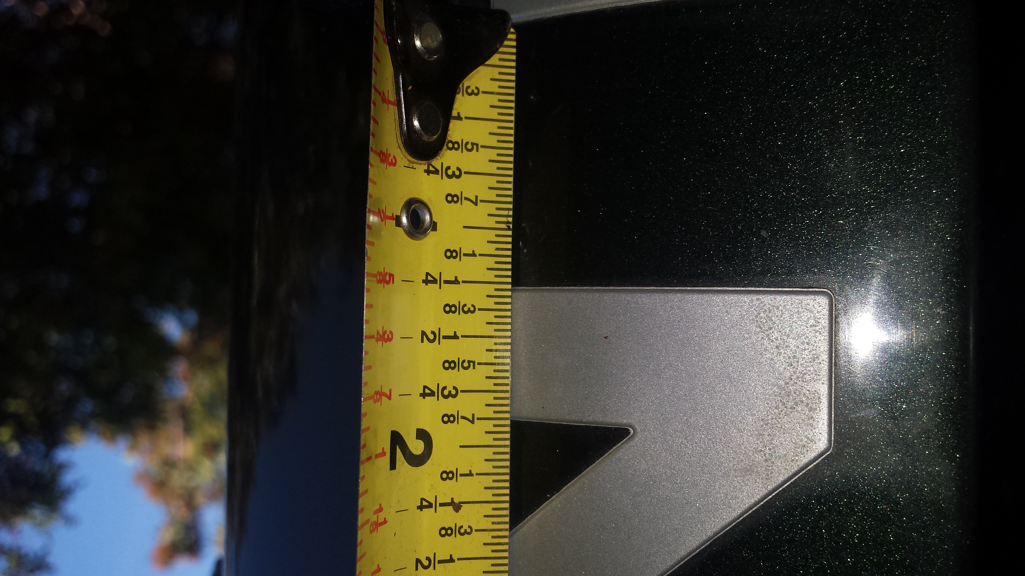

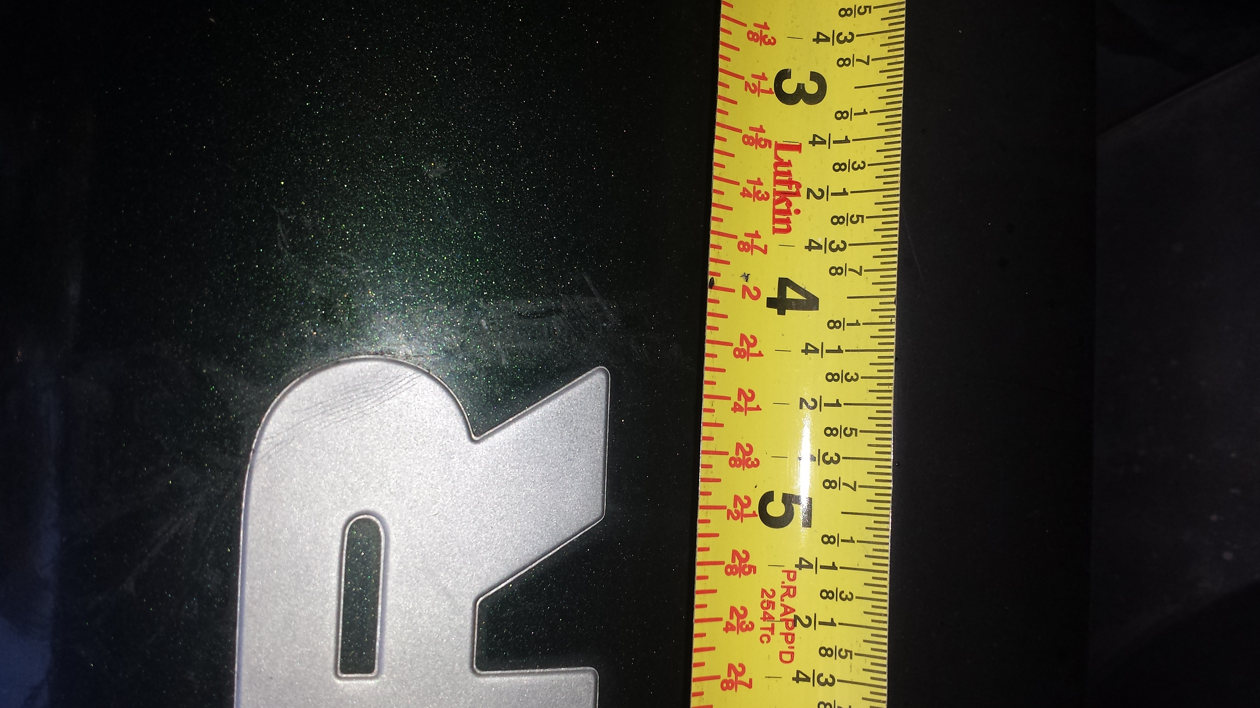

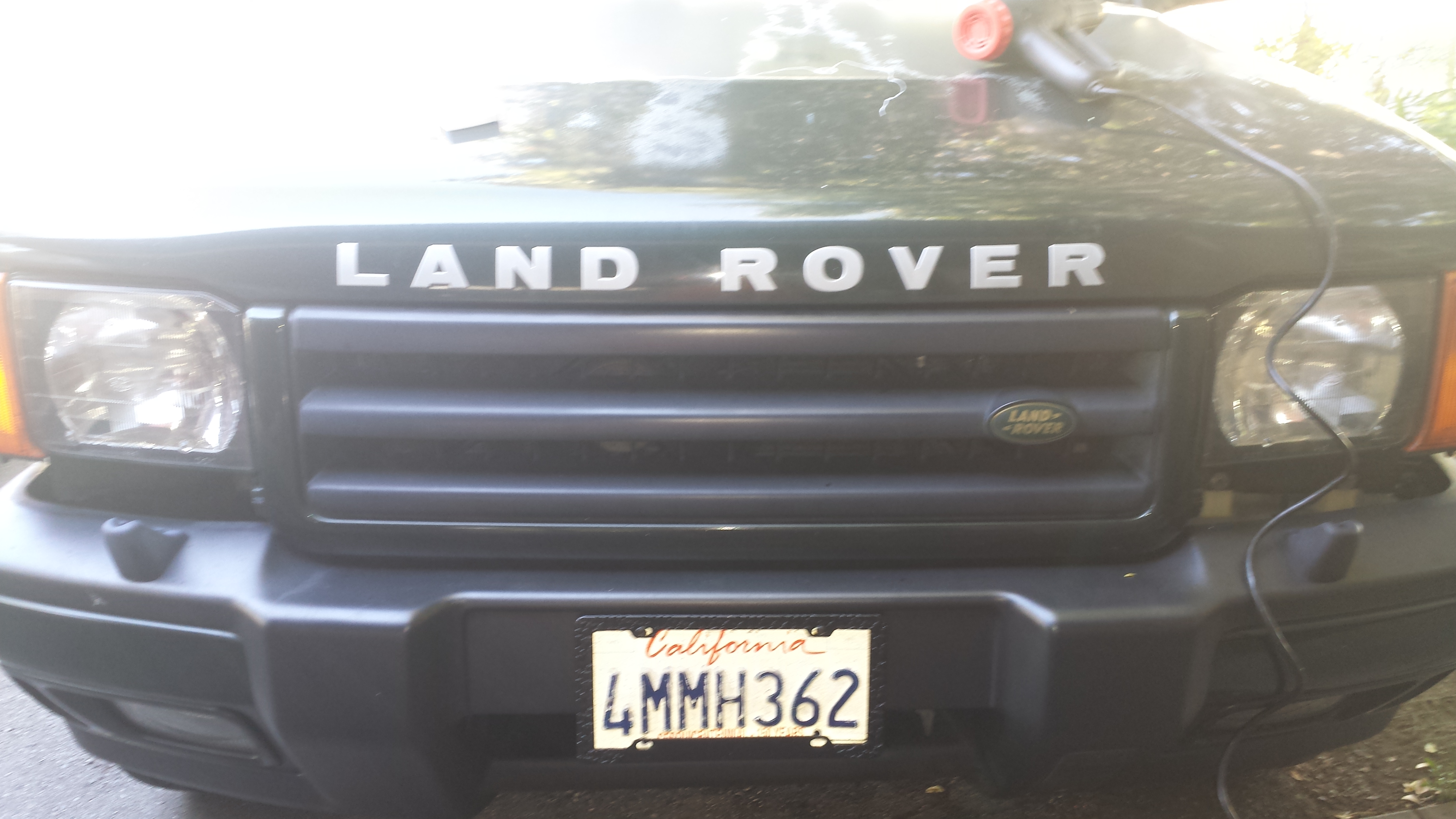

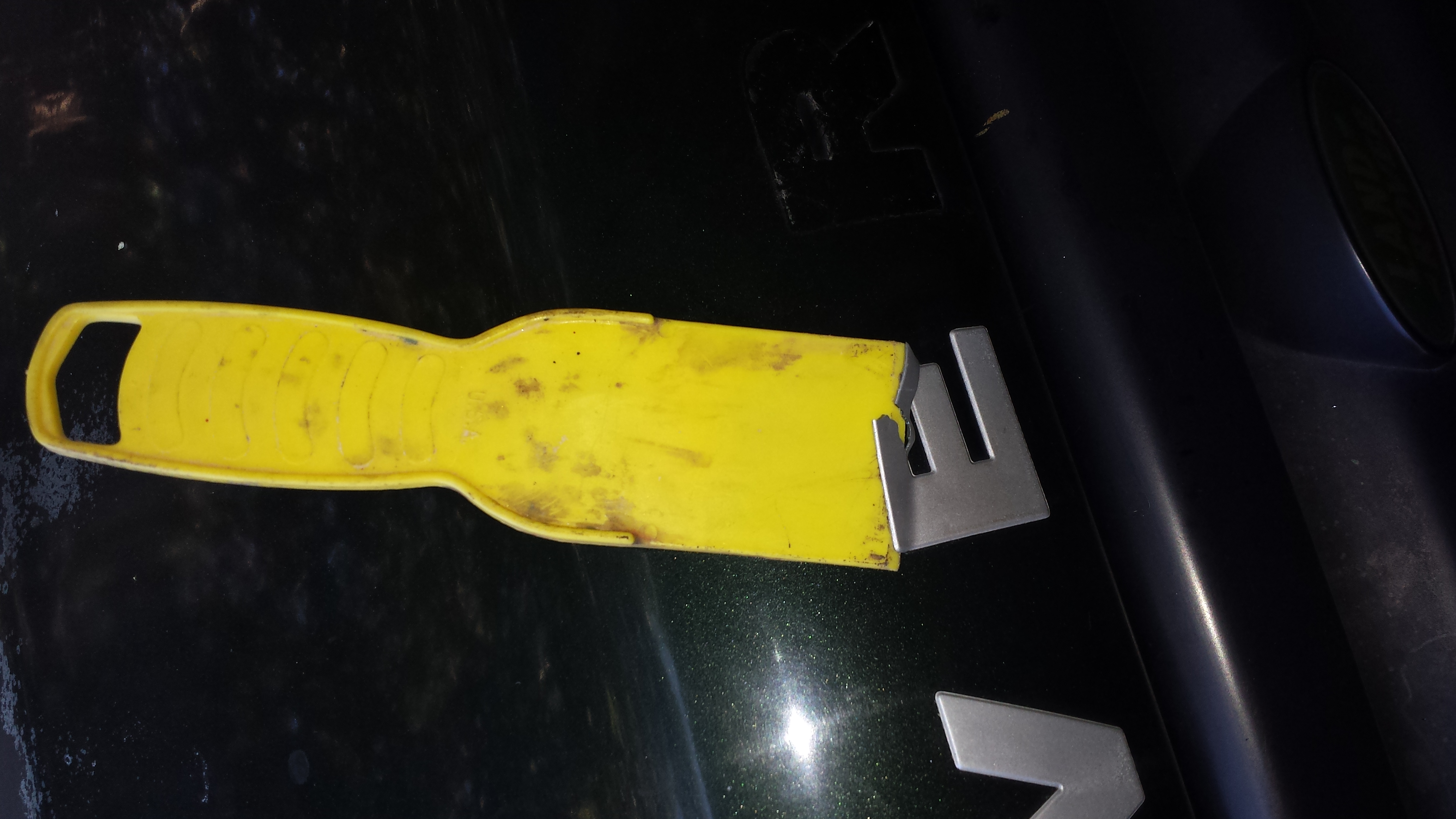

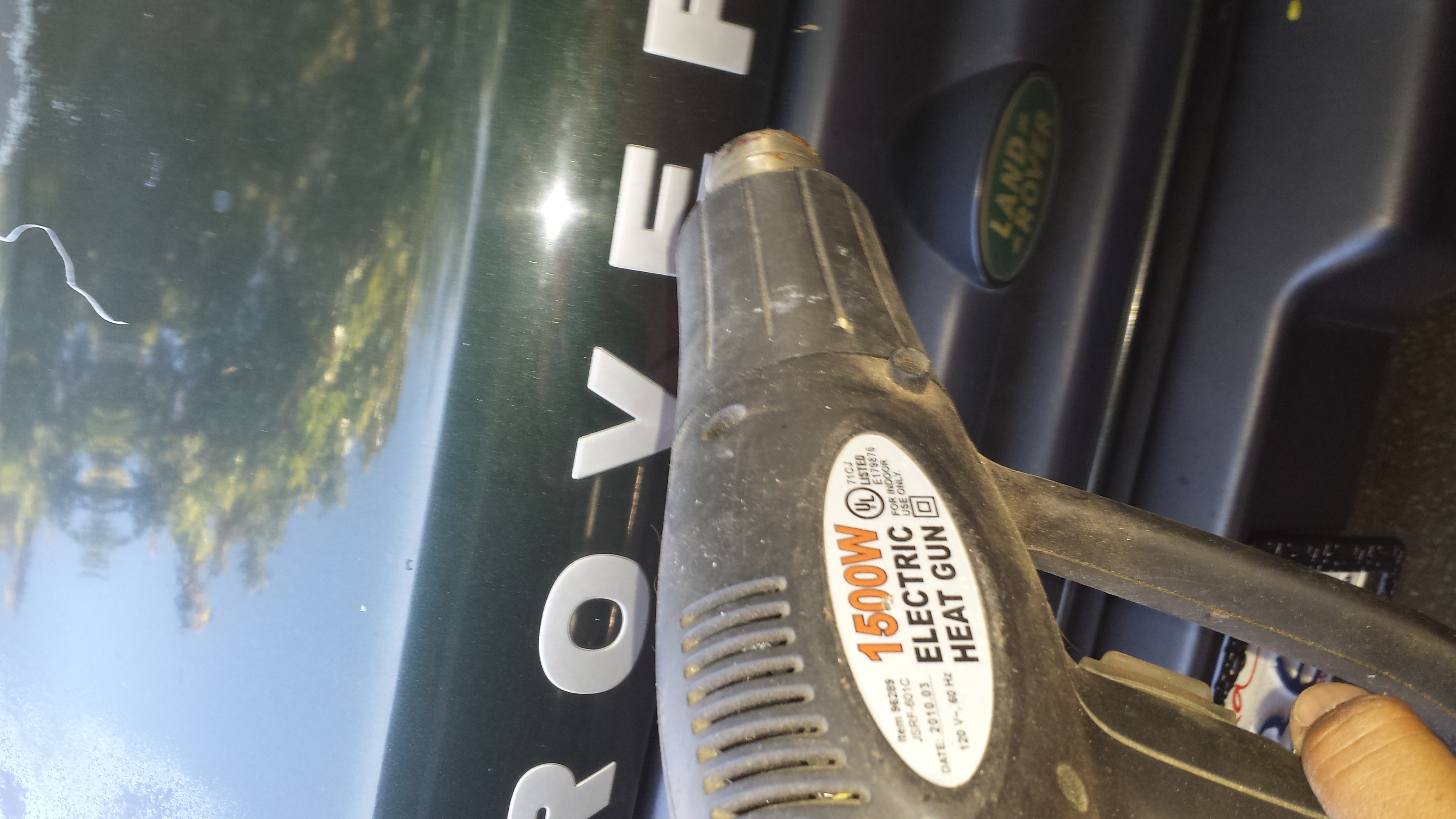

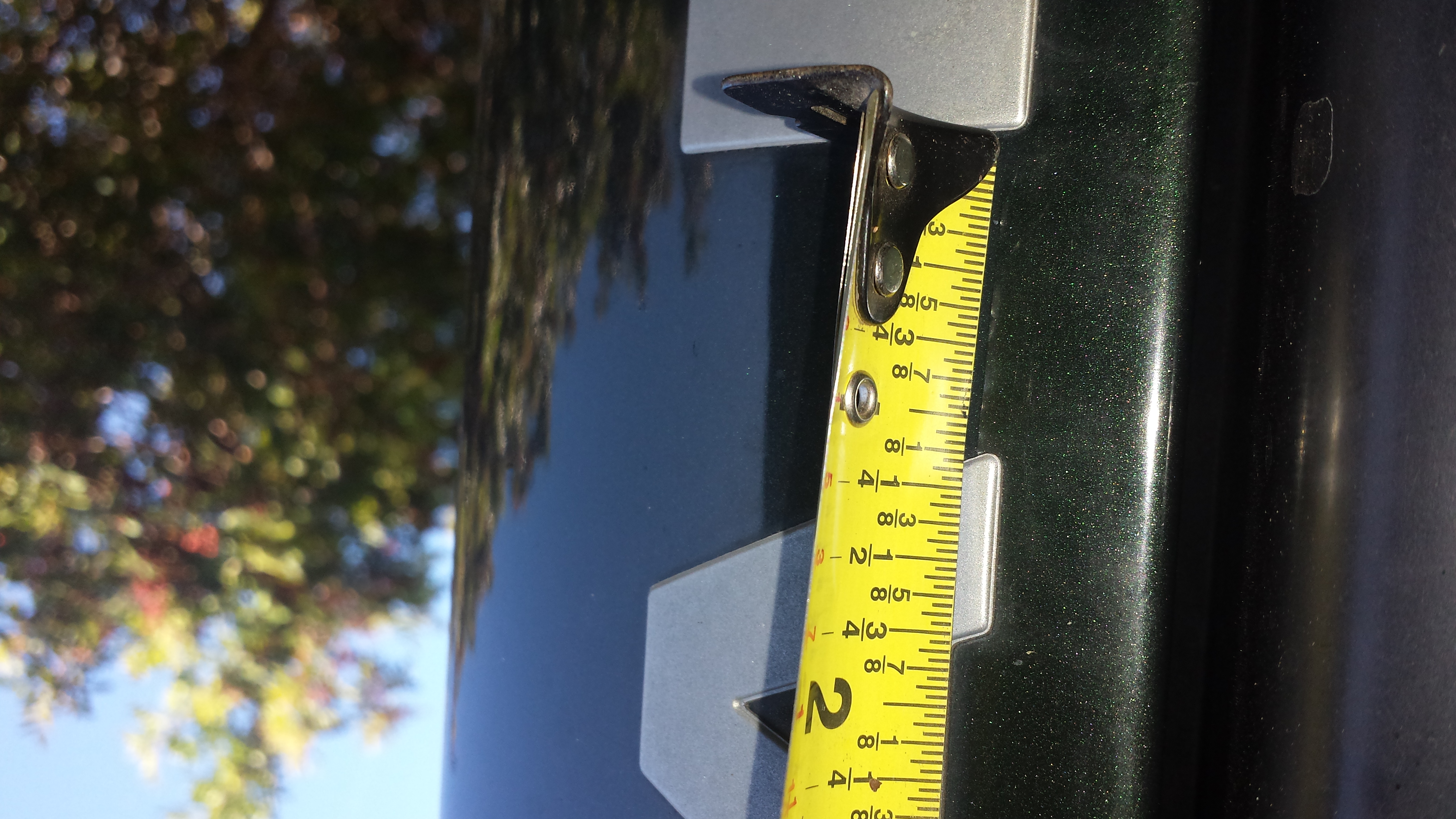

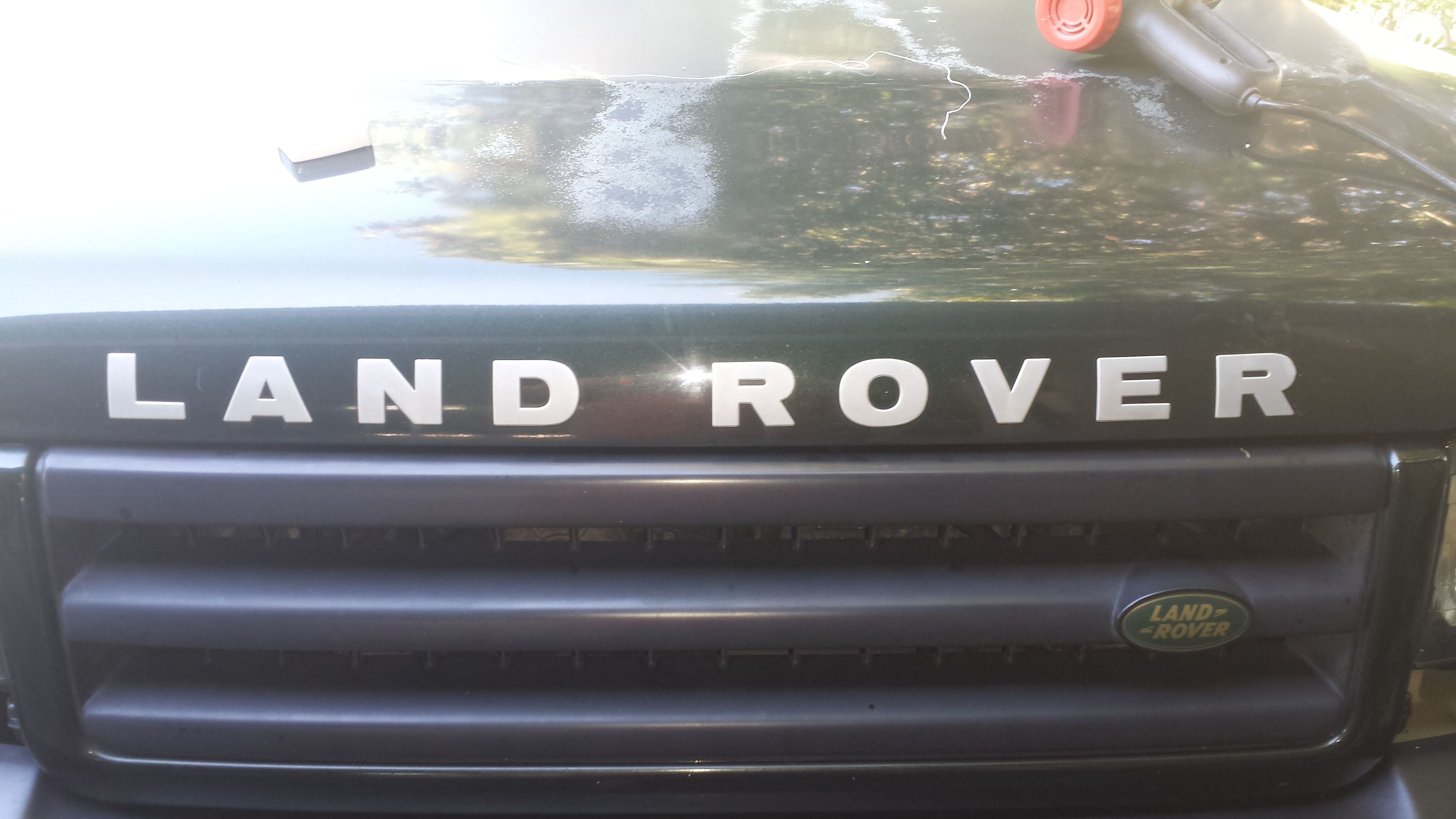

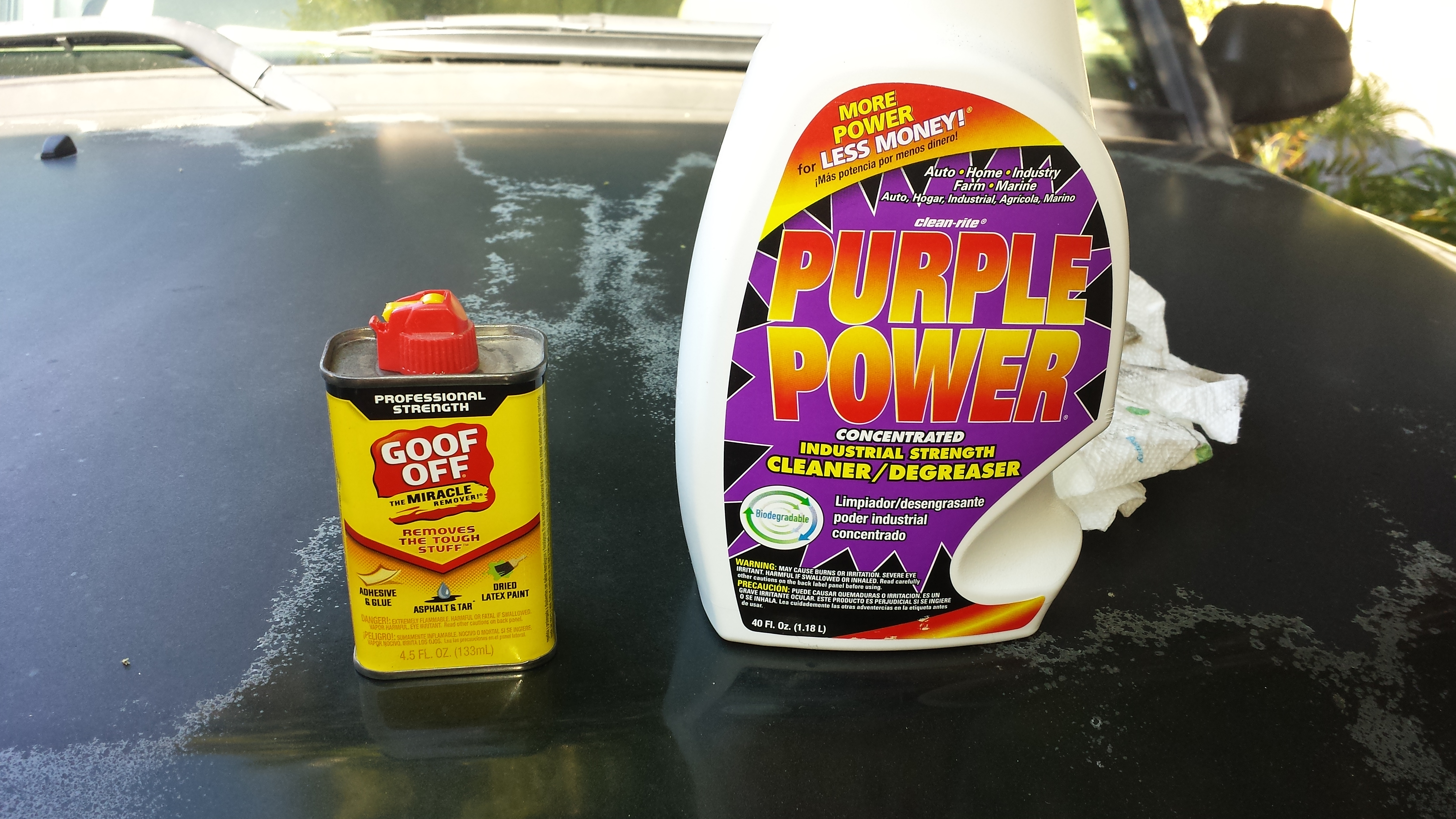

Well today is the day for paint shop dropoff. Hood and Roof will be painted Satin Black. The peeling clearcoat just bothered me way too much. Here is how I removed the decals on the hood. Dental Floss was way too hard on my fingers, decided to use my plastic putty knife. Worked like a charm after heating with my Harbor Freight Heat Gun.

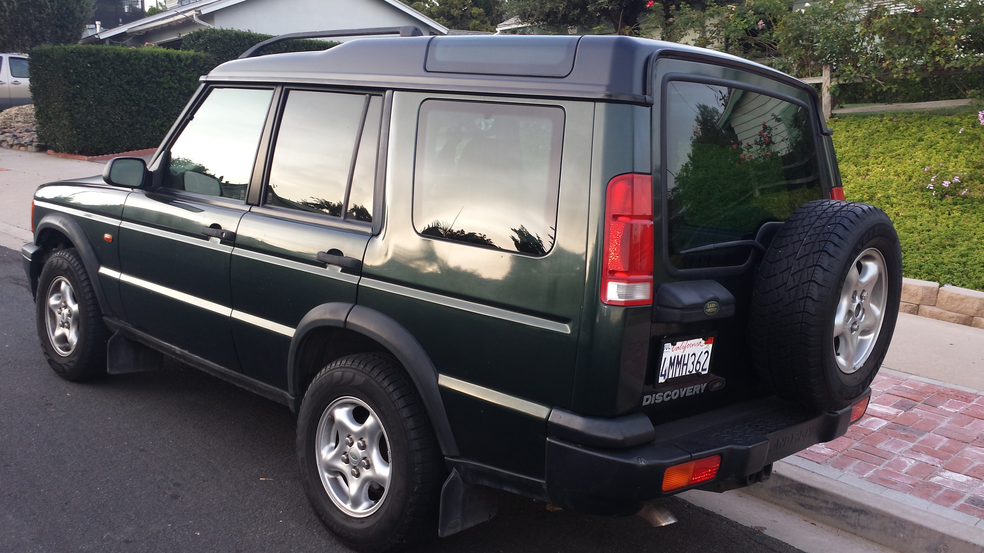

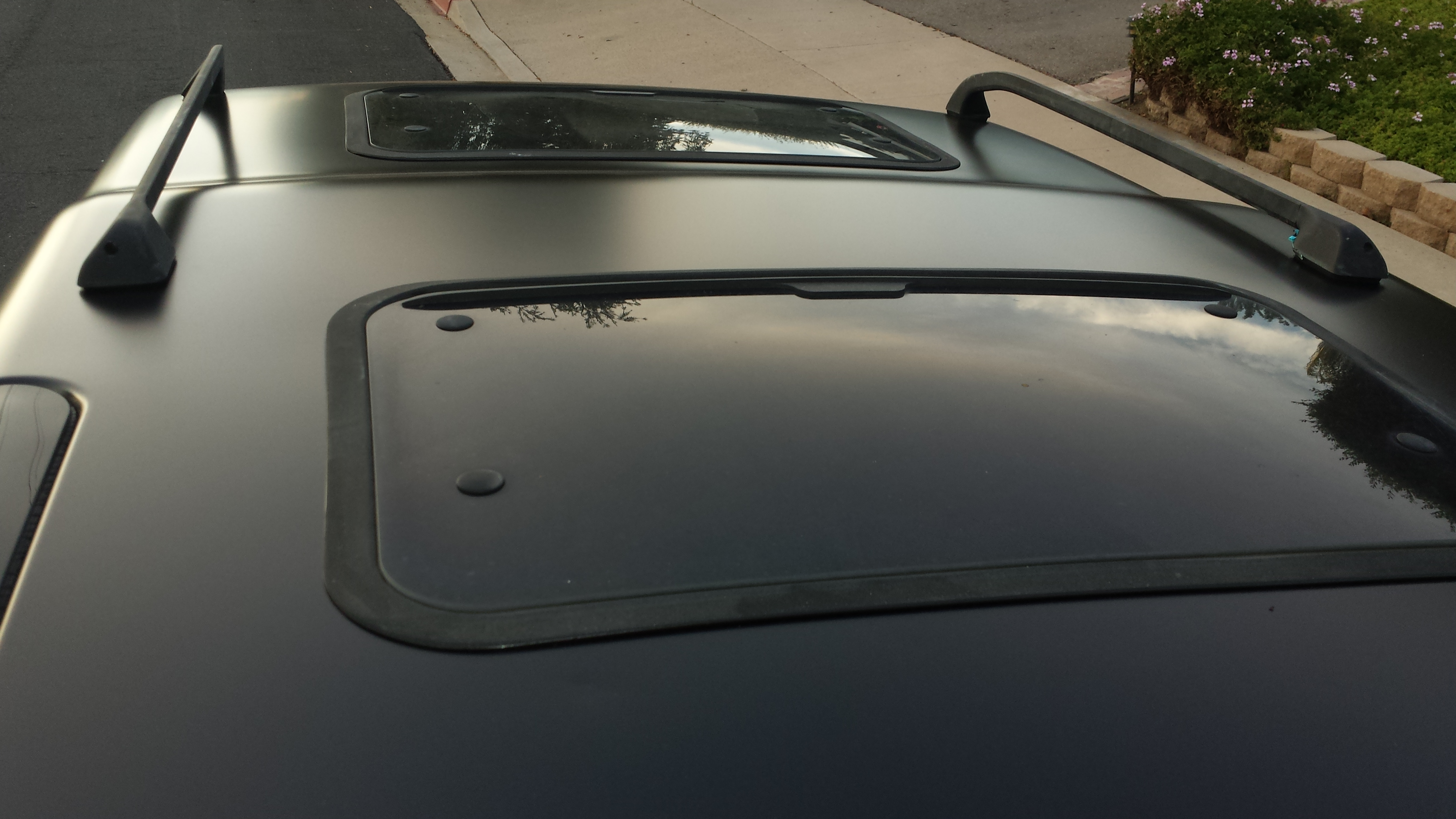

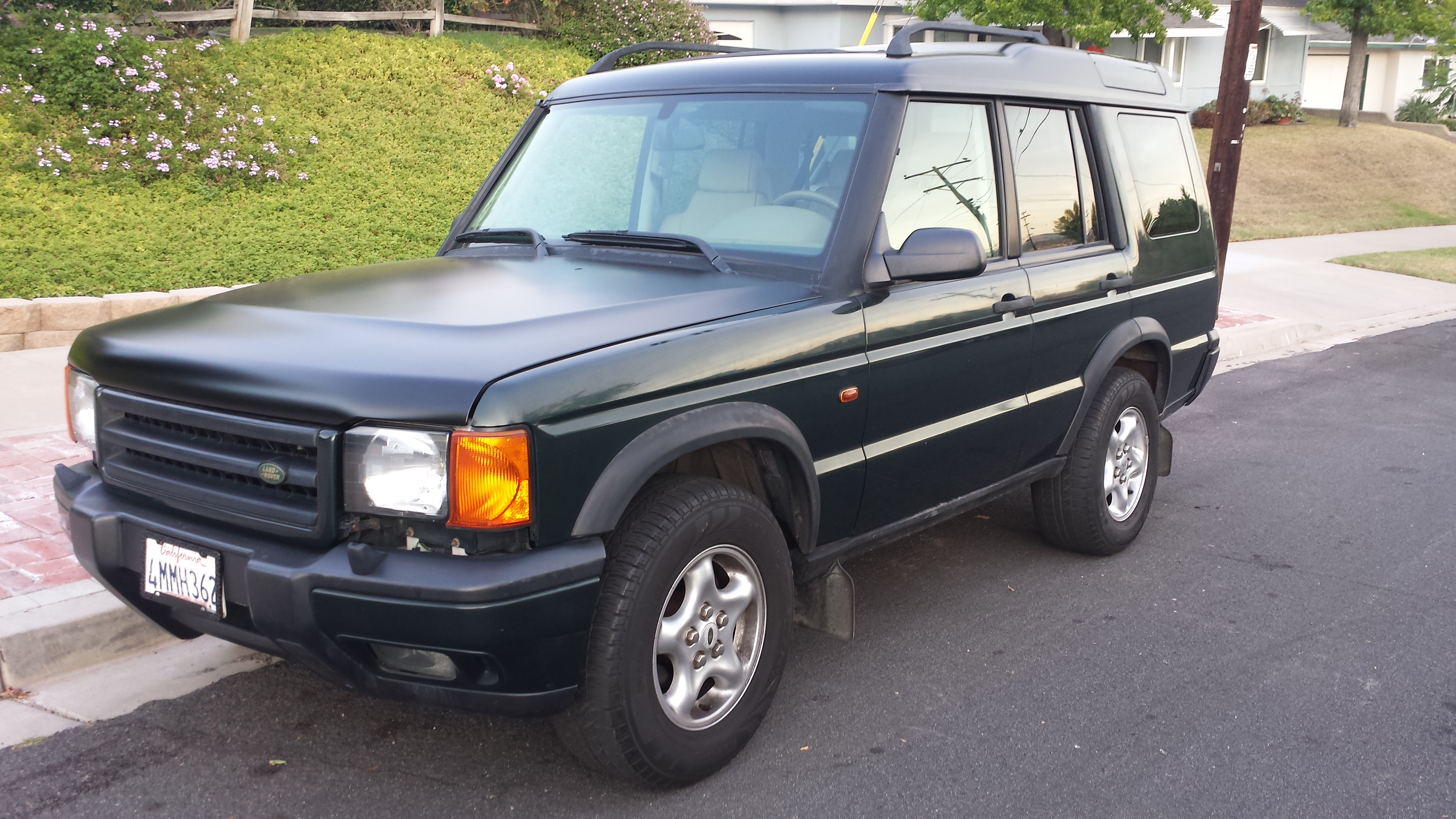

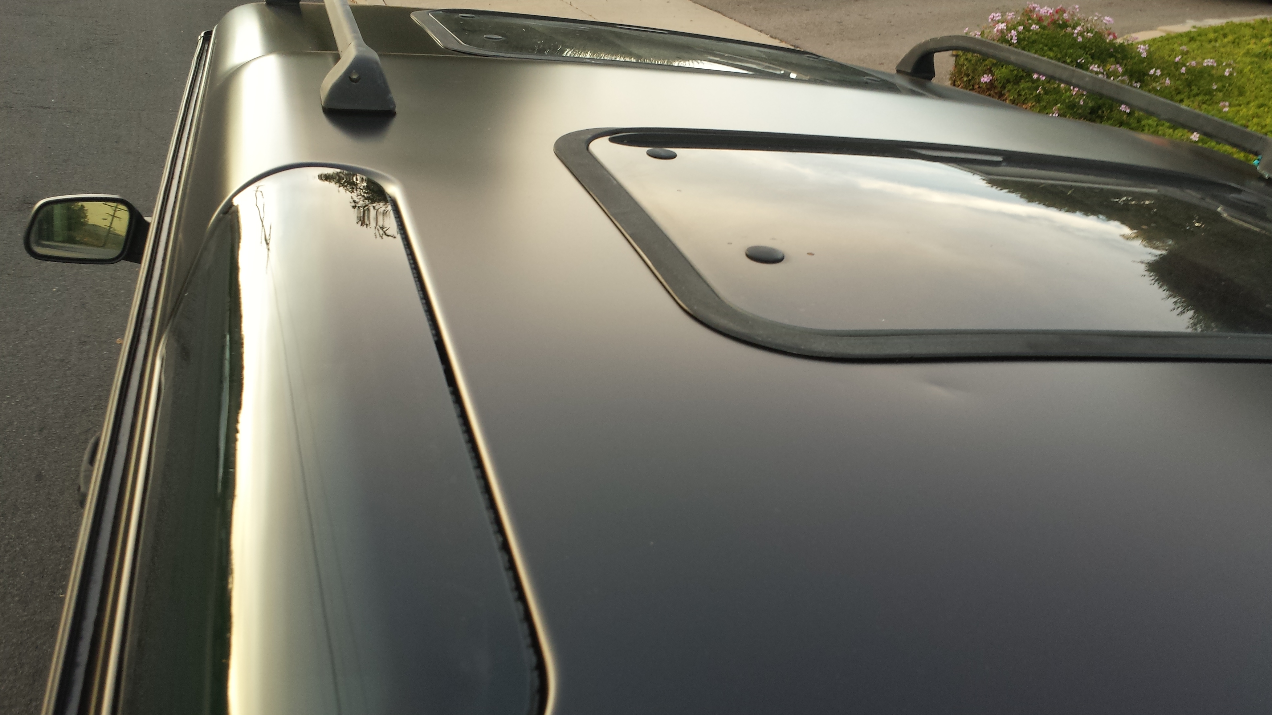

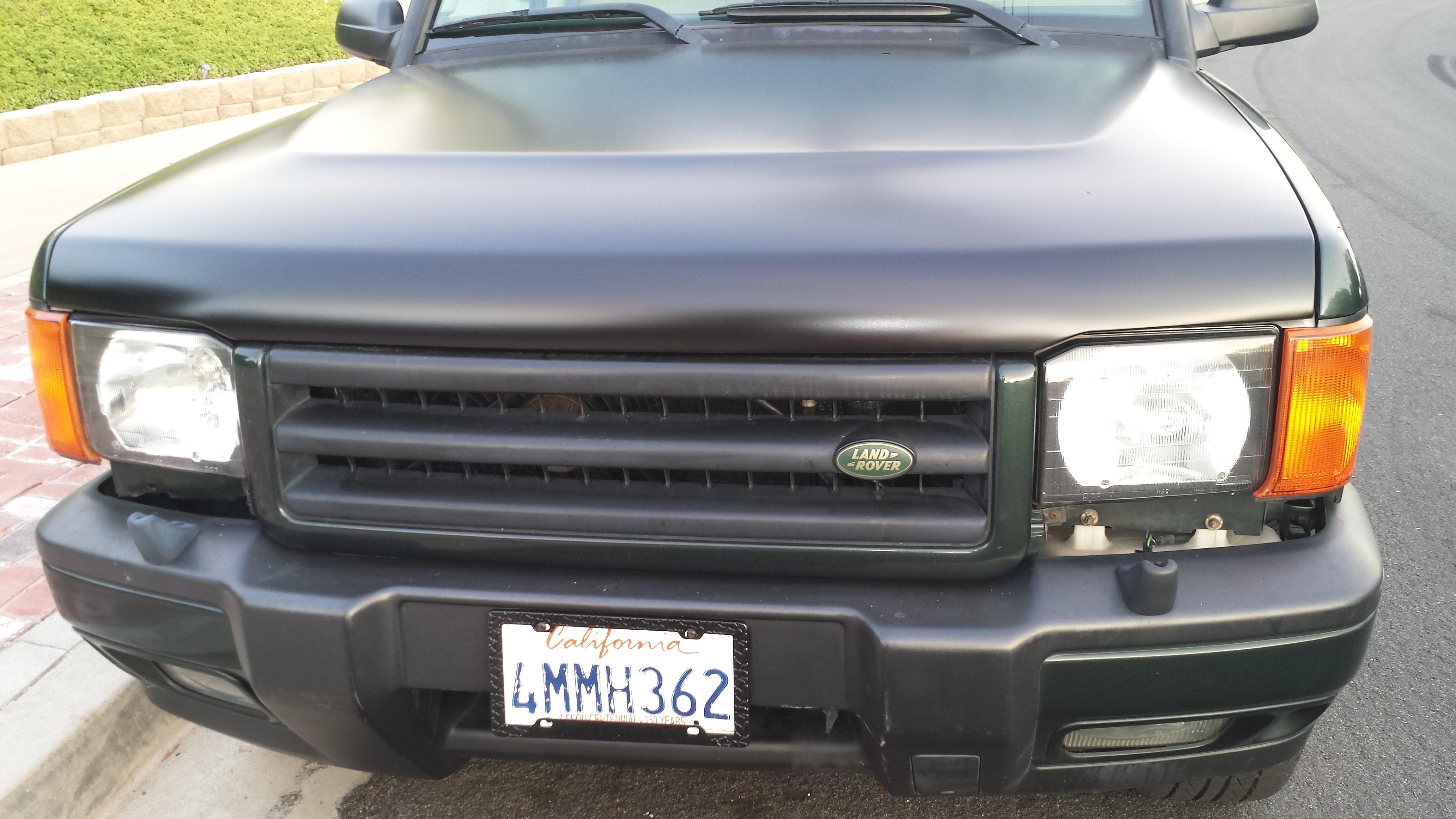

Hood and Roof painted.
