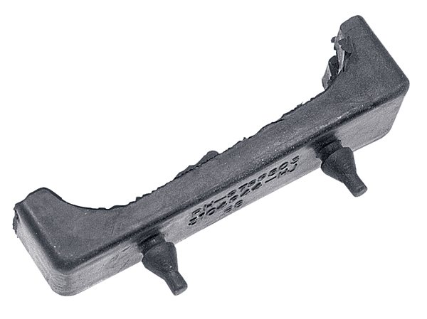

Transmission and oil coolers are held from the cavity walls in its original position, the radiator is fully independent from any attachments to anything and can come out by itself (if I ever need to); it is cushioned by these:
https://s3.amazonaws.com/gearbox-yea...s/4/43345n.png
Also held from existing body holes.
