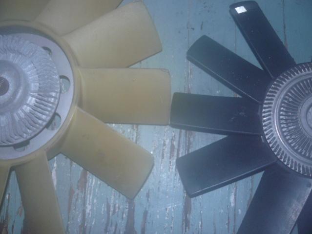

IMHO you are changing the air flow thru the radiator (change the cfms by changing the "static pressure" the fan pushes), not venting extra heat or removing radiant energy from the exhausts and block at such a rate that you are cooling things. Perhaps repeat your tests and add an IR thermometer measuring the temp of the block, manifolds, etc. You could also hole saw a series of opening in the firewall that would allow air to flow out through the cavity under the windscreen, and out the pollen filter array. If the holes don't work for you, they could be filled with knock out plugs or some fender washers and bolts.
Now I certainly think the Rover fan is smaller than it needs to be. You can increase cooling with a fan with deeper pitch blades. I saw 6 - 10F change with that. But my best result was going to a 180F stat. I now run 180 -183 at modest speeds and perhaps climb to 187 at 70 while I watch the gas gauge move. It is hot and humid where I live, frequently in high 90's or low triple digits. All my hood strips are in, as wells as radiator rubber strips. And for sound control I added the hood blanket from a D2, don't know if D1's came with or without them.
