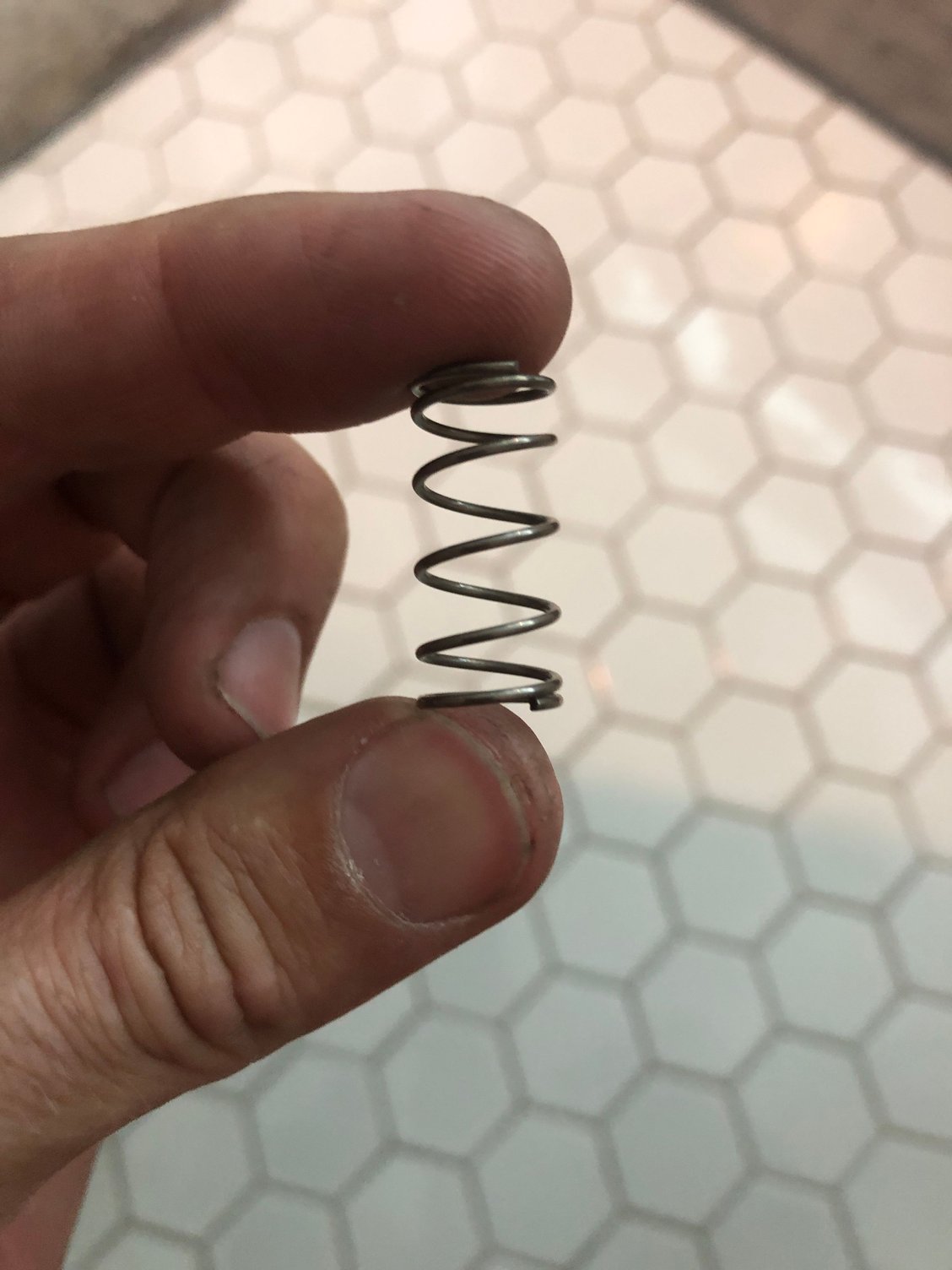

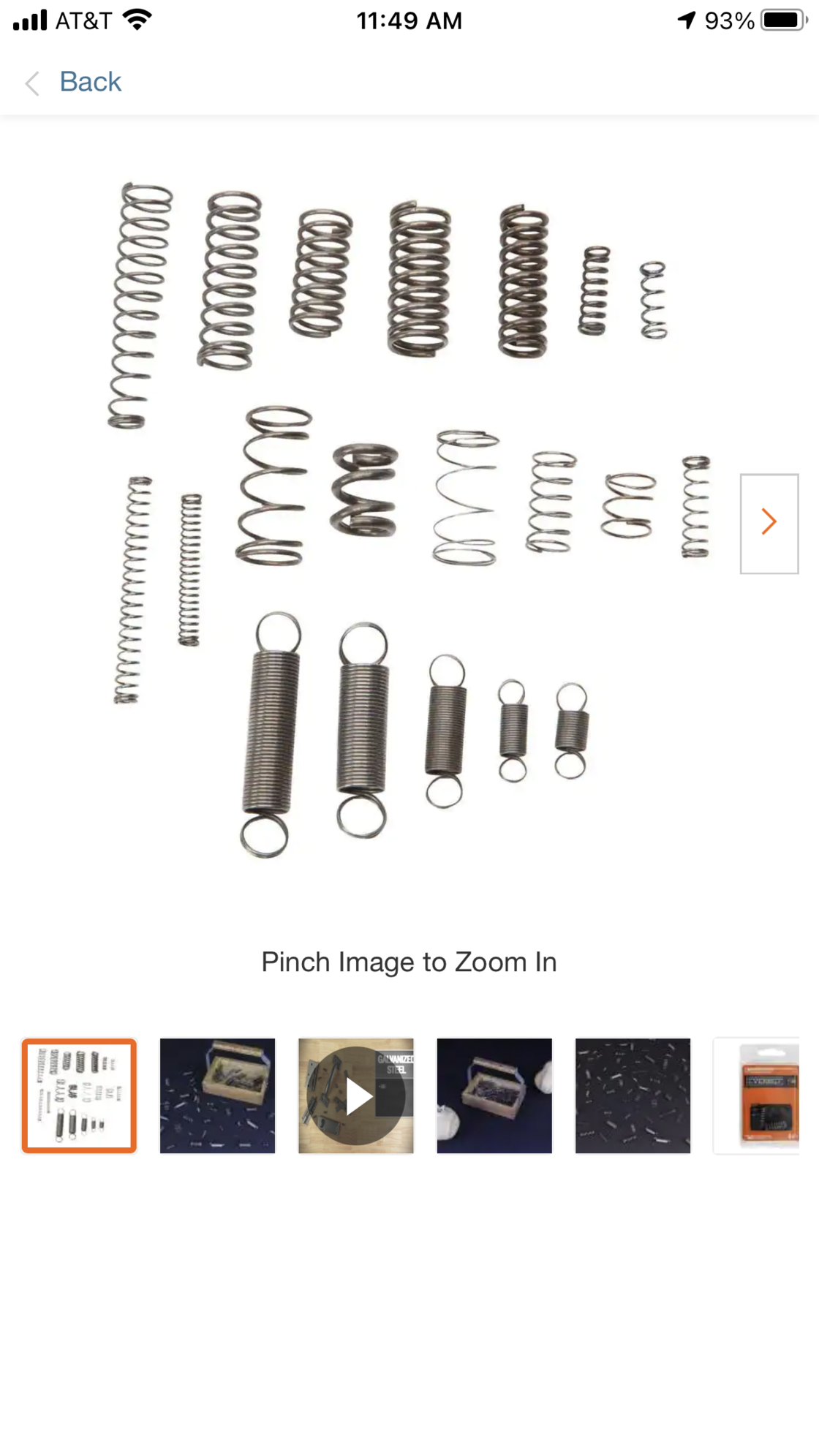

Given this is from 2011, I’m sure you’ve found your springs. For this who search google and land here, there’s a really cheap solution to this.
I bought a non running 04 disco HSE from a guy in town for $500. BCM was locked, and of course the truck had sat for years so I’ve been going through and fixing the slew of other age related issues on my own. Horn buttons were depressed, fuse removed because horn stayed on and after one look I realized they just didn’t have any springs in them. After reading this thread, and searching the Internet for other options. I came across these from Home Depot ($5 for the pack). The spring I used is 1 inch in length and .5 in diameter. I cut two coils off and it fits perfectly.
Hope this helps anyone still on the hunt
