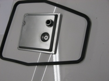

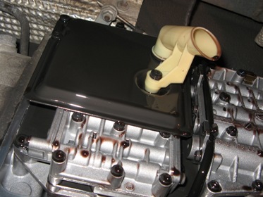

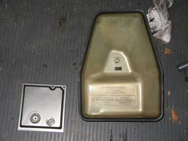

So I just finished my fluid and filter change on my 03. everything went very smoothly thanks to the easy steps. The only thing I would add is when I changed the filter the three bolts holding it in were torx heads I luckily had some but just to make anyone aware that apparently on an 03 you will need a torx set.

Can anyone tell me if there is a gasket that might need to be replaced on the transmission oil pan cover after it is removed when replacing the filter. Thanks
Yes there is a gasket that needs to be replaced.

From: Birmingham, AL
Bought a transmission filter kit at my local Advance for $13... comes with the gasket and o-rings. Part No. FK-279
