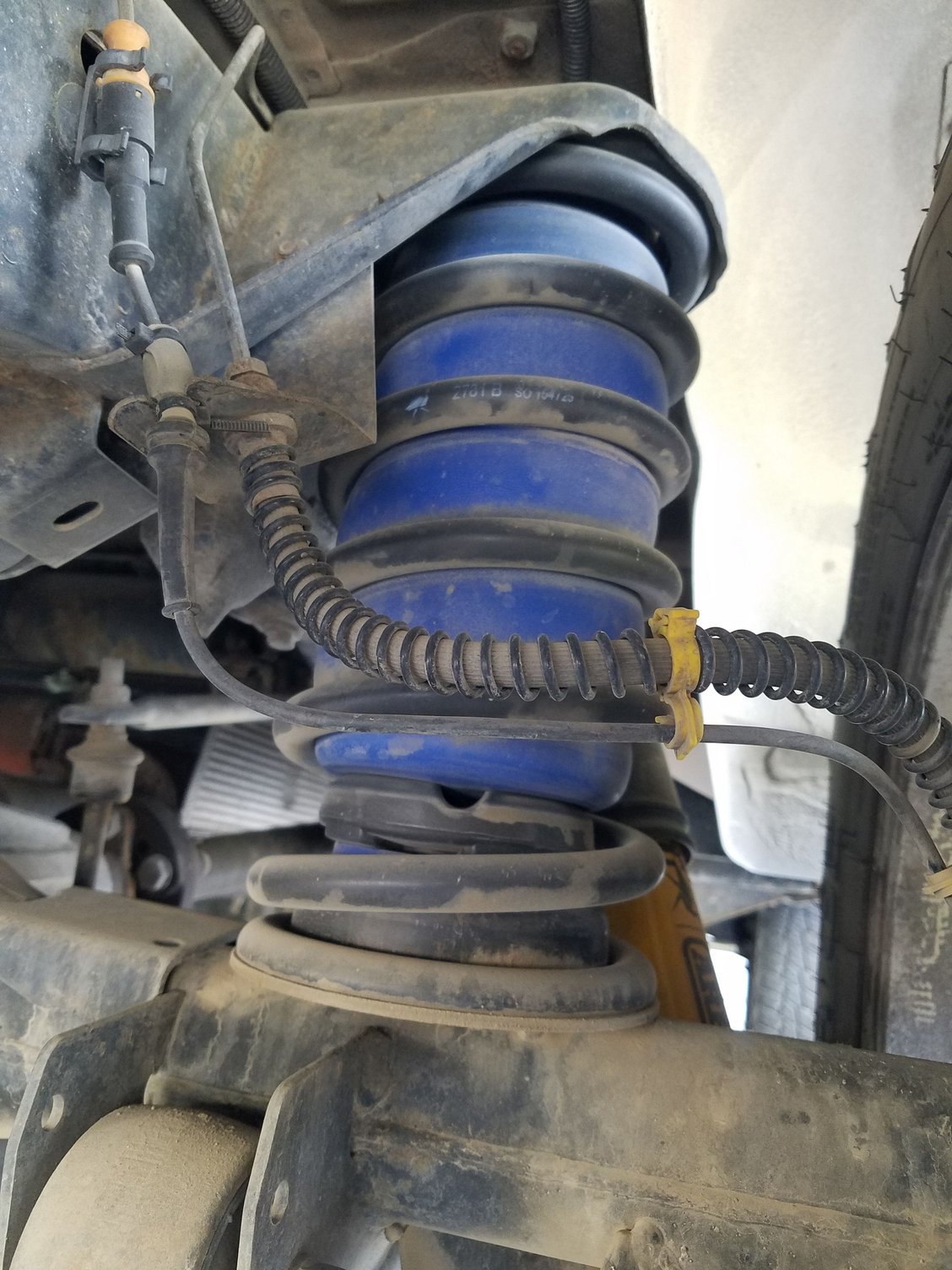

Air helper springs or air bags. They are cheap and easy to install. I have them for 6 years now and they never made any problems. I can adjust for load and get the truck perfectly level (camping gear for 5 people and I have a hitch rack which puts additional stress on the rear springs). I just inflate them and they hold the air for weeks. Probably not the best solution for heavy off-roading due to limiting articulation, but I didn't feel any problems on easy trails.
Now I have converted to MD OMEs, I inserted some rubber spacers to make up for the 2" taller coils. The setup can be improved by inserting an air connection between the two air bags controlled by a valve, which would improve articulation when needed.

The things that are missing in the 4150 kit are the upper supports which came with the 4121 kit: https://www.firestoneairide.com/rr-k...W237604121.pdf , but that is something that can be improvised. They are made from plastic. Also the 4121 kit did not contain the lower pads, but the customer support send me a pair. They are needed to protect the bag at the bottom against the sharp edges of the hex bolts. It can be improvised with rubber pads as well. I used those as spacers as can be seen in the picture above:
