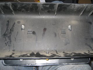

No, the holder attaches to the plinth. It should have 4 holes in the front. 2 to clear the plate screws and 2 for the tabs to slide up into. The bottom of the plinth has a hole to screw the bottom fastner into.
Mount the license plate to the holder and then attach it to the plinth. and yes, I just happened to have a plinth right next to me when I read this. I had to take mine off because I have a standard size and it ouldn't work with the brush guard I got.

This looks very good, thanks. going to take a look tonight after i leave work.

Thanks a lot. My plith done have the places to put it in. going to fabricate it now. but photos helped.
