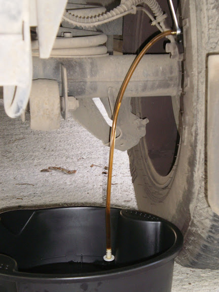

Break loose the bleeder screw on the brake caliper and then snug it back up.
[IMG][/IMG]

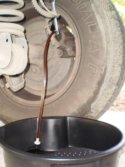

Attach your tubing to the nipple on the bleeder screw and put the free end of your tubing into a collection container.
With the engine off and the windows rolled down have your friend pump up the brake pedal until it is hard and then hold it there.
Loosen the bleeder screw.
Once the brake pedal goes to the floor tighten the bleed screw and then release the brake pedal.
Now pump the brakes back up.
Repeat.
Keep doing this until the brake fluid resevoir is low, then top off with new brake fluid.
Make sure that you use the correct fluid, Land Rovers require DOT 4.
You will want 2 quarts on hand.
[IMG][/IMG]

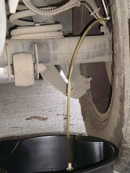

Keep doing this until clear fluid comes out of the bleed screw.
Once that happens tighten the bleed screw and remove your tubing.

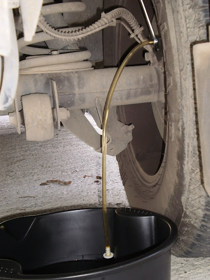

8. Every few pumps, refill the reservoir and go to the current wheel being flushed and make sure the hose didn't fly off the bleed valve and that you aren't spraying brake fluid all over. (Happened once on my first try.) Also monitor for clarity.
This is not my vehicle, this one belongs to a customer of mine. '04 Disco

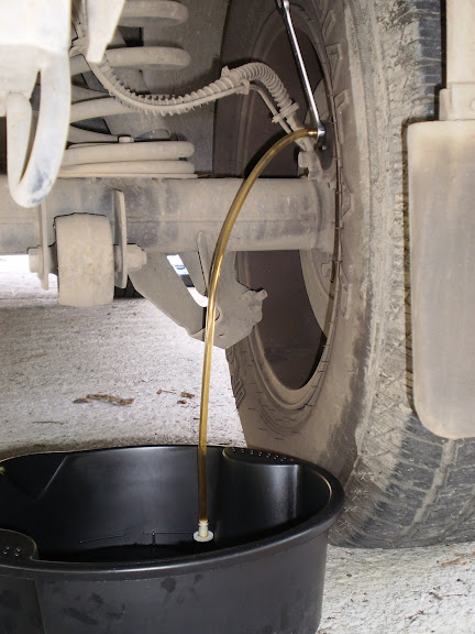

A FEW PUMPS LATER... ALREADY GETTING CLEARER
Tighten the bleeder valve and remove the hose pinching it off as you pull it off the valve.
