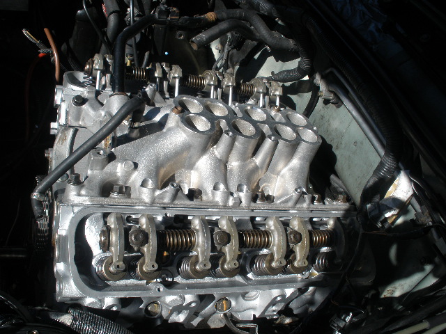

Everything is clean, I started putting things back on.
Attached Thumbnails How to install oil separator-pb275701.jpg   How to install oil separator-pb285719.jpg   How to install oil separator-pb285720.jpg

Thumbs up Oil Separator Installed. Here it is !
It is tight, some thin oil did help along with tapping it ever so lightly.
Here are some pictures for those of you that were like me just a few month ago...I was a complete newbie, but its coming along.
P S
On the Right Bank "Passenger side" Rocker Cover " Valve Cover" there is nipple, that's where it goes. See the pictures below...Good luck !
I'll be posting threads about my challenges and conquest of my overhaul.
Thank you all again !
Attached Thumbnails How to install oil separator-separators.jpg   How to install oil separator-cover.jpg   How to install oil separator-valve-cover.jpg   How to install oil separator-oil-separator-1-.jpg   How to install oil separator-oil-separator-2.jpg
