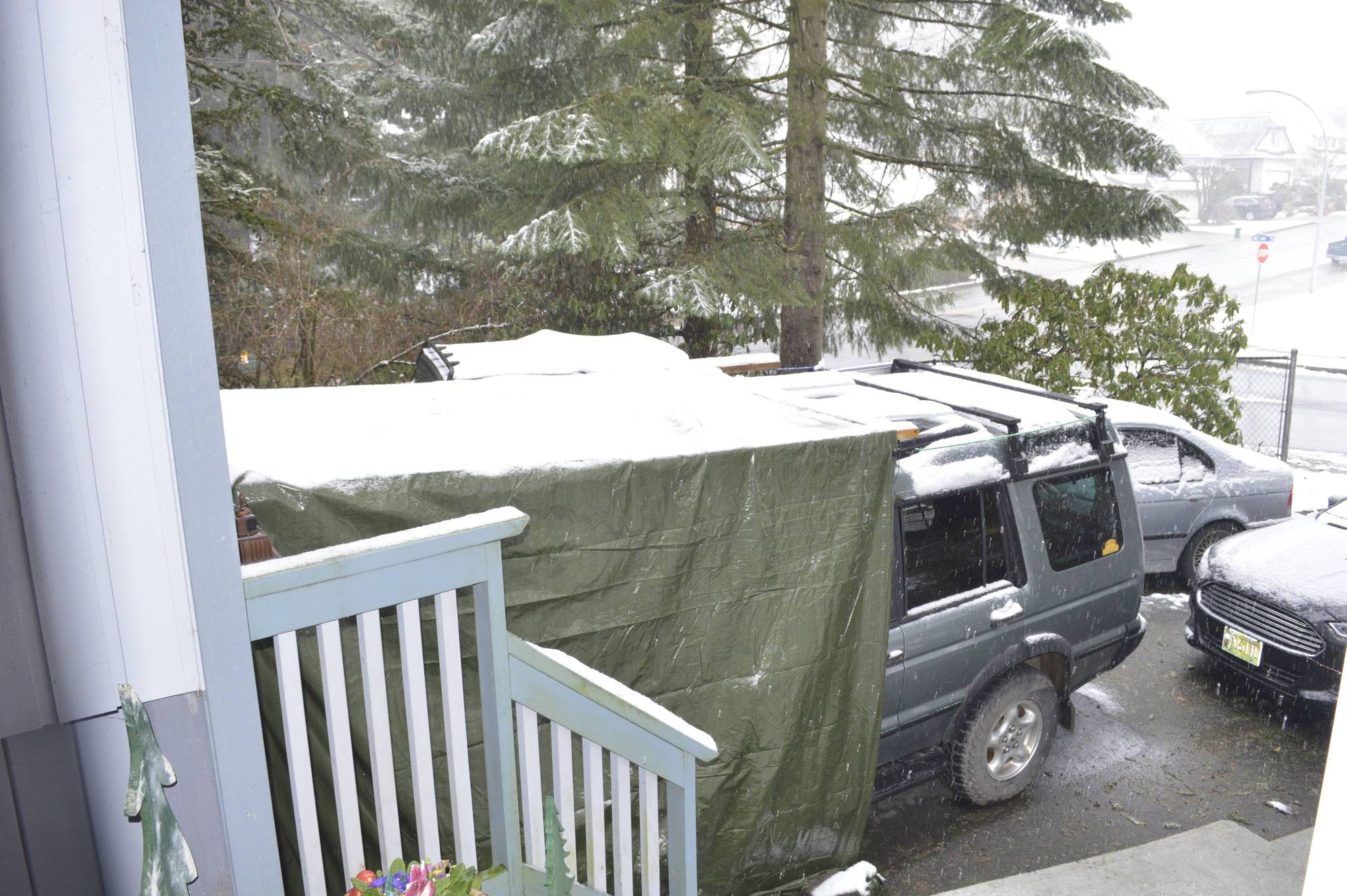

Working on my head gaskets, snow got a fair bit deeper
