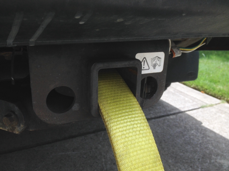

I have always just planned to do as pictured in the case of a recovery from the rear; one end of my tree strap inserted in the receiver with a hitch pin holding it in place and the other end connected via shackle to another vehicle.. Or some variation on the theme. Is this a bad idea?

Well, have you ever tried to remove a bent hitch pin? It's not particularly easy.
And you don't want to use a non-elastic strap (which a tree strap is) in that kind of recovery.

Okay, fair point re: the hitch pin. Would the largest possible diameter Grade 8 bolt holding the loop of a proper kinetic recovery strap be okay? Not surprisingly I'm not keen to drop $50 on a shackle mount if a $3 Grade 8 bolt will serve the same purpose with no compromise of performance.
But back to the hitch pin; why would we be concerned it will bend with a strap attached to it and not be concerned about it bending if holding a shackle mount? I expect the answer is that the load is distributed across the full width of the receiver with the shackle mount but may be more concentrated with a strap. Is that correct?
No, that will bend too.
Seriously man, if you half *** this, you're going to break ****. And if $50 isn't your speed, $10 should be.
