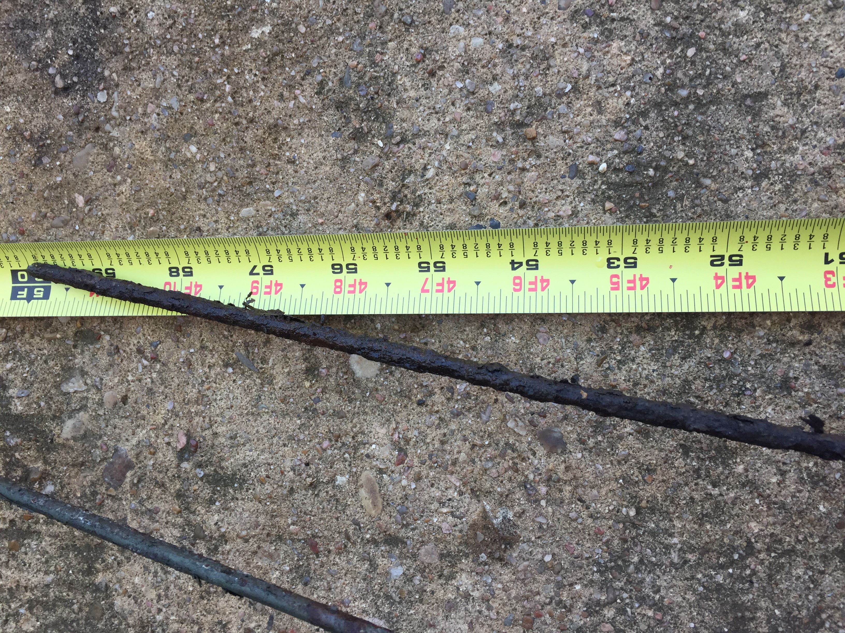

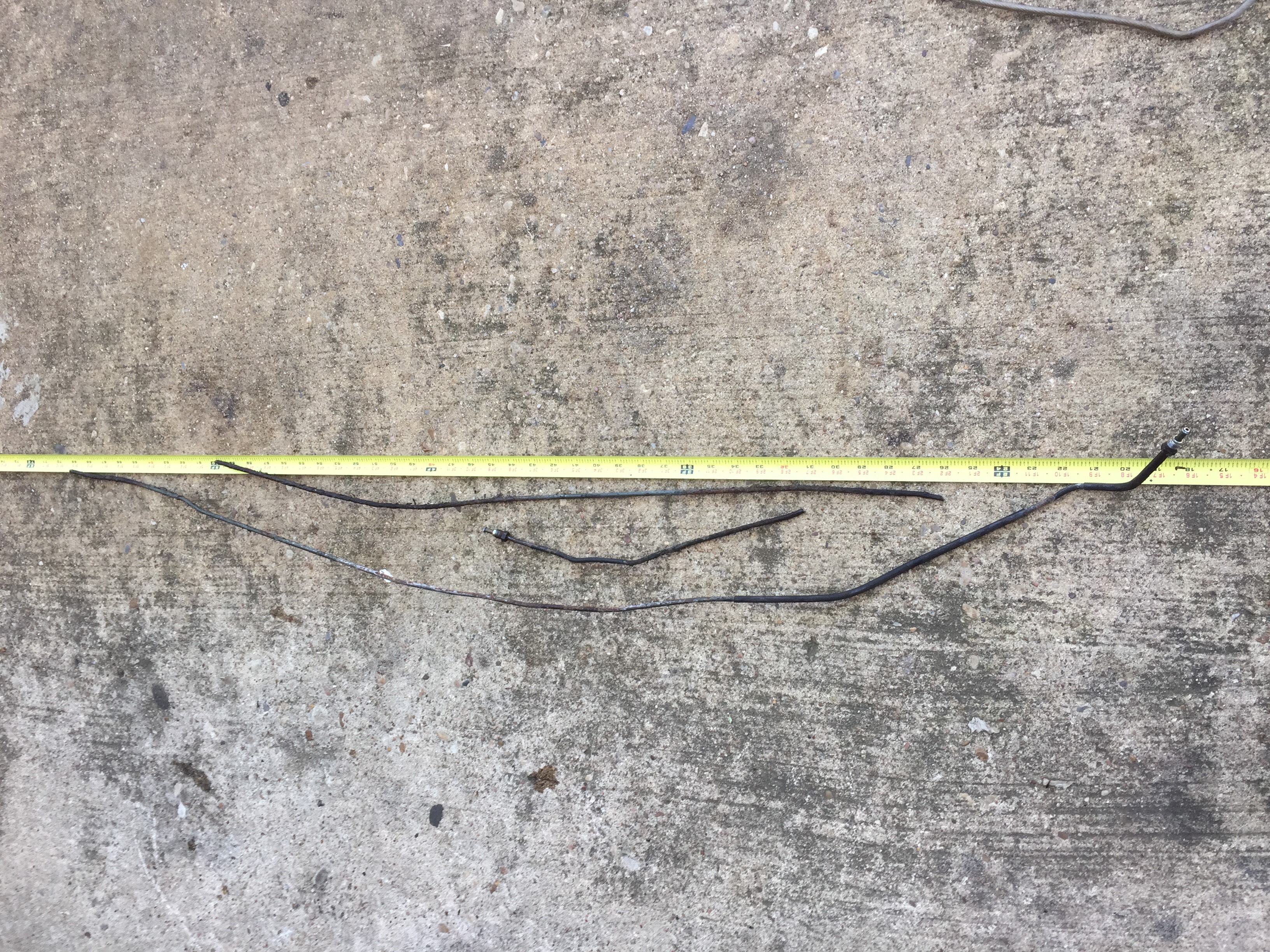

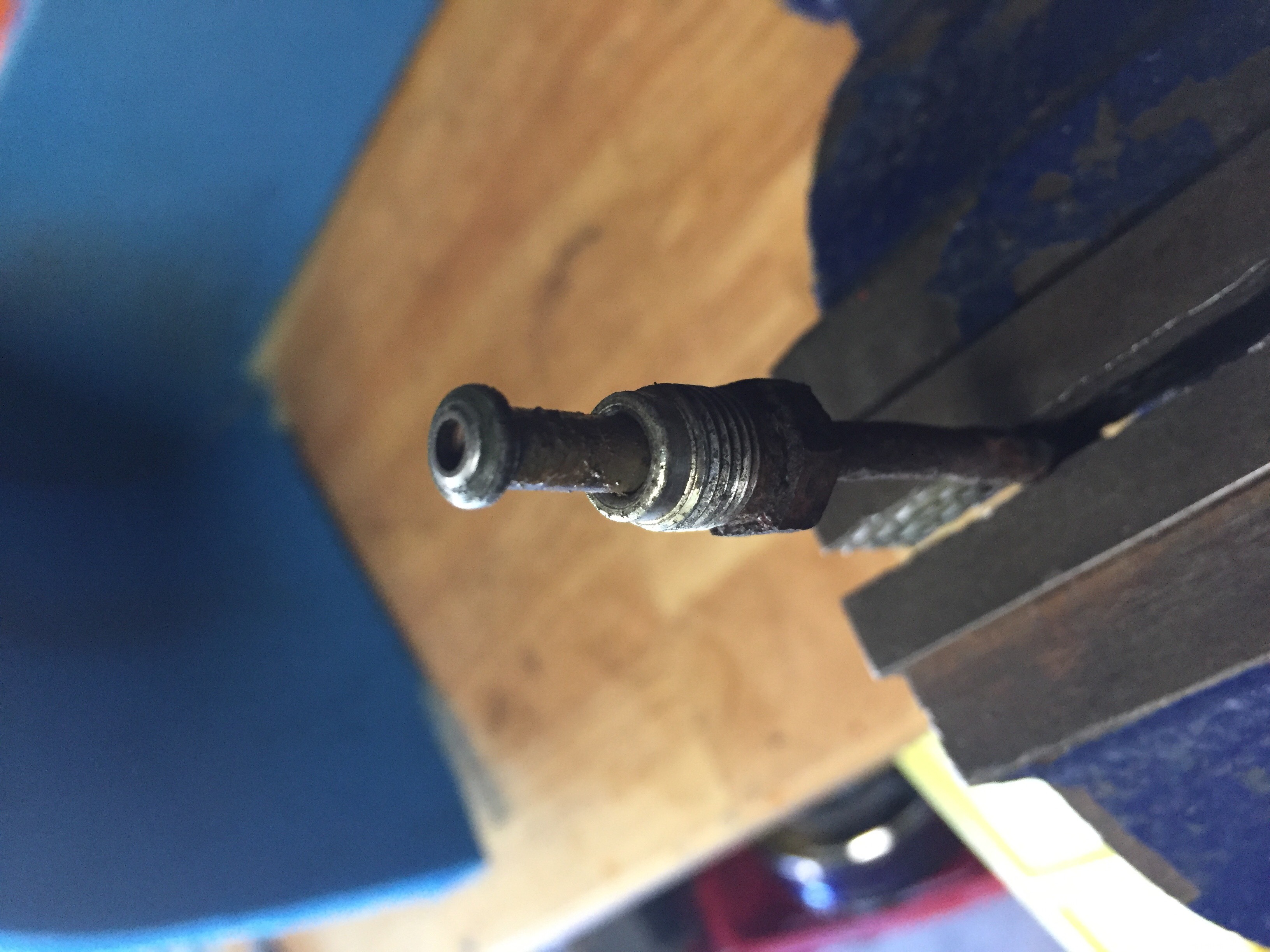

I just pulled out the left rear side of the line. attaching some pic. they was so bad that broke into pieces. Right side not sure yet but looks fairly straight forward. I had to break those metal clips that were holding the lines on the frame. I have to come up with new way to mount them.
I ordered 25 feet of 3/16 Non-Corrosive Copper Nickel tube Amazon prime ($25)
Now gotta get some new fittings.
According to this site (Brake Line | Fitting Identification How-to)
my fittings look like ISO Bubble. may be Autozone/advanced will have loaner or just buy the darn tool to make flares.
I am going to replace all the flex hoses too. they are still the original ones and old.
Not sure If i want to pay $160 for braided hoses (Discovery Series II Brake Hose Kit | Discovery With Raised Suspensions). still looking any suggestions?
Copper Nickel tube supposed to be easy to bend and snake through the frame.
Stay tuned. I will try taking pics i have not found any instructions or videos anywhere yet for line replacements.
