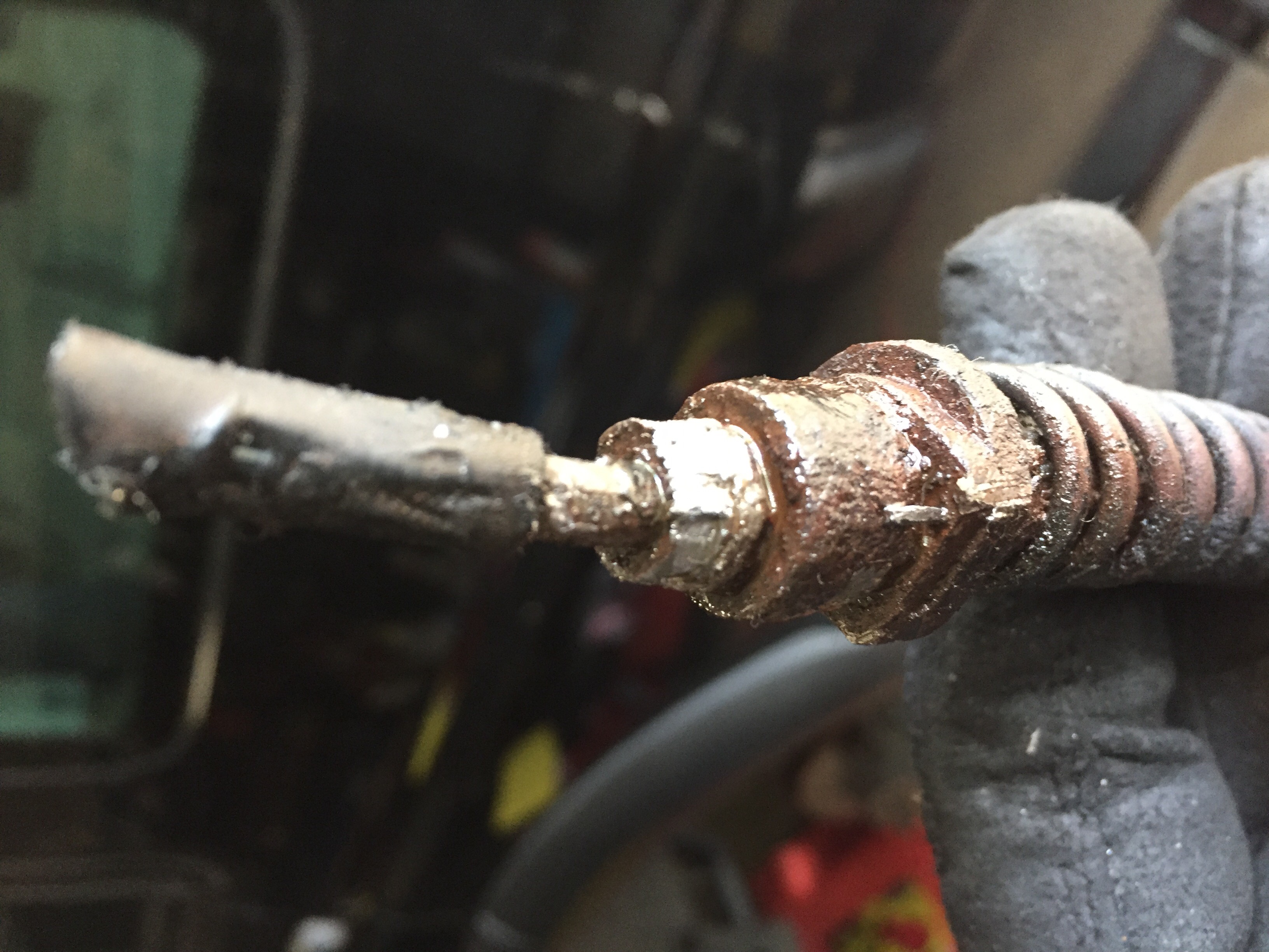

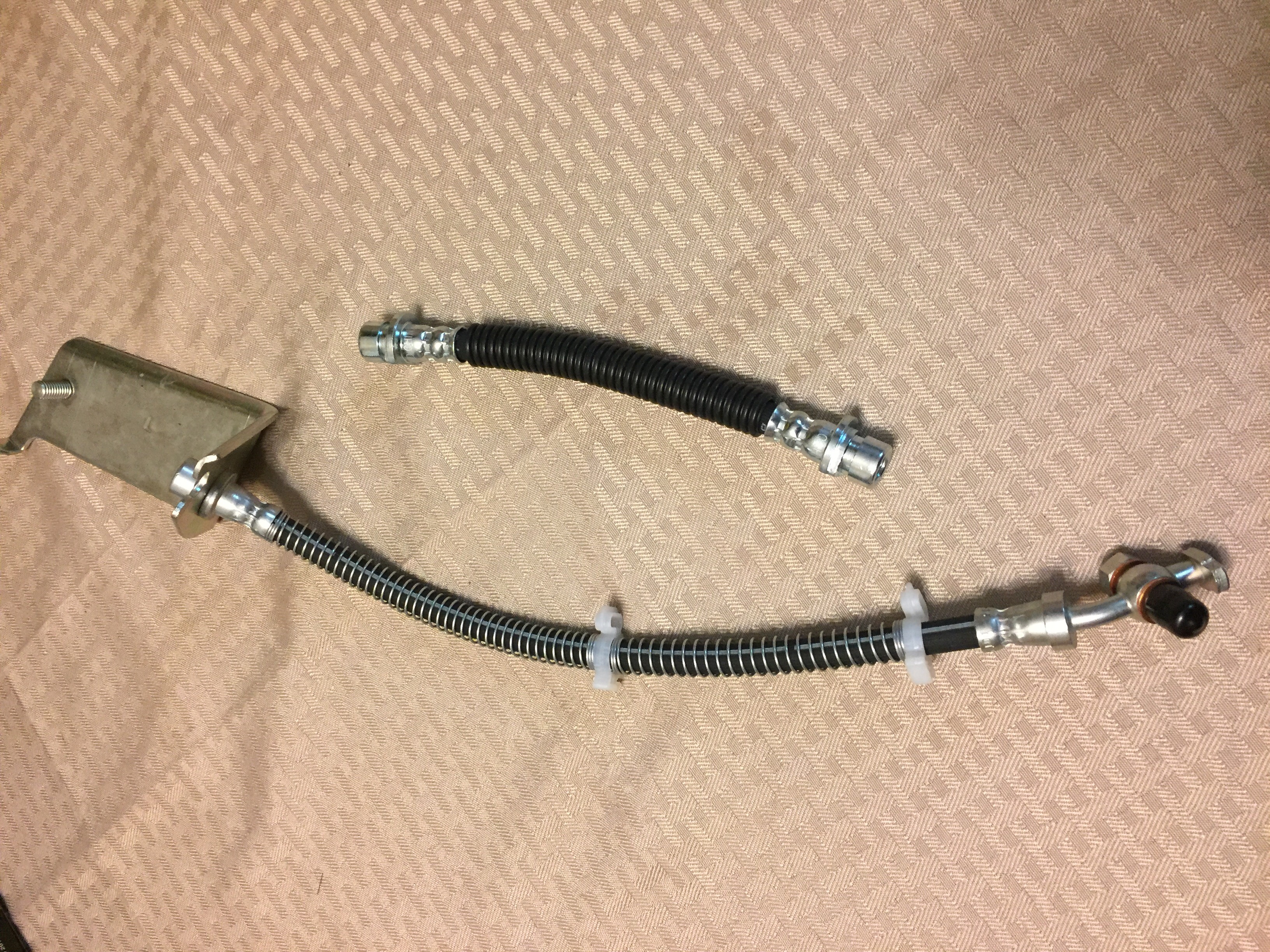

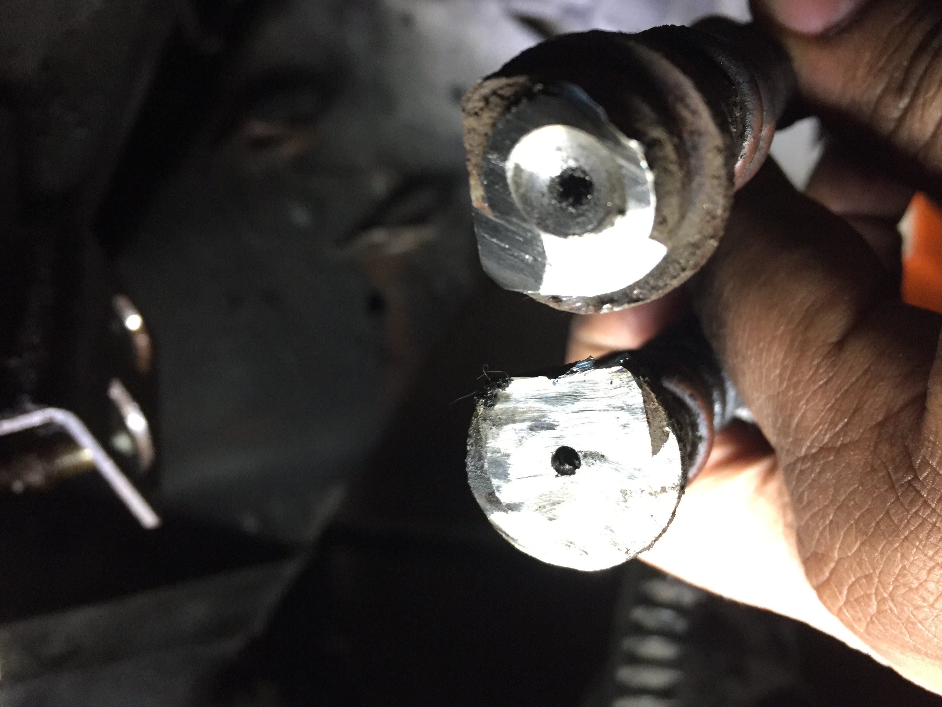

Very tedious and messy. I had to Cut some of the joint bolts as they were rusted so badly - no mount of PB-Blast and Grip vise worked. I had to redo the joints on all 3 metal lines from ABS Shuttle to the junction. Used Dorman parts they looked good came with mounting plates on the rears. here are some pics of mess and after done.
