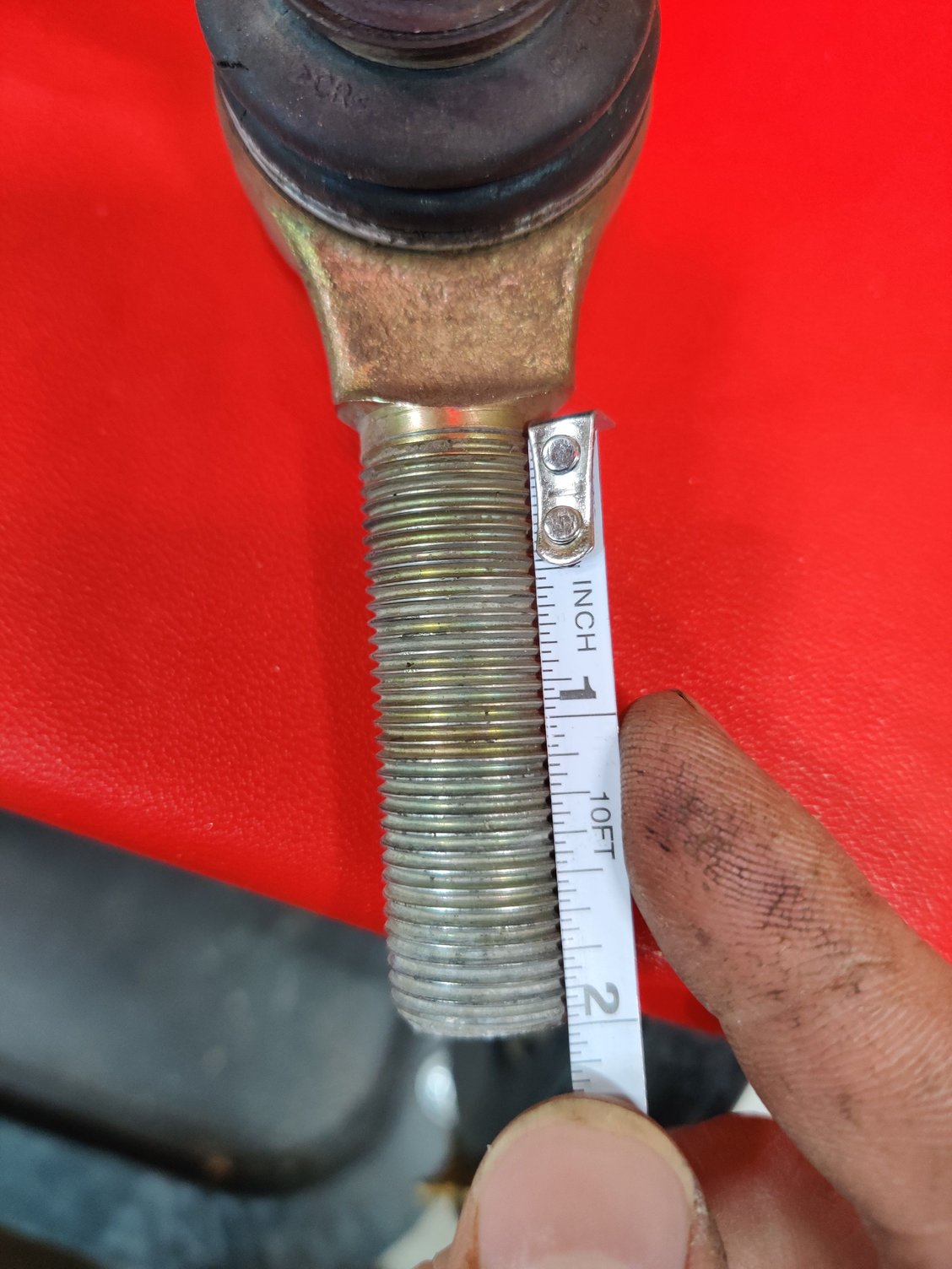

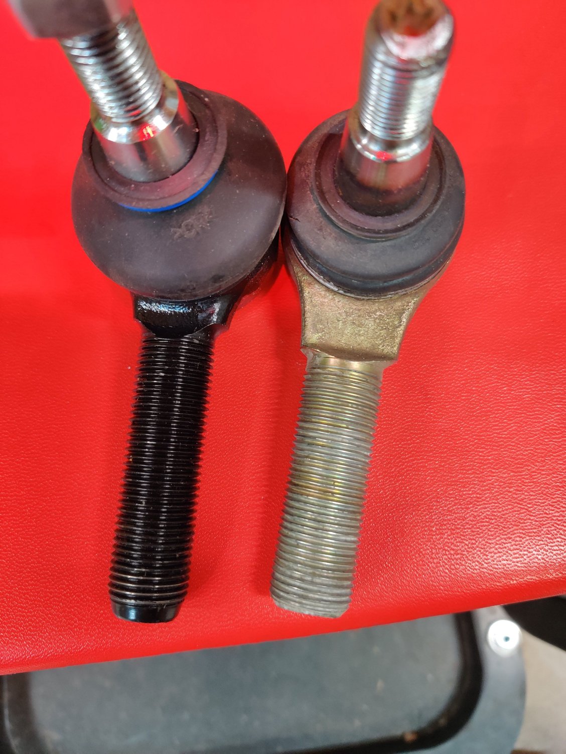

As promised here is the thread pitch for the end links that came with my bar (d2 end links) and the D1 end links I tried to fit in:
Original end links (supposedly DII end links). ~17 threads per inch:
New end link (D1 end link). ~16 TPI:
Side by side:
