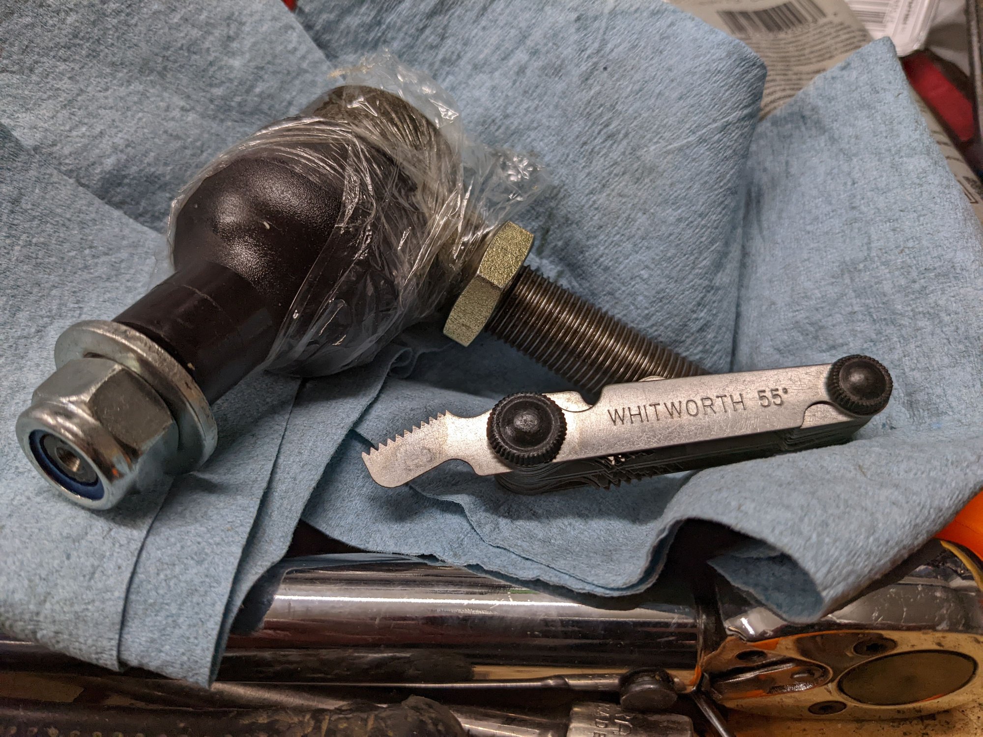

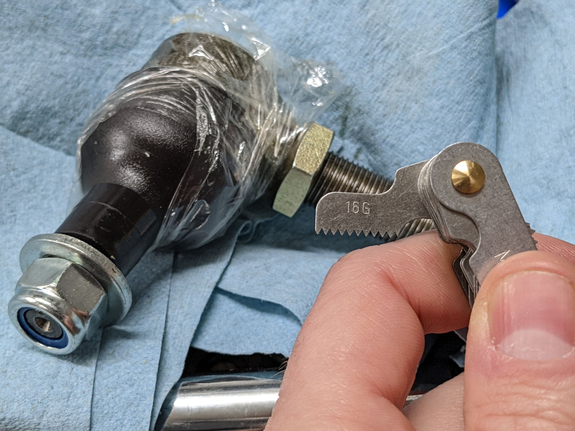

Before I installed them I measured the threads. Looks like they are Whitworth 16G..whatever that means.

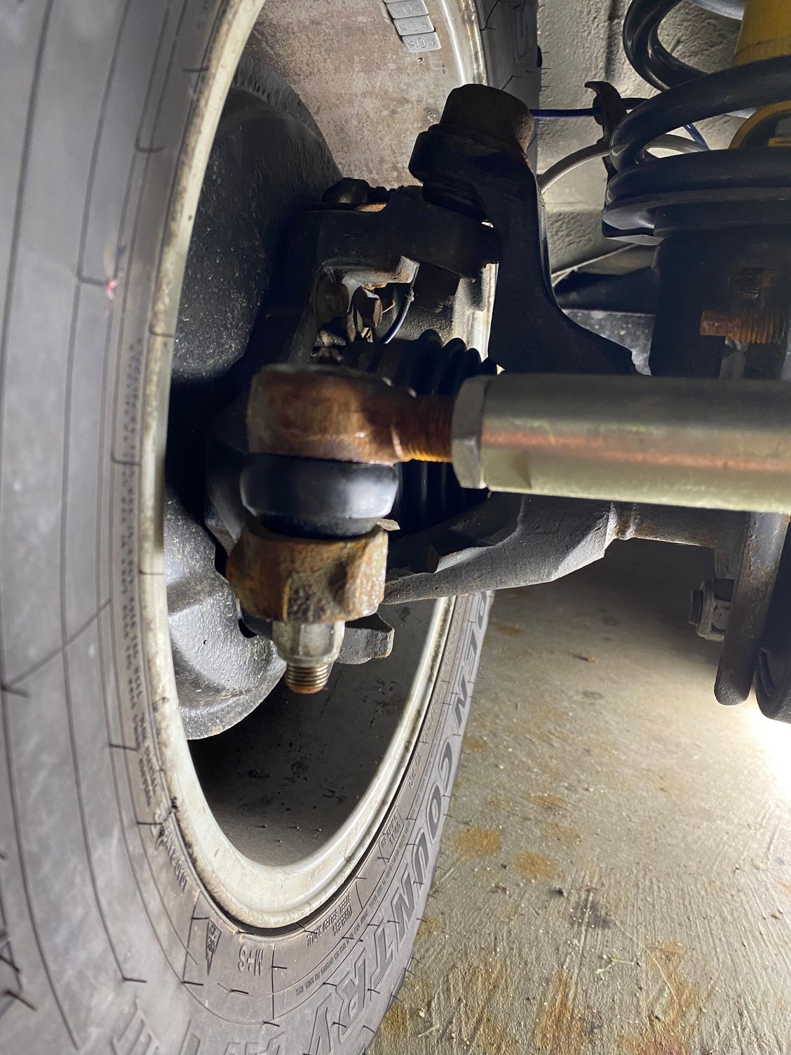

Has anyone checked on replacement boots? I have the TF rods and see a crack forming after less than a year on the drag link. A quick google shows them for other applications, curious if there might be crossover to the TF size.
Mine came with 2 extra boots, maybe you have them laying around somewhere?

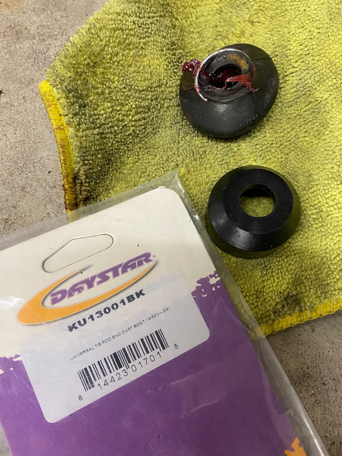

Found these on Amazon. They seem to fit ok, time
will tell.
will tell.
https://www.amazon.com/Daystar-Dust-...78284419&psc=1
Thanks for sending that. Are those a friction or press on fit? No wire or zip tie needed?

Posts: 820
Likes: 230
From: Boston, MA
Yes press on friction fit. It was a fairly tight fit. No mention of zip ties to install but I guess you could use one at the top.

Crossed-posted to this thread for more information. TF255 kits were originally designed with RTC5869 or RTC5870 (Defender type). But they temporarily used the QFS000010 & QFS000010RH (Disco type) during the COVID period.
https://landroverforums.com/forum/di...linkage-78221/
