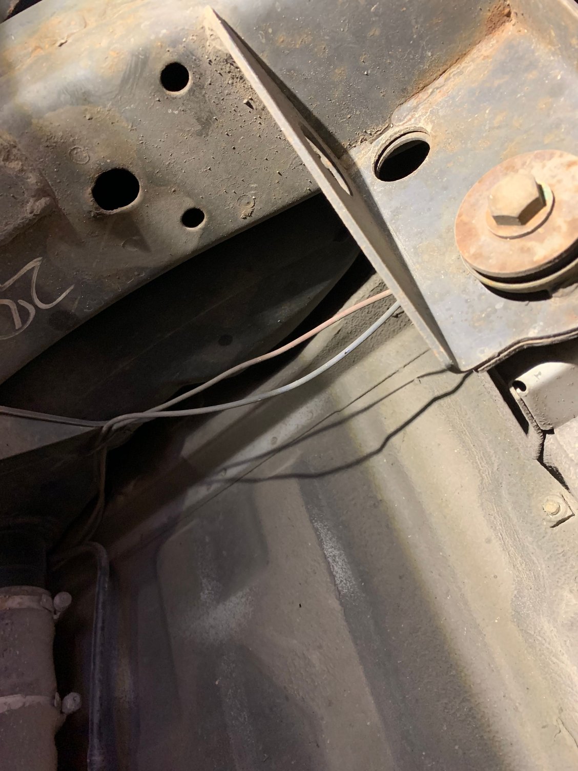

I was changing the reverse light bulbs in Clarkson 04 last night and while I was under there I saw this wire that had been severed from a wiring loom.
I tested it and it’s got power going to it at all times. It looks to me like it feeds into the wiring loom that goes to the trailer plug. I think I probably ought to reconnect it?

Most likely, additional trailer wiring, blue for trailer brakes, red for recharging battery on travel trailer or running interior components, while plugged into TV (Tow Vehicle).

Yup I’ll splice it back in.
The trailer plug, that’s another story, I’d like to get it set up to tow our little trailer some but of course my trailer wire won’t work in this plug.
