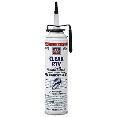

The seal that was ruined on mine was the one that fits against the roof. I cleaned what remained off of the sunroof frame and roof, and then cleaned the surface of the roof that the sunroof fits against. I then laid a healthy bead of clear RTV silicone on the sunroof frame that rests against the roof where the seal used to be, and while it was still tacky, re-installed the sunroof glass and frame, and then the drain tray to pull the assy tight against the roof for a positive seal.

This is the RTV that I used to seal mine up. These Powerbead tubes are great, and way easier to deal with than squeezing a traditional tube for that long of a bead.
