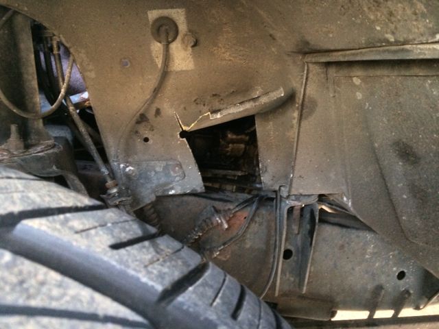

I was driving today, normal operating temps, cold day, about 14 degrees F. I pulled into the left turn lane and stopped. Engine died, got the servic engine light and battery light. Tried to restart and it cranked real well, but never turned over. I'm starting to think its the CPS. I get towed home and put it in the driveway. I am really busy with a lot going on so I can't stop and read the codes right then. I go out two hours later and turn it over. It starts right up. So far the symptoms look like a bad CPS. I still haven't put the code reader on it, but the service engine light is out. I hope Advance has one. It will still be bone chilling cold tomorrow. Does anyone know where to find the picture of the hole cut in the wheel well for access? Any tips from anyone who's done one recently? I don't want to have to take down the y-pipe.

I just spent a couple of hours using the search function trying to find the photograph of the cut in the wheel well to access the CPS and couldn't find it. If anyone knows what thread it is in, please let me know. Thanks.
From https://landroverforums.com/forum/di...e2/#post443936
