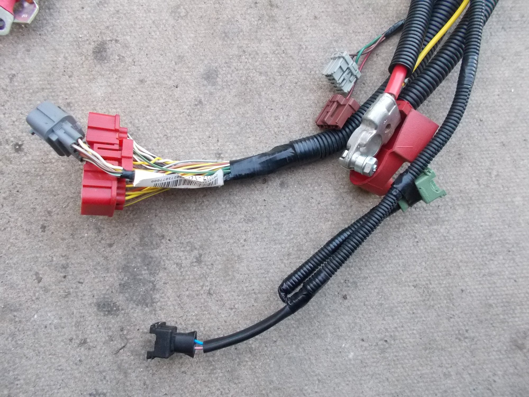

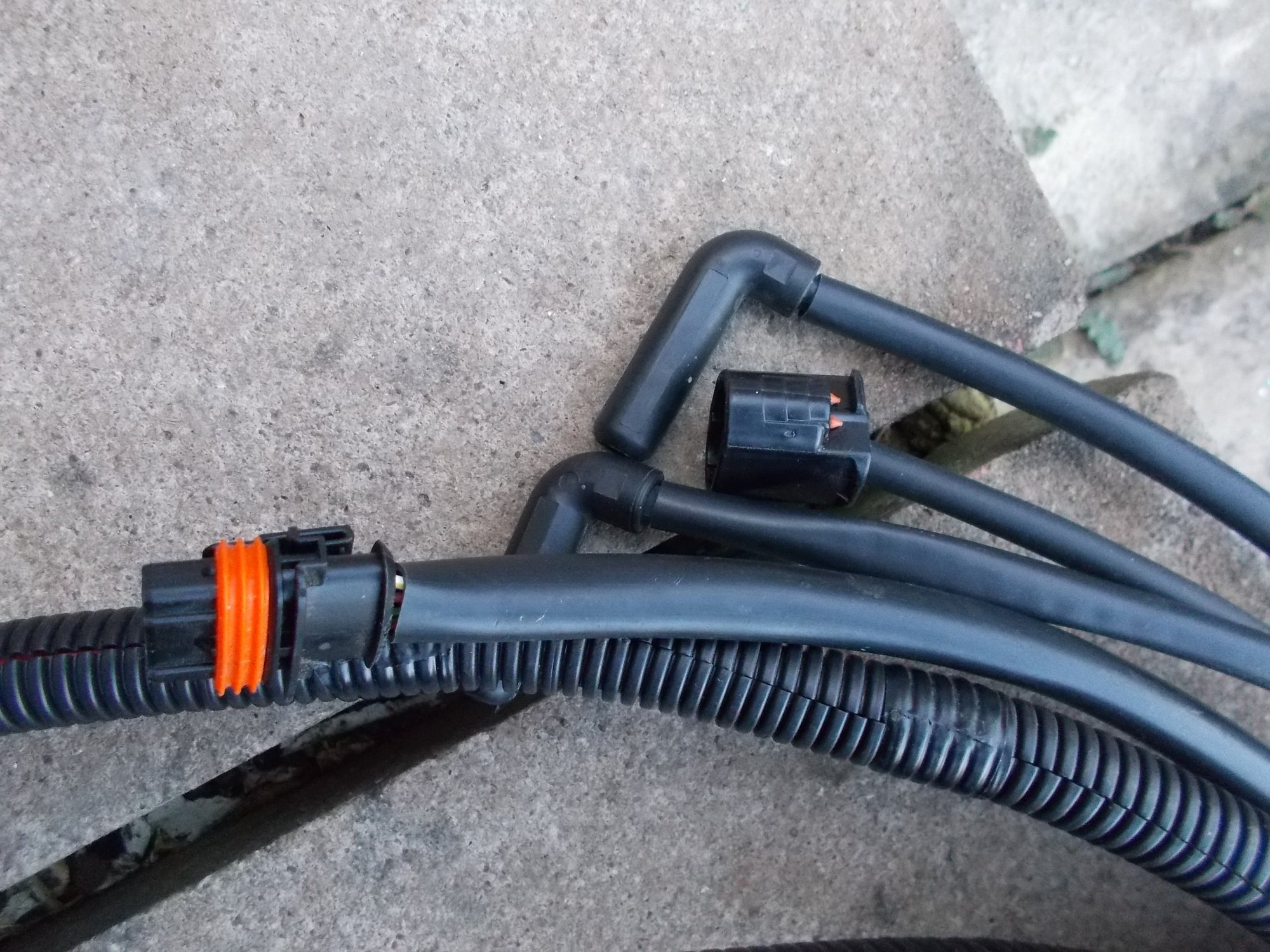

Hi
I've got what I believe is a Disco 2 Td5 engine loom, but I don't know if it's EU spec, Japan, US or what. It was made in 2013, which is odd and the part number on the label gives no results.
Can anyone give any clues from seeing the connectors? I looked in the wiring diagram but I can't quite figure out what should be different between the markets. I don't have a vehicle to compare to.
Thanks!

Not US spec the td5 was never offered here

It's definitely looks like a TD5 loom from the red ECU connector that sits in the engine bay.

1H2Z-12A522-AA is the Engine Wiring Harness for a '98 - '04 Discovery II 2.5 TD5 (Euro).
The 2013 build date is most likely due to the fact this harness is still available from LR and made by LEONI.
Contact LEONI Tech Support to confirm.
