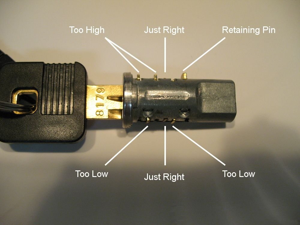

Hi, I am reading this thread thinking it is a godsend as my disco is in this shape right now. I am looking at the last picture in your post where you are removing the little spring. Am I correct in assuming I must either remove the brass piece or grind it down? Ans if so how do I know the offender? Does it stick up? Do I grind the top, or bottom? Thanks. Just trying to get all the details clear before I start.

You want the cylinder to be smooth so that it turns. With the key in the cylinder file the bass wafers so that they are smooth with the cylinder.

Thank you very much Cap-N-Cray, excellent picture, it answers everything. I just have 1 additional question: The wafers on the bottom that are "too low" look to be higher than the one that is "just right"? Am I missing something? If it is as the picture shows, I will simply file the too high ones to look like the just right one minus the retaining pin. Not trying to beat a dead horse, just make sure I get it right. Again many thanks.

The wafers all need to be filed so the cylinder turns in the barrel. File with the best key you have in the cylinder till the cylinder with turns freely in the barrel. With the cylinder in the barrel with the key removed the cylinder should not turn. Lubrication will help as will a brass replacement key that will not saw the wafers out of alignment. The steel key slowly saws away the interior of the wafer which causes the problem in the first place...
