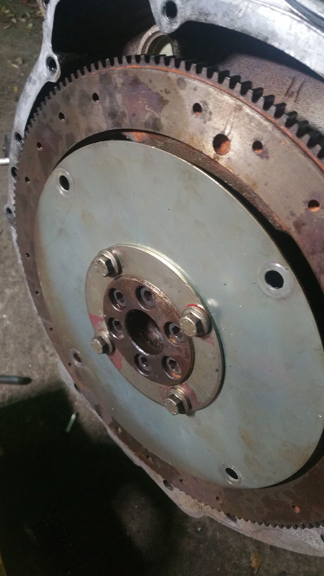

Originally Posted by Charlie_V
No problem, Jamie. I knew you knew the other from other threads. Just describing its location.
I'm actually glad you asked because I found a picture of mine on the old engine.
I have to find the date on that picture. That may be the one that disintegrated. The empty holes are the bolt holes for the torque converter. Putting those bolts in with the engine on (only way I know to do it) is brain surgery through a hole at the back of the oil pan.
So that picture above is the new one, but prior to swap.
Thanks! I always love to learn something new.
