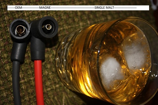

im putting in the new plug wires and the ignition end has a very skinny connector. but it almost looks as if its a clamp around a normal connection i dont want to remove this "clamp" if its meant to be there but they are way different looking than the original OEM ones. (and yes i read the leaflet in the box about them maybe looking different but this is way way different ...

Can you post a picture of the original and the new wire so we have a better idea what you mean?

Default Here they be....
see attachment

What is the part# for the wires you bought, and what year is your truck? The reds are 7MM - won't get much benefit out of them.

Default these are the kv85's
written right on the side !@#$%^& i just read the side of the box the wire size is the right ones they sent the wrong wires though.... thse say 99-04 except series 1 i was explicitly clear about this .... WTF i even double checked with Linda at apex before she placed the order....im not happy since i had to wait two weeks for these

They still sent you the wrong type of wire, regardless of the year. Tell them you need the OEM style wire fr your truck. You need wires that fit "inside" like this cap.
They sent you wires for a "post" cap like this one:
Alternatively, if you haven't replaced your cap recently, you can switch to a post style cap and keep the wires they sent you. It's really just a matter of preference. Personally, I prefer the "post" style caps. They secure wires better.
