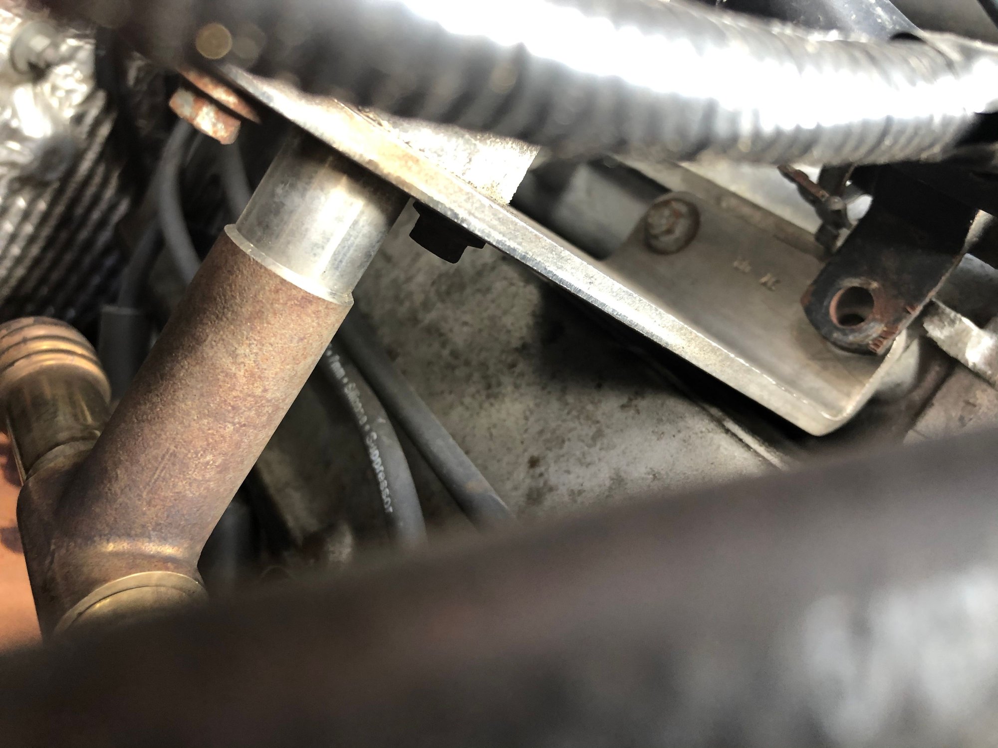

SAI tubes:
Big bolt is 1 1/16
18mm wrench is needed to hold down the pipe so the internal threads that go into the heads don't rotate.
Various degrees of success using a small adjustable wrench that goes to 18mm, a short handle 18mm wrench or a crows foot 18mm wrench.

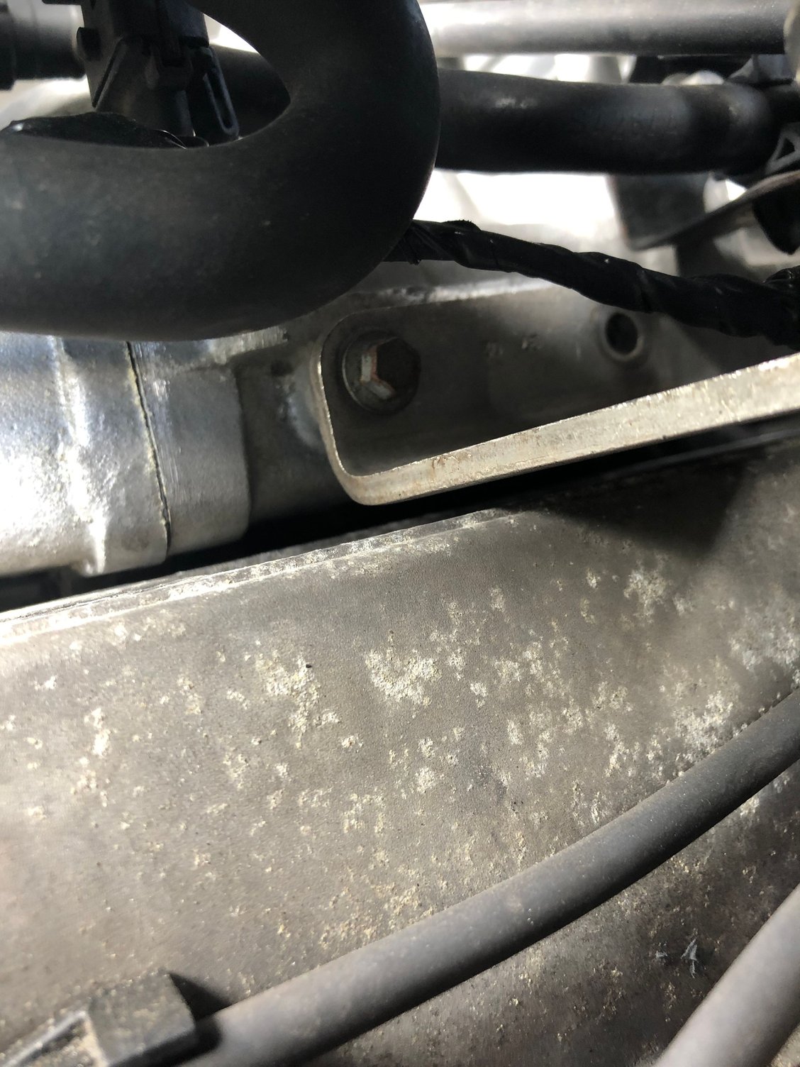

looks like someone was already in there! Missing some bolts...
