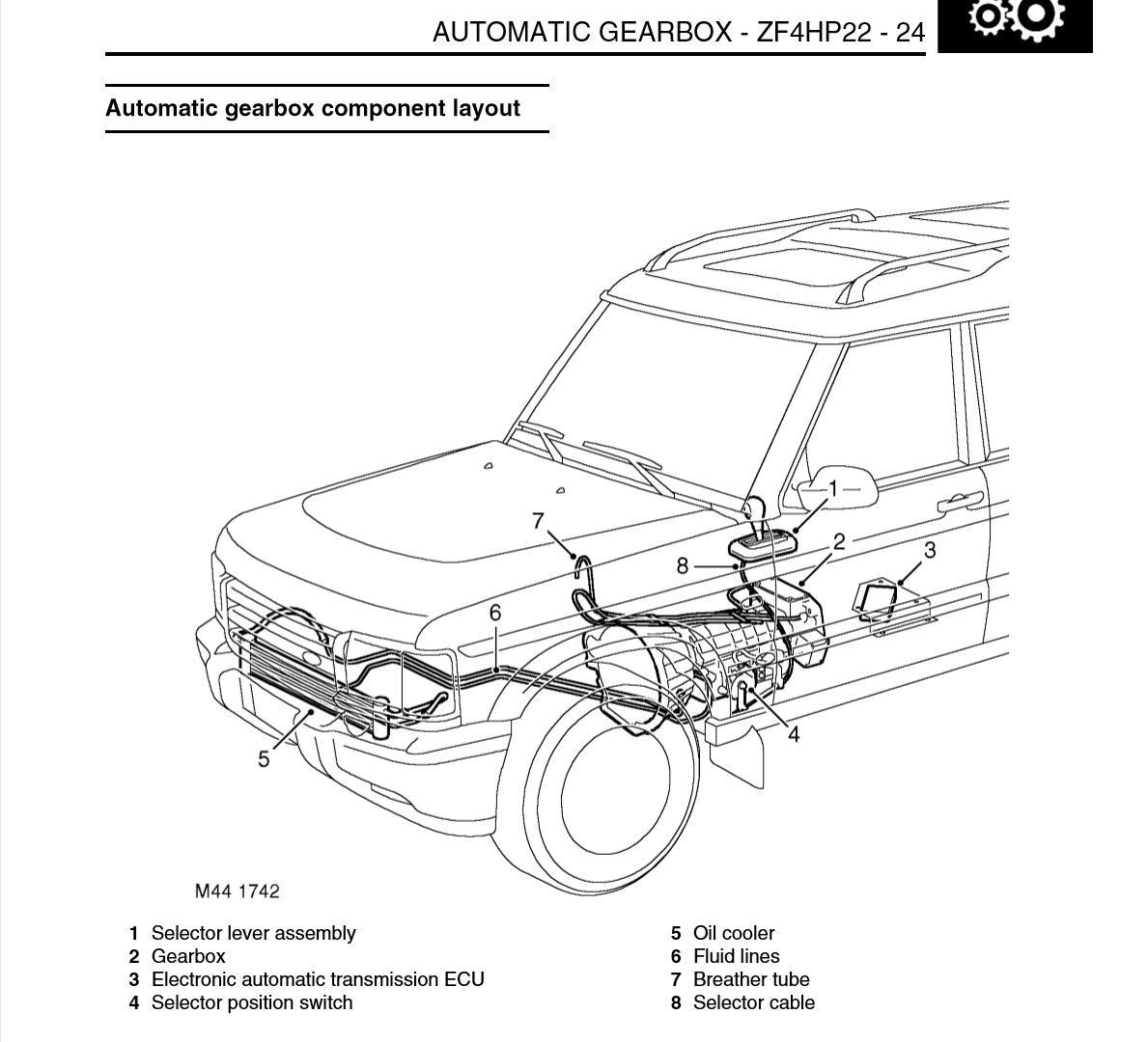

Sounds like a high pressure tranny hose has a leak. The tranny cooler is located below the radiator. Don't drive till you get it fixed otherwise you are driving with little to no oil in the tranny.

i had this happen to me. one of the hose connections came off where it attached to the cooler. it didn't come out in a hissing spray though, since it's not under huge pressure at that point.
transmission fluid usually has a pretty distinctive smell though. it sounds like this might actually be your power steering fluid, coming out of the high-pressure side of that system.
