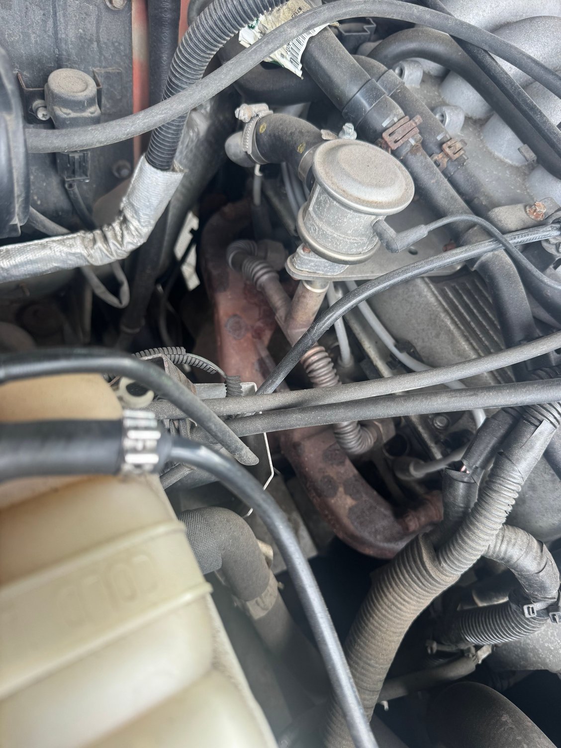

Check wires/hoses/plastic touching exhaust in the engine compartment.
Old May 4, 2026 | 12:23 AM
Aj6543's Avatar
Joined: Sep 2008
Posts: 216
From: Arlington, VA/ Baltimore, MD

Could a bad accessory pulley cause this burning smell or a slipping belt? The accessory belt was squeaking. The car runs and there’s no smoke.
The burning plastic can be smelt on passenger side inside the car and also from the passenger side of the engine bay.
