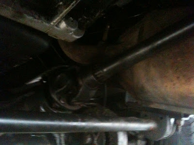

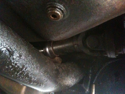

If you want to send me your number, I would be glad to call you and walk you thru this stuff.
In the mean time, go check your front drive shaft, if it only has 1 grease fitting, instead of the 3 it should have, then you need to get it rebuilt ASAP, cause if they fail, you can expect to buy a tranny also.

There are 3 grease fittings. 1 on each U joint and 1 on the drive shaft itself.
I posted the pics here, they are a bit bigger..http://kandkengines.blogspot.com/

You have a DI, so your drive shafts are fine.
