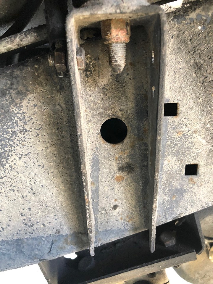

Have/had this problem for a long time. One forum advised that I find the "ignition lock out board" and replace or repair which entailed taking my Rover apart. Then it stopped working all together. I was working on pulling the starter when I noticed that SOMEONE had been in here before me. The starter heat shield was a pain and I could not find a bolt to remove it. It looked like it might have been riveted. Anyway, after I looked at the shop manual I took off the right front tire and found that the ground wire was attached to the frame with a horizontal bolt as shown in the attached picture. I removed the boldt(7/16" wrenches) and wire brushed every mating surface, slapped on some anti-oxidation/dielectric grease and put it back together and LO and BEHOLD she fired up immediately!!! I could hear my sainted Daddy shouting down from Heaven, "I TOLD YOU TO KEEP IT SIMPLE, STUPID!!!" Ah, now for a cold beer or 18... PS My beer is cold because Lucas did NOT make my refrigerator!!!
