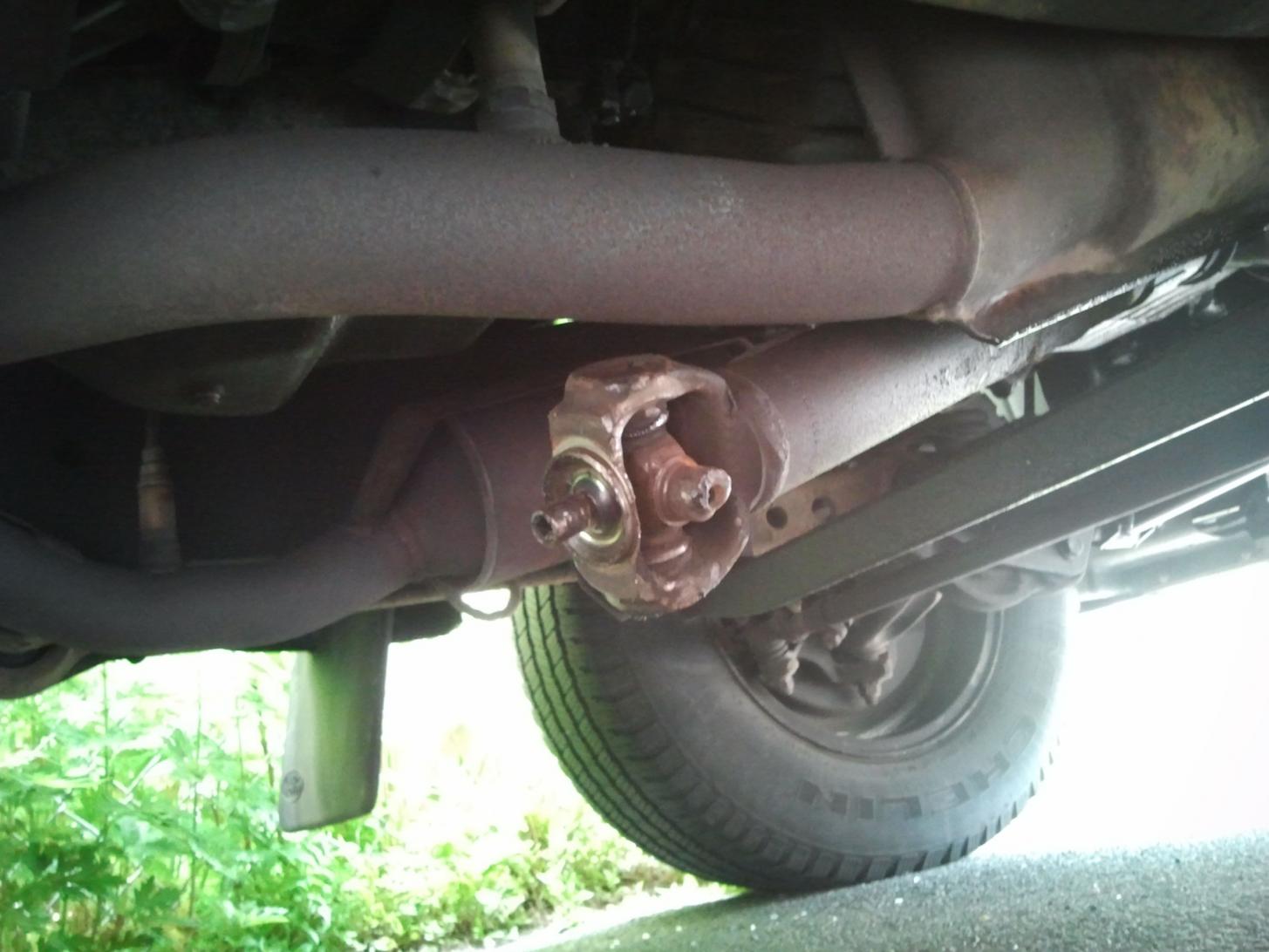

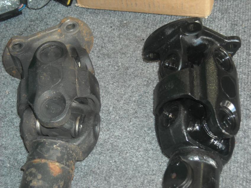

Discovery II has an original front drive shaft that has sealed U joints on the double section. They get the grease cooked out by the CATs and then with very little warning split and proceed to slam against the tranny and in many cases are successful in opening the tranny. Rebuild before this happens article in our tech area, or fit aftermarket shaft. Very serious problem, a tranny at the dealer can be $7000.
That would produce this kind of intermittent type of sound?

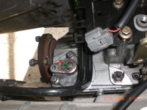

Those who have caught it early (before having their tranny smashed open) have called it a chirp, sqeak, and vibration. It is such a frequent problem that if you scan down our greetings to the new members that have D2s this is usually included as a warning. It is worth looking at. If your truck has locking CDL (not just High/Low) you can remove the shaft and lock the DL, driving on rear wheel drive. Some versions of the D2 are not equipped with locking CDL, but have this spud on the transfer case that can be turned with a 10 mm wrench to lock. That allows you to still drive while shaft is rebuilt. I'll plug in the link to our rebuild article. http://api.viglink.com/api/click?for...13714679763286
Now this is certainly not the only gemlin, but this one has the ability to make your day turn quite grim when it hits.

It's a 2000 and it doesn't have the CDL but it's in my drive way for right now and not going anywhere until I sort this out.
Sorry not a torsion bar but the sway bar rather. I'm definitely paranoid about the front prop shaft letting go so I'll be checking that further (it's oem from what I can tell). It's such a weird sound. Is there anything else that this could possibly be that I should be looking for or is this a "for sure" kind of thing

All 2000 had a CDL t/case, are you sure you don't? Could have been replaced under warranty at which time, they did not put CDL cases back in.
As for the drive shaft, just verify that each of the 3 u-joints has a grease fitting, if not, this is your next project.

I'm sorry yes I do have the CDL transfer case just without the linkage to use it from inside the vehicle which is what I thought you were referring to, sorry for the confusion. I'll be getting up on some ramps later today. Hopefully I can sort this out soon. As an aside, the front drive shaft is at the top of my list of things to do once I get this back on the road.
