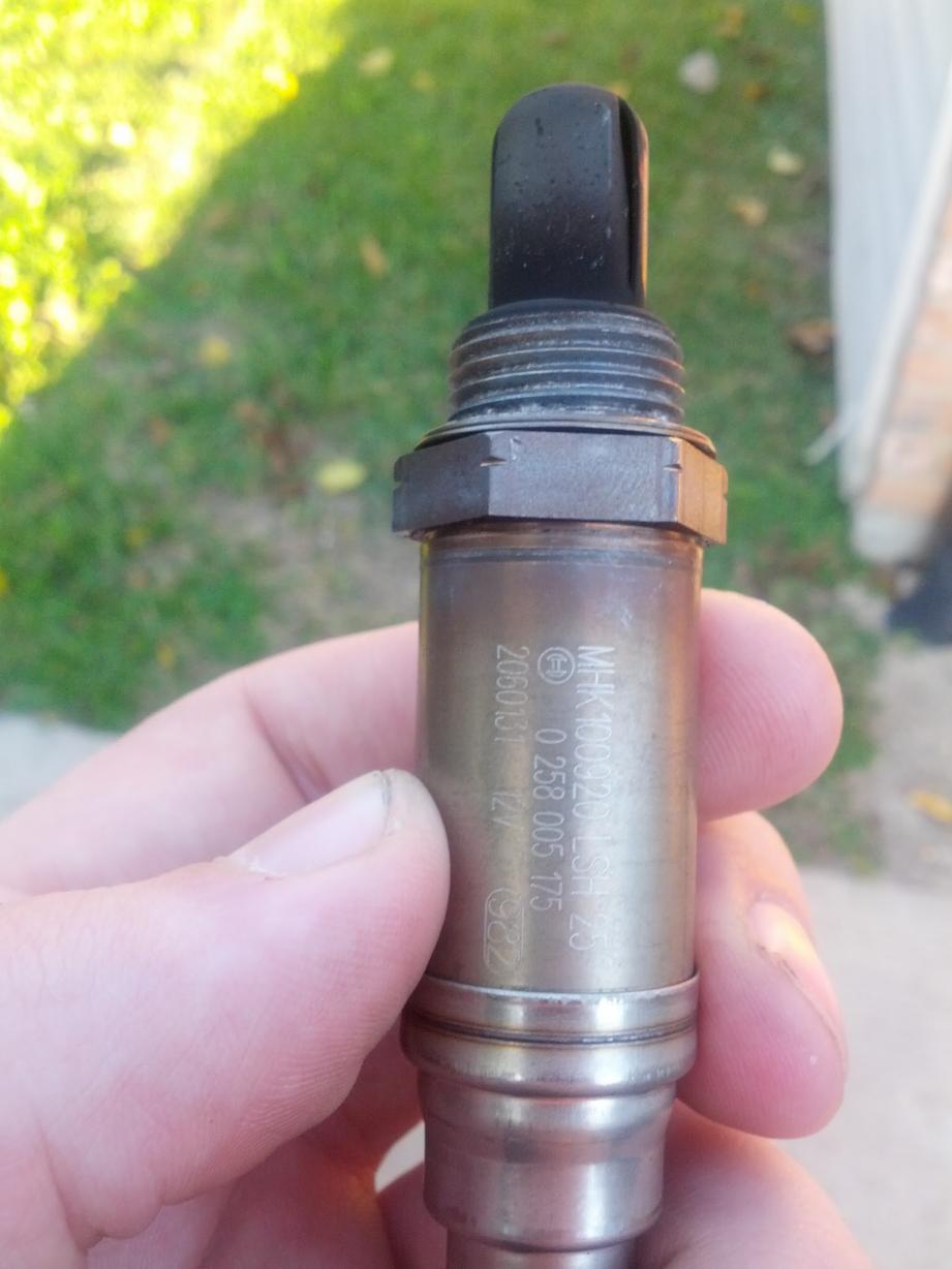

Here is a picture of one of the offending O2 sensors. I took them both out and brought them to Autozone to be warrantied out. They had to get 2 from the warehouse so I'll get the new ones tomorrow.
I unhooked the battery for 30 minutes while I drove down there. I came back, hooked it up and noticed my clock was reset to 1:00 (silly British...)
So basically we'll know tomorrow. I'm going to hook it all up again and see how it does. I'll top the tank off at another gas station for good measure.
EDIT: This is also how the original bad O2 sensor looked. The other original did not have any soot on it.

The old sensor actually does not look that old!
