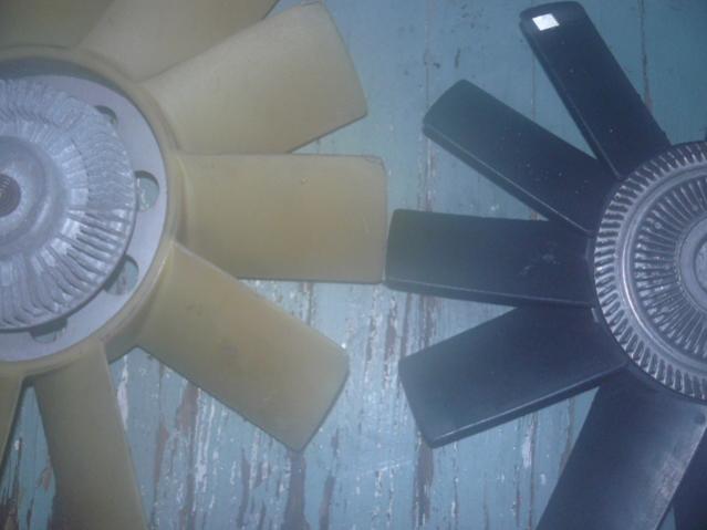

I have tried the stock D1 fan the chevy $50 clutch, a HD clutch, a black nylon fan from a Chevy ( more air) and a white nylon fan from a Blazer (more air due to HD clutch and blade pitch). If concerned about temps should also consider the in-line thermostat mod.
