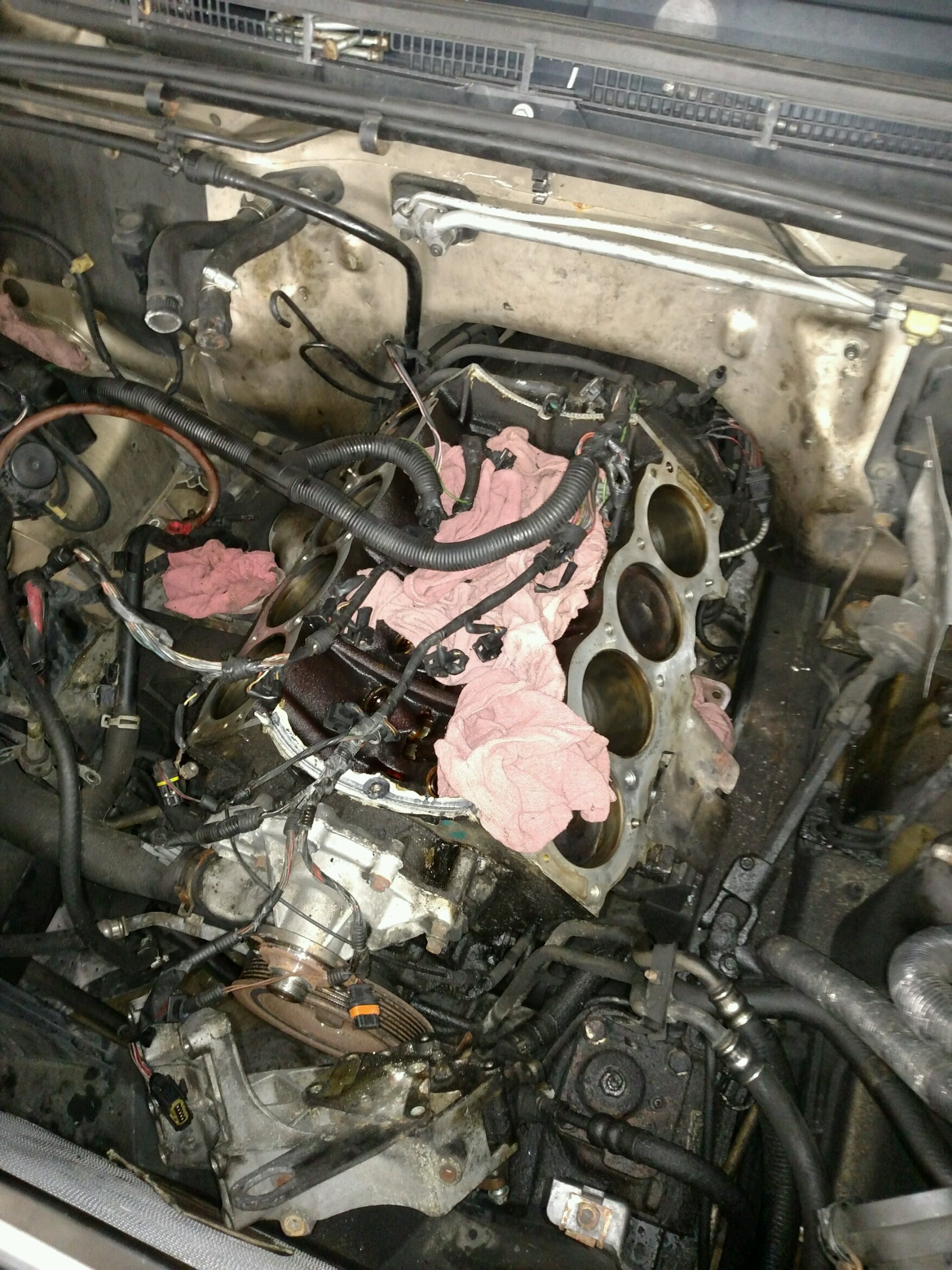

Just got this 2000 discovery II and found a coolant leak on driver side head. I work at a dealer and we started the process! My repair order is up to $1500 so far and the job goes on! I'll post updates and pics if anyone is interested and or tackling a similar job. Obviously been done numerous times before on here. Any help or tips are appreciated! Thanks gang and it's nice to be one of you, despite the $$.

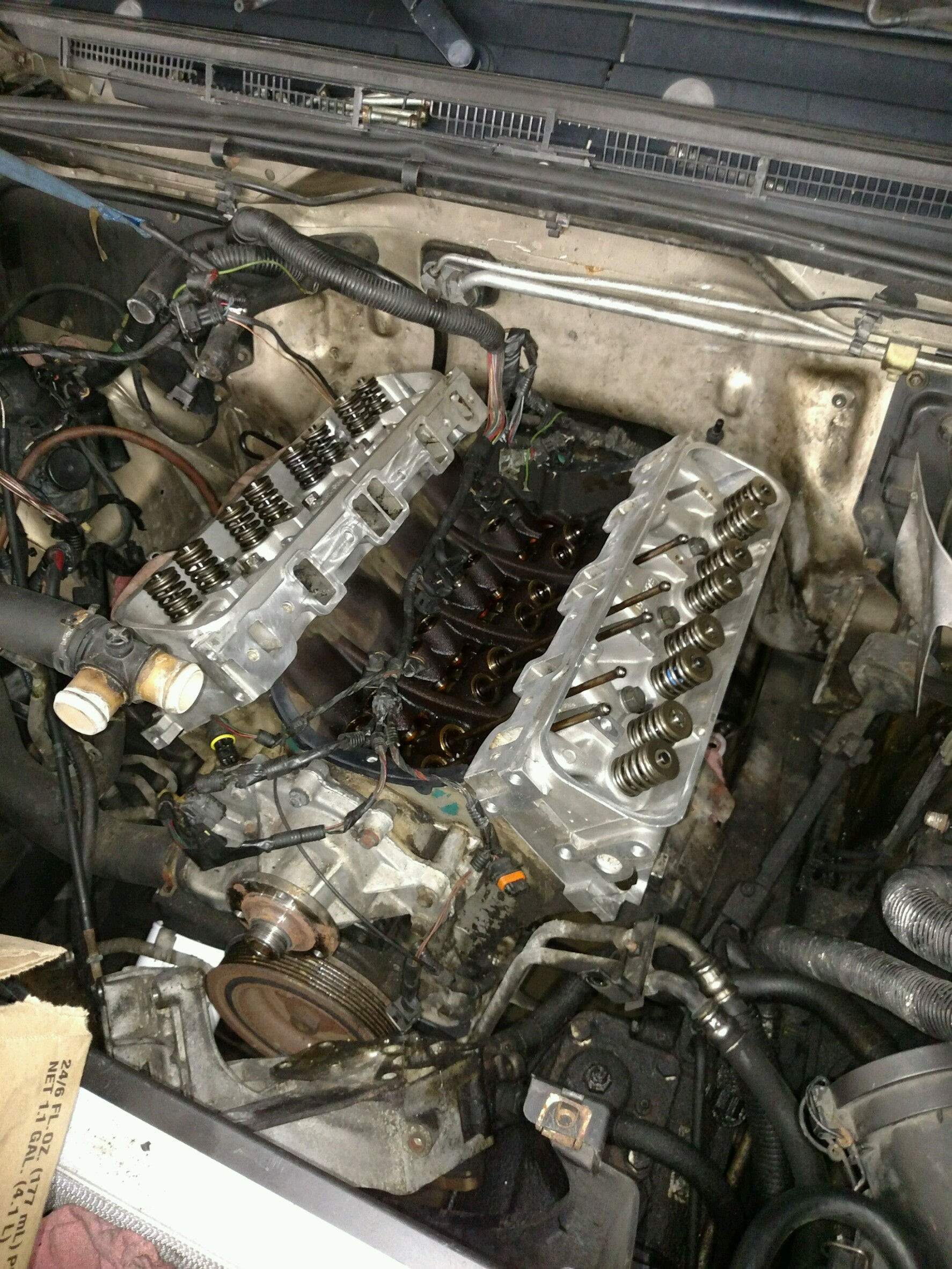

Tomorrow I'll post the cylinder heads after I get them back from the machine shop. One of them had a valve that was not seated apparently and was pushed too far down for correct sleeve positioning? Whatever that means. But not warped so that's good.

Looks good! When I rebuilt my top end there is 1 thing I wish I would have done... Tested the block!! What I thought was just a head gasket leak wasn't. The blocks aren't great on our trucks so I would recommend testing it as well. Otherwise you will end up like me and spend $1000 rebuilding the top end (and a ton of time) and put it all back together to still have the same problem

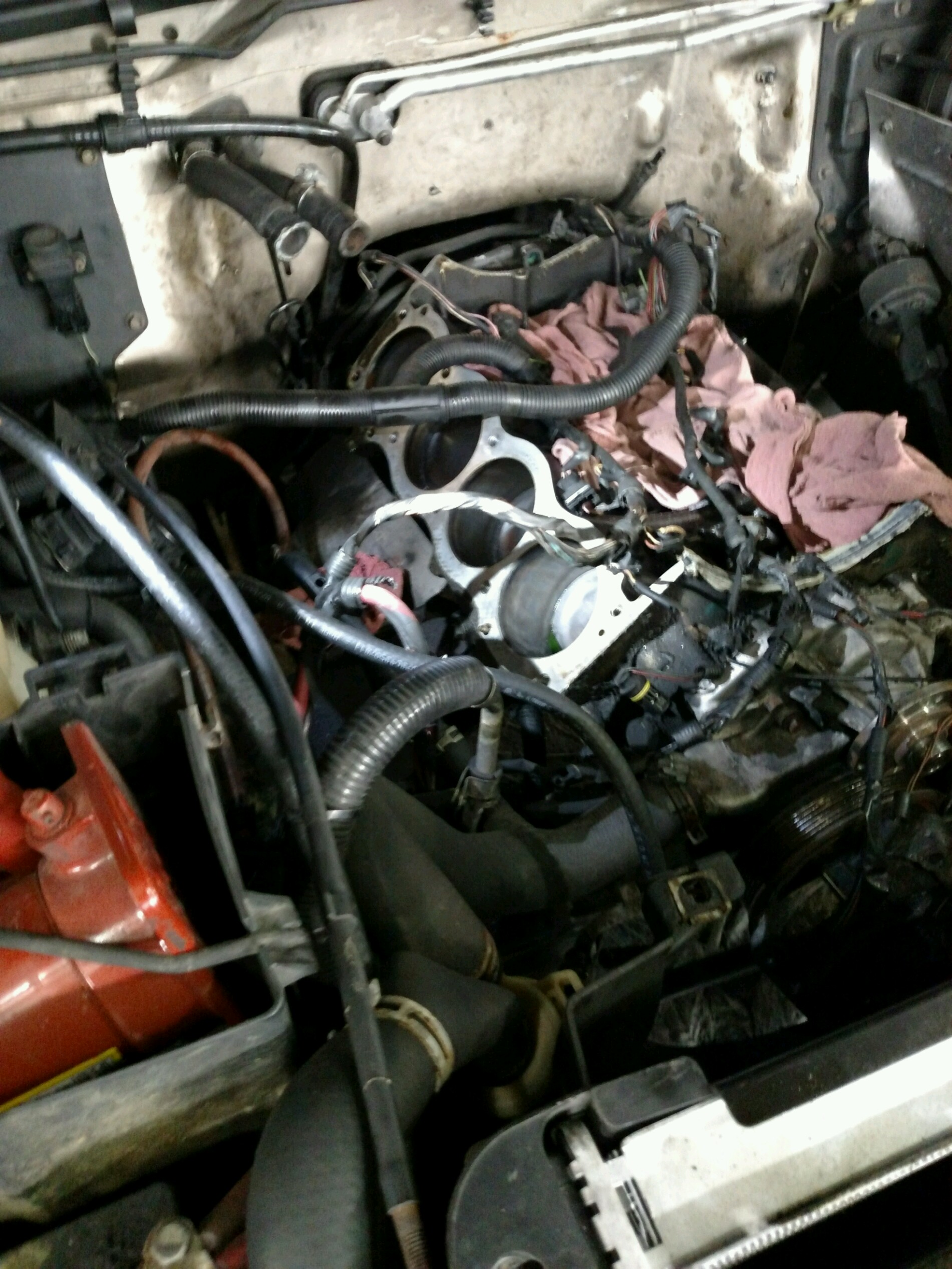

Here is the heads on the block...what a disaster this has been! It's at my Honda dealer so I see it daily but the driver side head has been a nightmare! Machine shop said one of the valves was missing the sleeve and they had to "custom make" something. They had to wait on the part from LR so it added 5 days to the job. So tech starts the assembly today and he breaks 3 head cover bolts and says he needs longer one because they are stripped? Not sure where I'll find those. Maybe one day I can drive this truck, owned 3 weeks, driven 2 days!! Oh and my current bill at work, $25 an hr labor emp rate, sits at $1450 parts and labor! Great...
