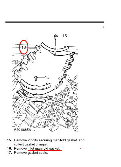

Just so I know Im not dumb ...........the "valley pan" (as you guys call it) IS the intake manifold gasket.......I think you guys confuse yourselves sometimes with the "odd" names you give stuff.

Spike - we cool, I got that when I saw it sorry I didn't mention it, the ones for 04' don't come with bolts though, but yeah I understood.
Urban - thats a great pic (also informative), is it from the Rave manual?

yes thats from the RAVE manual.

BTW, if you need the valley pan gasket, it's about a $10-$12 Felpro gasket.
Yeah, that is an intake gasket. I always called the other one Mike was refering to as the plenum gasket. But seeing how it does cover the valley of the engine, I can see why it and the plenum gaskets get easily confused when refering to them.
