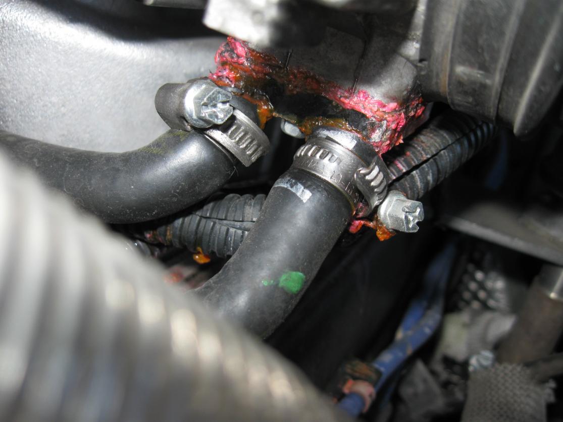

mdzdisco04's Avatar
Joined: Sep 2011
Posts: 29
Default Coolant issuesfor me too
I think I have the same issue with the coolant, it is getting low very slowly. I'm attaching some pics from where I beleive the leak is.
For what I hav e read and looking at the drawings in the RAVE manual I beleiveis the throttle body heater, however I will need confirmation from a more experiencied member in the forum. Also how difficult is to replace this part?
Also if it is the throttle body heater, is that the name of the part I should ask the Land Rover dealer for? does anyone has the part number?
Thank you
Attached Thumbnails Just more coolant issues - sanity check please-img_6408.jpg   Just more coolant issues - sanity check please-img_6403.jpg   Just more coolant issues - sanity check please-img_6395.jpg
Old Feb 12, 2012 | 08:41 PM
Posts: 16,322
From: Savannah Georgia
DIY easy - see Throttle Body Heater Plate Kit | Land Rover And Range Rover Fuel System Parts
