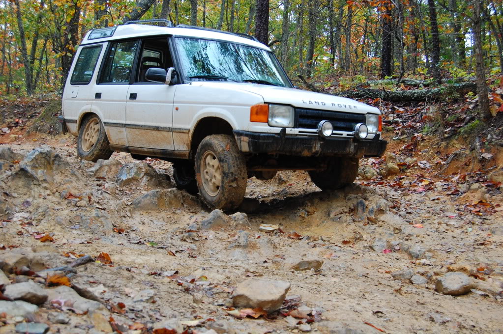

use photobucket to post pics, you load them to their site then just cut and paste the image code in your post here and the pic shows here, and its actually big enough for us to see. example....Name:  DSC_0425.jpg
