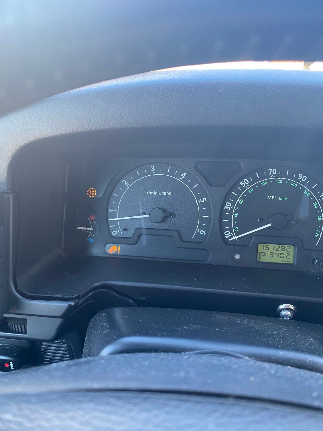

Hey Guys,
Just lifted my disco2 and put on some 18s. Now my TC and hill descent light are now on? Thoughts?

check the obvious stuff first.
get the codes read. you'll need an ABS specific scanner.
make sure all four wheel sensors are properly seated.

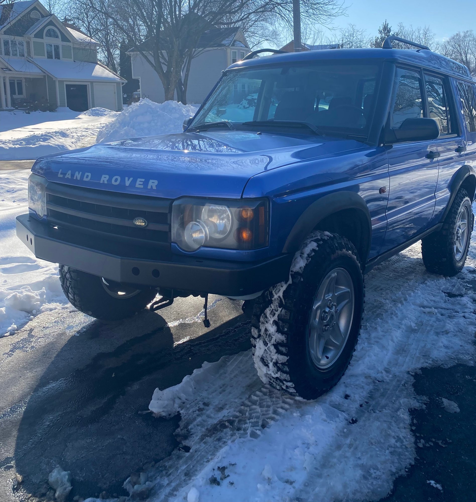

Definitely nice color. BTW, what's the cable by the LF, hanging down in the 1st pic?

Mine has airbags in the rear, and therefore there is level sensor. i.e. the bags know the "proper" ride height and inflate/deflate when you load the vehicle. There are compensating length rods for lifts. I'd start googling how to lift a disco 2.

I put a 2 inch lift on mine recently. I accidentally disconnected the sensor when I installed the spring on the back passenger side wheel and saw the same codes plus ABS when I started it.
