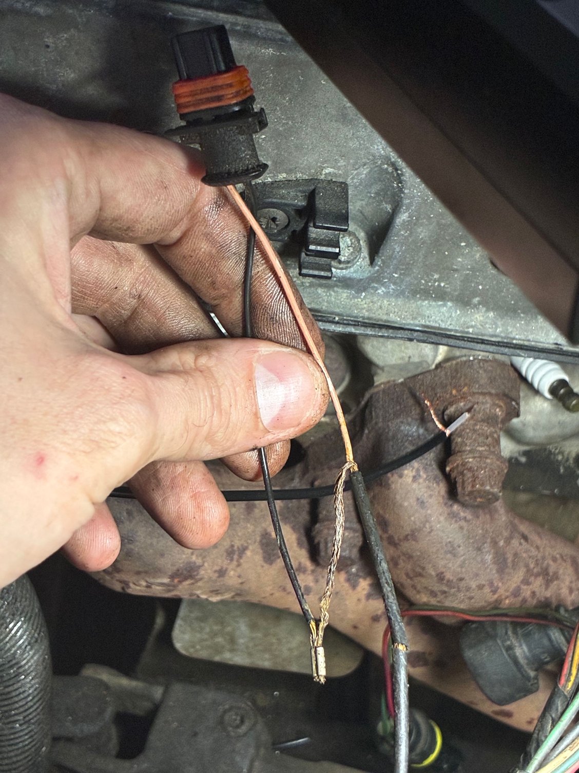

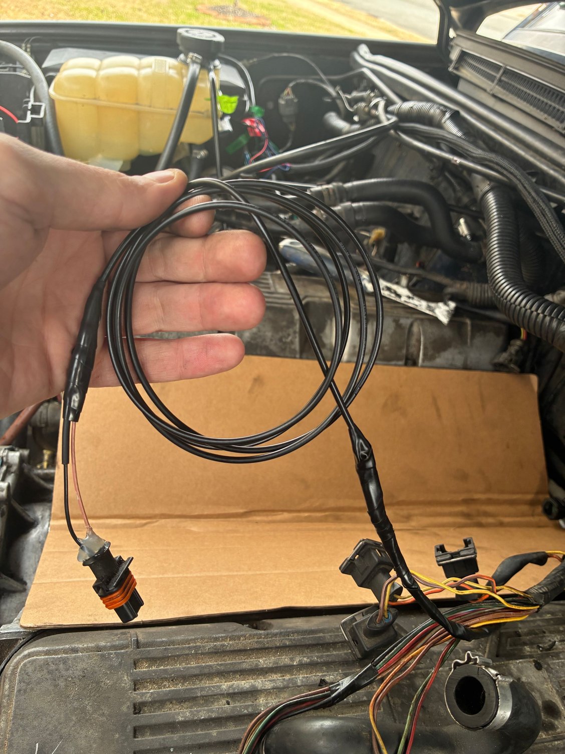

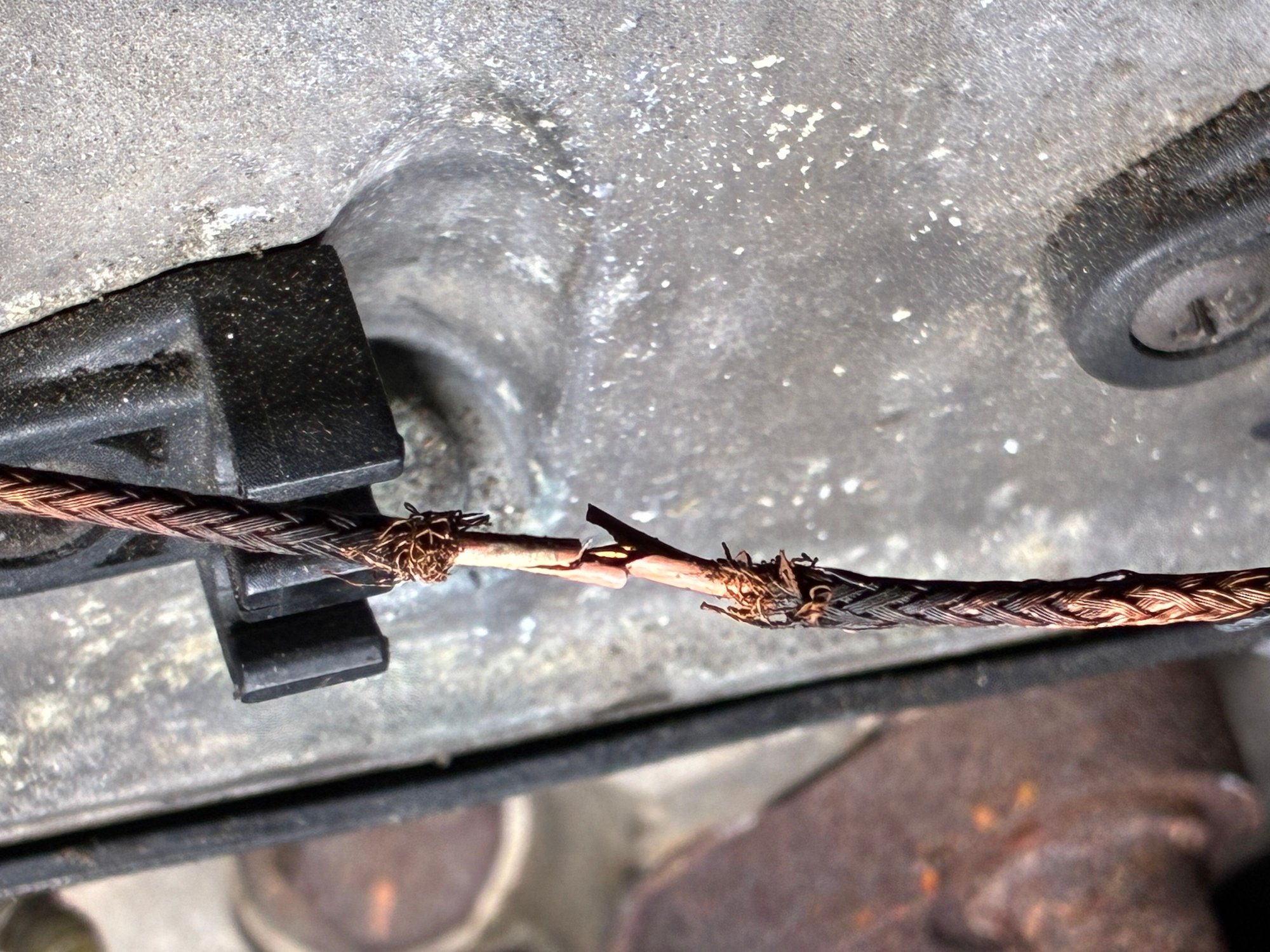

I just had to repair my knock sensor wire. It was brittle and cracking and the shielding was visibly broken in a few places. The damaged parts of the wire down lower, where the wire was hiding behind the pulleys. I already had the pulleys off, which is the only reason i saw the damage. I cut out the bad section and spliced in a RG174 coax wire all the way from the plug up to the fuel injector harness.

Yep.. RG174. It was $9.00 USD for 30ft on Amazon . It's thinner and more malleable than typical coax, closely resembling the original wire.
The sensor has 2 wires - Ground and Signal.. The ground is carried by the shielding , and the signal is the center conductor wire. I soldered the new wire in. The original wire used crimps. I haven't got the engine back together yet to Validate, but i'm certain the new wire will fix it. Afterwards I ohm'd out the wire and checked there were no shorts.
Original
Original
Original
Original
New
New
