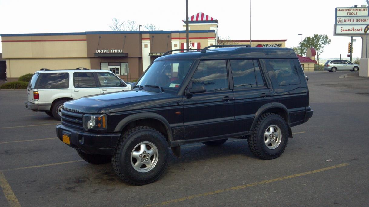

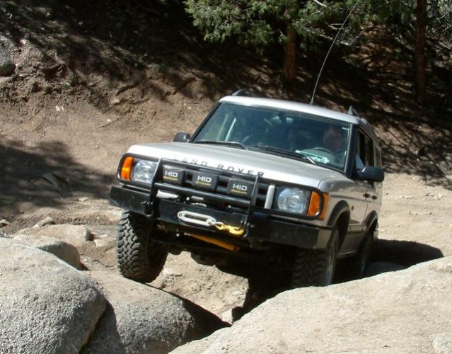

Originally Posted by aarongregor
Pat no I did not change the castors...Grandkodiak would you please post a picture?
You didnt want to see mine
285/75/15 - 2" OME
Attached Thumbnails largest tire-412468_10150711259447449_1206496514_o.jpg   largest tire-283794_10150965707822449_1523515242_n.jpg   largest tire-621612_10151109147309733_1077216306_o.jpg

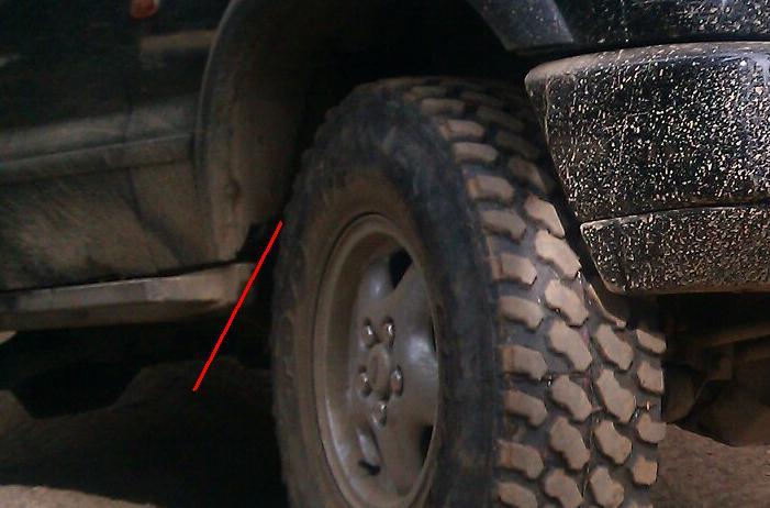

I highlighted the areas with red circles and showed you kinda where the diagonal cut goes on the inner plastic sill (the picture is with my rock sliders on but you should get the idea).
I will post some more pictures come Tuesday (headed to the mtns here soon, snow is on the way )
The plastic sills are still on the side of the house so i will snap a close up of that and where the bumper was cut...i was really amazed that it didnt require more and it technically might not require any.
When i went to pick it up from the tire shop i brought along my hack saw because i thought i would rip something off...didnt touch at all. Came close with the tires turned so i cut as little as possible in the parking lot at the tire place just to get home...took it wheeling that weekend and never needed to adjust my cuts so i would be surprised its fine without the cutting....i was just worried about a tire turned the right way and a hard flex... no issues
I do rub on the passenger rear wheel well, only with the back packed full of camping gear, with someone sitting in the back on that side, and wheeling with one of the front tires off the ground....so it doesnt happen much....plan on extending my rear bump stop
Close ups to follow in a few days...

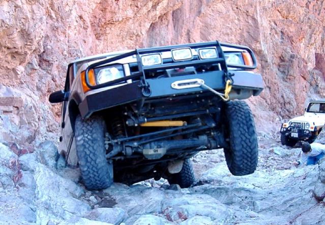

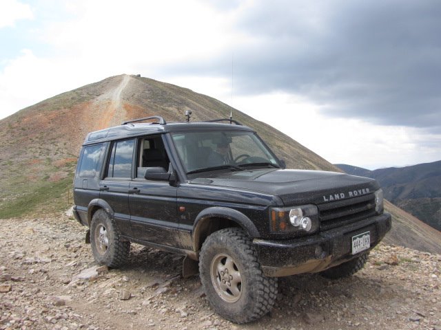

Here are a couple pictures of my 99 with something close to a 3" lift running 265's.
