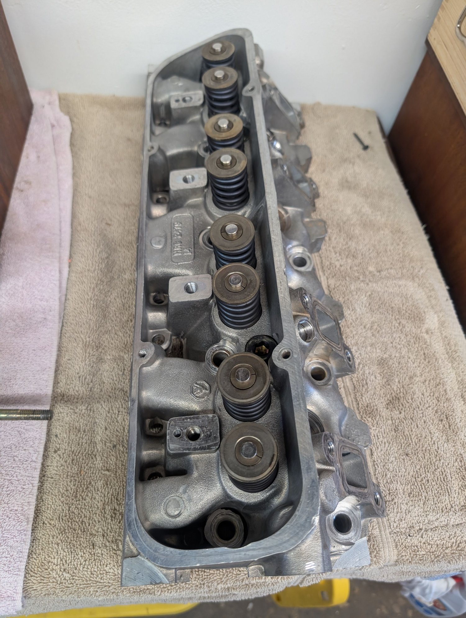

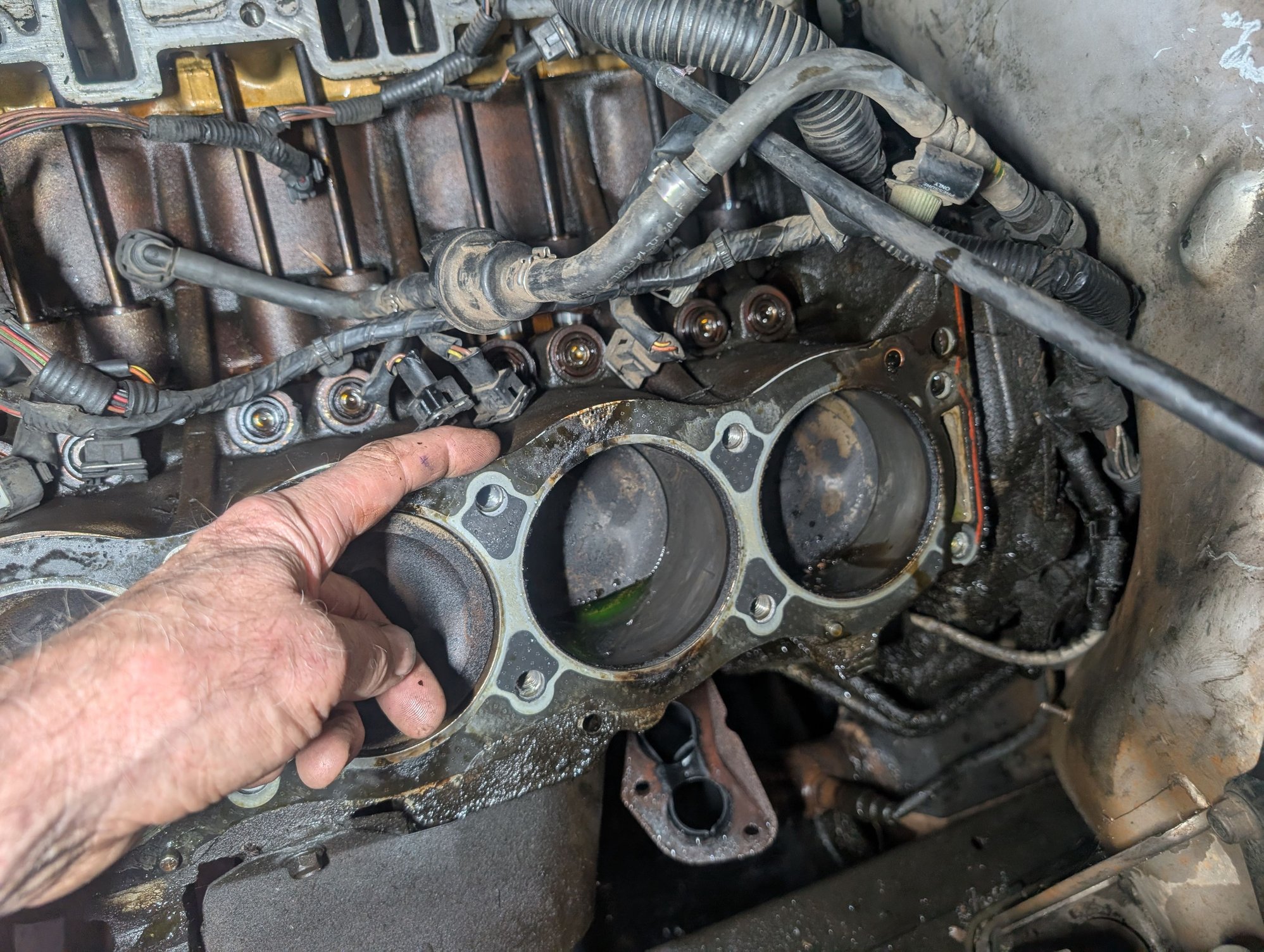

Progress and good news
#3 had a blown gasket leaking towards the intake manifold. #5 was going bad too. Bores in great shape. Liners good with zero scoring. I'm going to have the heads hot tanked and I'll check valves seats. Thanks for all the tips. Coolant in bore is just residual from head removal.

Old Oct 20, 2025 | 06:46 PM
JohnZo's Avatar
Joined: Apr 2021
Posts: 1,416
Likes: 397
From: SE Washington State
I would be suspicious of previous engine work that did not plane the heads. Head gasket might not be original. Bank 2 head looks cleaner than the valley, so maybe was worked on prior. I would pull the other head and check flatness as well, while in there, if you have time now and budget. If one head gets planed, the other should as well, to keep geometry and compression ratios equal. Probably will need to install shims under rocker supports if you do plane the heads.

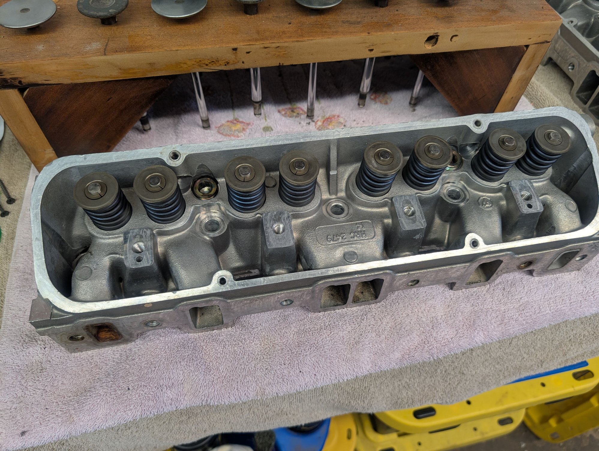

Old Oct 21, 2025 | 10:45 AM
slvrdisco01's Avatar
Joined: Aug 2009
Posts: 95
I did remove the other head and it looks much better. I am having them cleaned and surfaces decked. That link was interesting. Looked very similar to my blow out. I will check the cats and injectors too. Possibly just replace those. When I owned this vehicle I did have the HG changed around 15 years ago. Until now it drove fine. Not sure weather they had the surfaces decked.
Idler pulley will also be changed out and of course all gaskets and o rings. Would you guys recommend the ARP stud conversion?
Thanks again for your help. Much appreciated.
Cheers John.

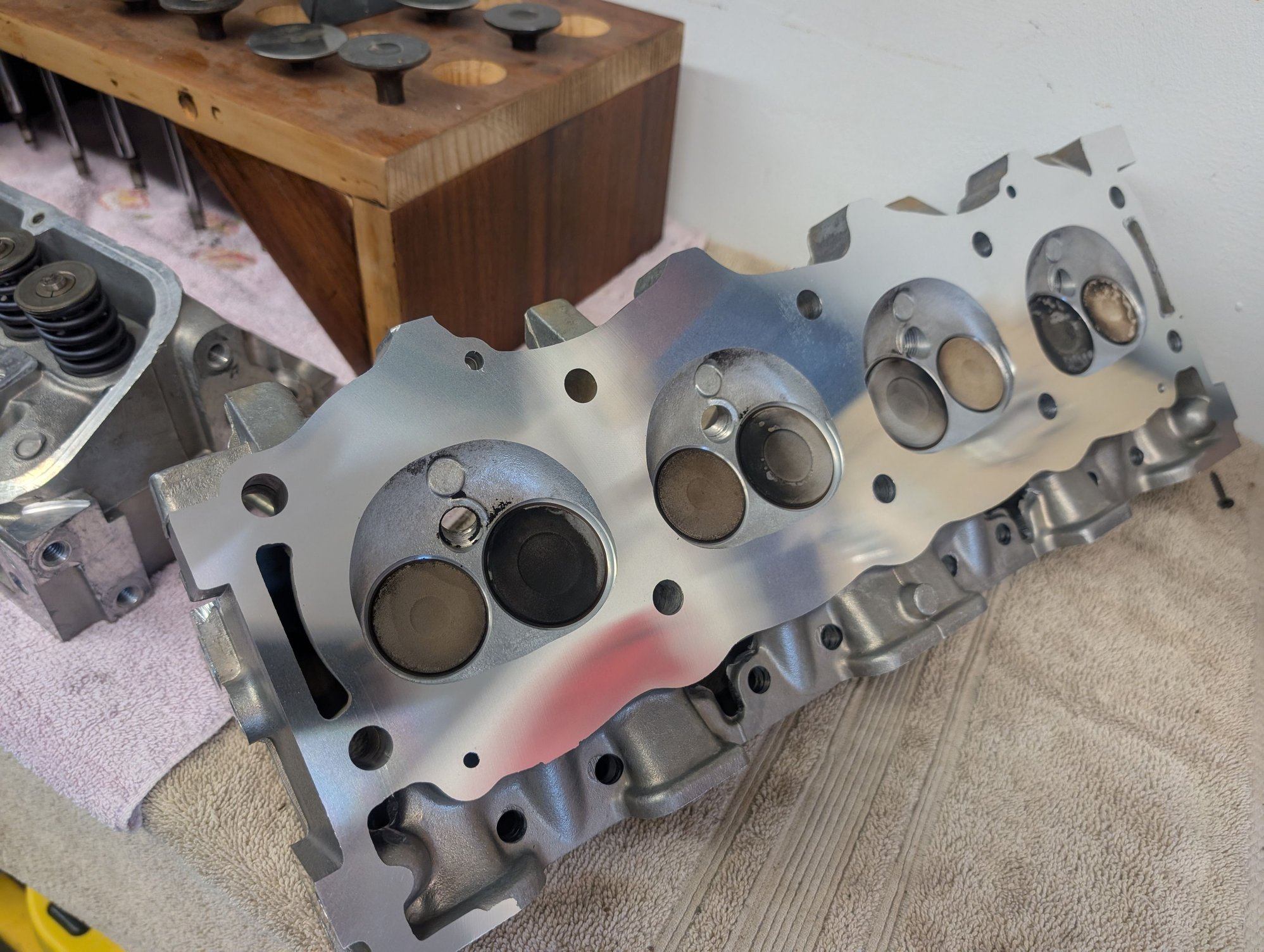

Old Oct 21, 2025 | 07:14 PM
Joined: Aug 2009
Posts: 95
Heads back. They were slightly out. Low in the center. Took 0.005 to clean up. Cleaning and surfacing. $230. I thought that was very reasonable.
