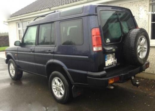

Fair's fair, the Discovery's tyres are in good nick but only two of them match, and there's visible play in the torsion bar bushes both front and back. The rear shocks are OME. But I don't know enough about the car (or OME) to tell whether it's been lifted. Are all OME shocks longer, do their presence automatically point to a lift? The car leans to the nearside a little at the front. The old RR's had unequal front springs from the factory which were usually replaced with equal length ones, are DII's the same? Also the rear of the car is higher than the front. (springs all round)

I'm going to try upload a pic so you can see how she sits.
On a side note, my fuel tank is steel and has an extra section (also steel) on the offside of the car, joined to the main tank by a small hose that bridges the underside of the chassis. I thought all Discovery 2 tanks were plastic. Is this some sort of factory option or phased out feature? The car is from 2001.

EDIT: Dope! I should have put two and two together, but I've just realised the tank is an aftermarket long range thing with auxiliary. And it's seemingly 50kg dry so the norm is to fit heavy duty springs. So the two questions turn out to be related.
