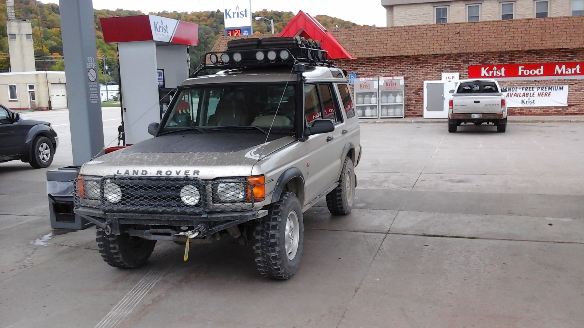

Went with a 2" TF lift, medium duty. After loading it down for bear, my thoughts of getting HD for rear were confirmed. You can see it squatted pretty good in this picture. But, this was a week long trip with my wife, so the amount of gear was a bit more than normal.
