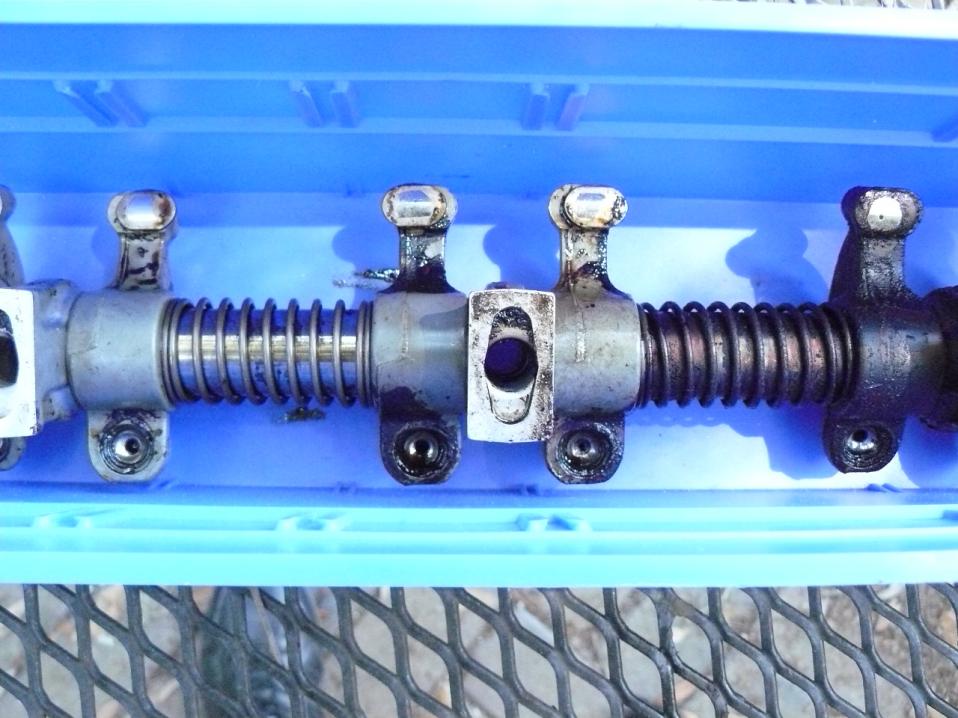

Is it the lifter, or something else under the valve cover?
Listening with a stick between your ear and valve covers may isolate the noise.
The rocker arms can become deep fried, you could also have a piece missing from the rocker arm and noise won't shut up. Going under the cover requires new VC gaskets, old ones will be brittle. If you get into replacing actual lifters and cam (as a set) that is more involved.
This rocker arm has half of it dipped in a cleaner called Berrymans.
You could also try the BG oil treatment, it has a solvent cleaner added to oil, then drained; and a supplement added to the new oil. Now I tried the BG and it made a difference in noise on SWMBO van. But my Rover in photos needed more help than BG, ATF, Marvel Mystery Oil, SeaFoam, and a few snake oils I don't remember could muster. Imagine pouring oil in an aluminum pan. Cook on the stove hours each day. Don't change the oil. Just top off when needed like a lot of previous owners.
