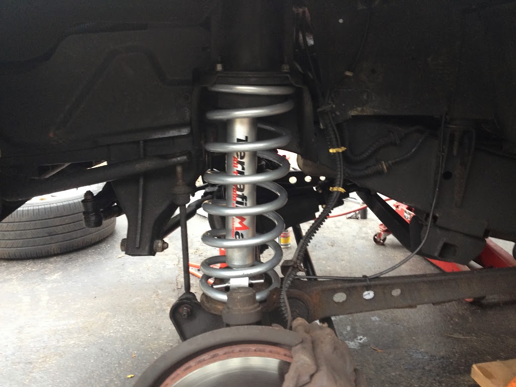

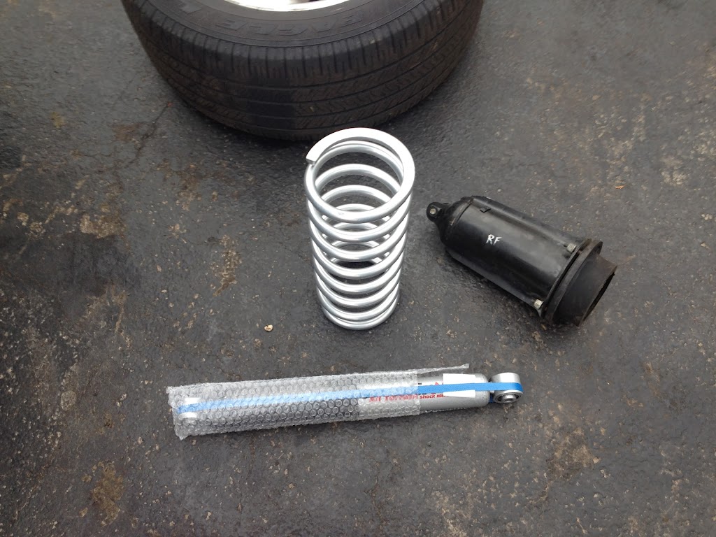

Front - this procedure is covered in many places. What worked for me:
Disconnected the front swaybar on both sides. Only one side needed to get the axle to drop, but you have better clearance to install the spring with the link set aside.
Removed the shock towers (replaced with some much better condition ones) and installed the shock in the tower, the spring on the truck and then dropped the tower and shock back into the vehicle. This required installing the lower spring perch bolts and then removing them once the spring was seated to bolt down the lower shock - easy.
Driver's side spring went in fine using the factory bottle jack to move the axle down to get enough clearance.
Passenger side spring did not install without using a pair of spring compressors to reduce the spring length. A better solution would have been to remove the front driveshaft from the differential housing, but I found the bolts on my driveshaft to be _very_ tight and I did not want to deal with that on jackstands.
Brake line and ABS sensor length was a non-issue, stock was fine.

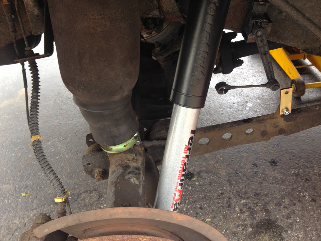

You need to deflate the airbags. I choose to do this from the compressor side, by slightly loosening the air line connections on the distribution block. One turn was enough to slowly deflate the bags. Loosen the two outer hoses, the center hose is for the pressure reservoir. Others disconnect at the top of the airbag, but that requires some small wrench work in a very dirty place (not great for air fittings).
I found the bolts provided to mount the TerraFirma spacers (allen oval head screws) were too small to fit into the factory axle SLS support holes, so I tapped the holes (8x1.5mm) and installed the screws into the holes, using the provided locking nuts as a backup on the exposed threads under the support.
I had one height sensor where the metal sleeve in the lower sensor arm turned to “dust” and I had to replace with a hastily fabricated plastic part (made from the body of a thin dry erase marker and some time on the drill press). The sensor extension bolts provided are a bit short, they only just engage into the locking nuts – so you (like me) might want to get some longer (M6) bolts there.
Brake line length IS an issue during the install - don't drop the axle too far! It is easy to put tension on these.
