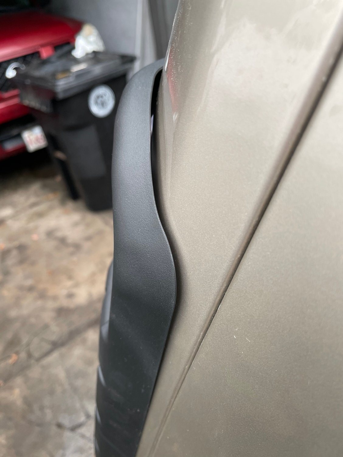

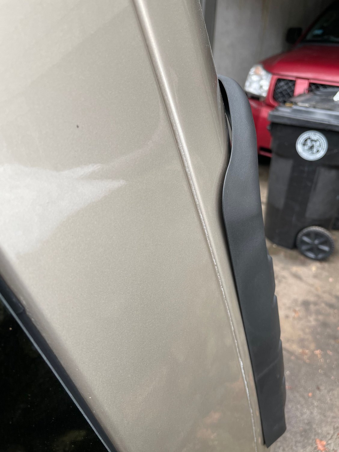

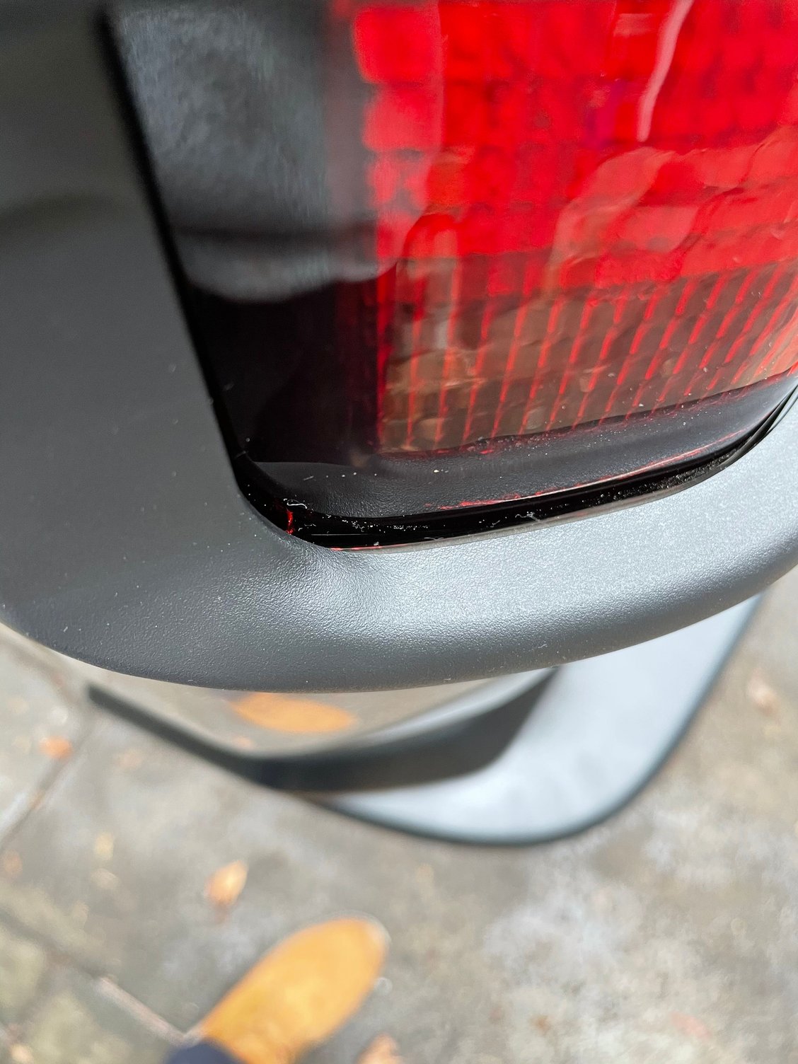

Anyone know if there are specific plastic guards for the 2003 and 2004 tail lights. I recently got a set and it seems like they are meant for the earlier taillights with the groves in them. This is what the ones I got look like installed I feel they should fit better. Thanks.

Are the ones you bought OEM or after-market? What are the part numbers?
The '03-'04 are different than the '99-'02. Here are the part numbers I have for the '03-'04 model:
STC53193 FRONT LIGHT GUARDS
STC53194 REAR LAMP GUARDS

That gap you are seeing is known as British Land Rover tolerance
Similar to valve covers and transfer case covers

Checked mine--same gap on '04. You're good ;-)
